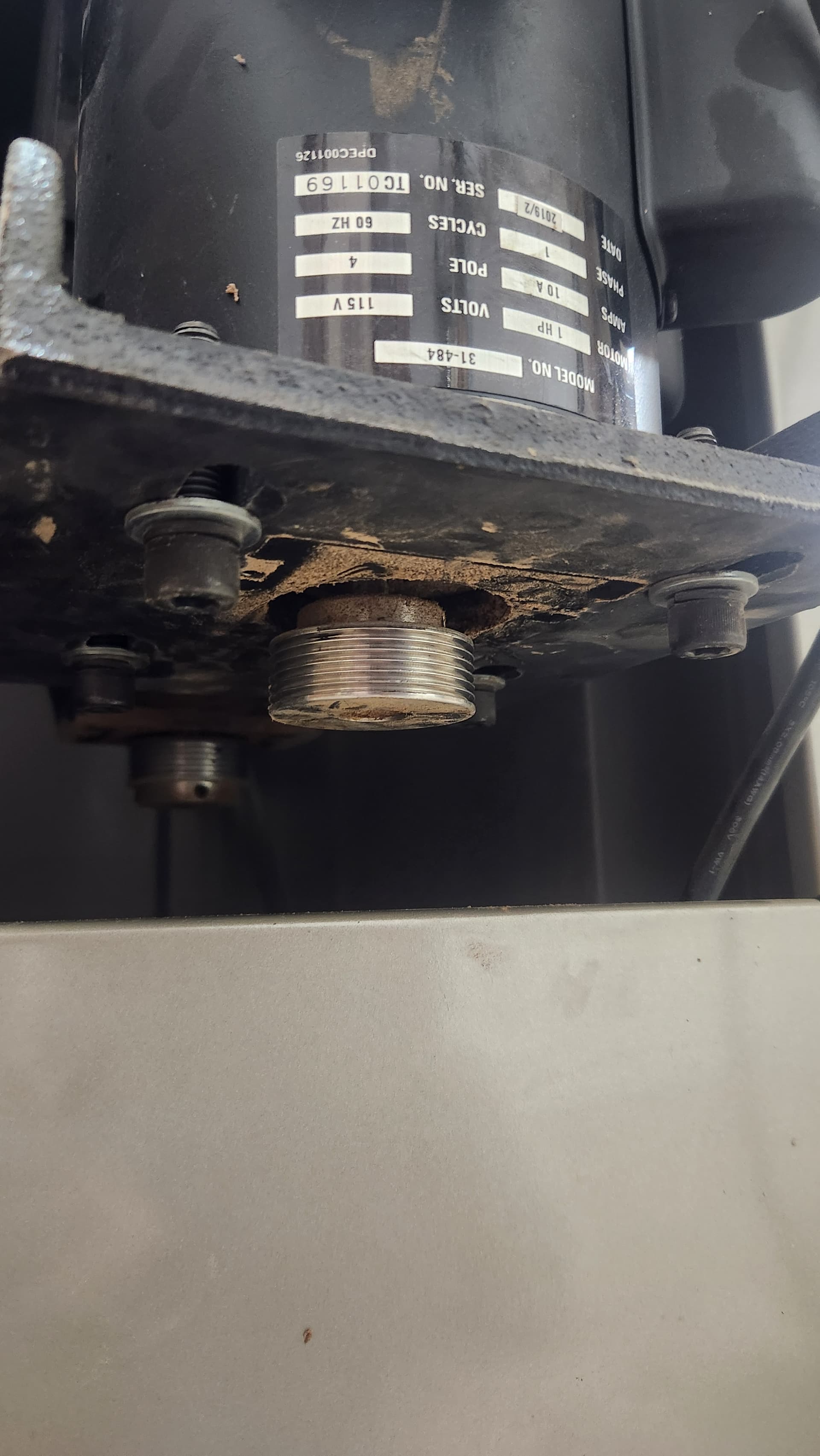

Small update. I removed the drive belt cover and drive belt to decouple the sanding bits from the motor bits. The motor spins freely and functions normally when plugged in. the problem is certainly in the sanding part of the machine. I agree that the top probably has to come off.
