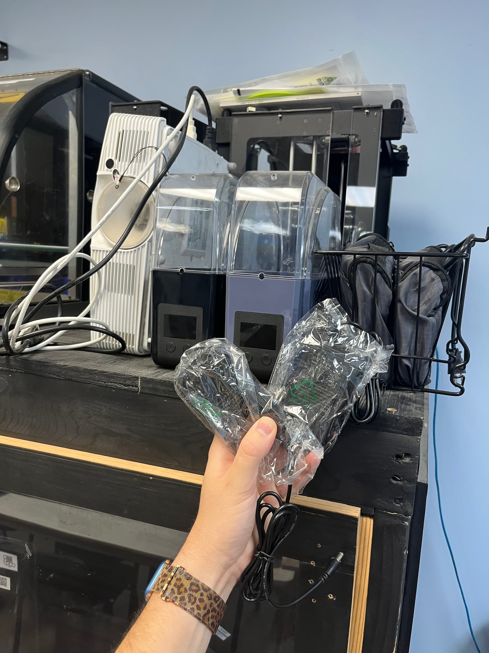

Two filament driers above resin printers?
Whose SunLu filament driers are these and may I use one or both for a print this weekend? Thanks!
Go for it! SunLu FilaDryer S1 - Asmbly Wiki
I believe the second one is owned by Nick. There is also a 2-spool dryer connected to Zephyrus.
Asmbly owns three of those FilaDryers, one white, one gray, and one black. Feel free to use them any time and move them around as needed. The Sovol one by Zephyrus has a more powerful heater, but should stay near Zephyrus.
thanks guys. @JoeN let me borrow his new SunLu today so I replaced yours in the spot above resin-land, @flowmage helluva name btw.
