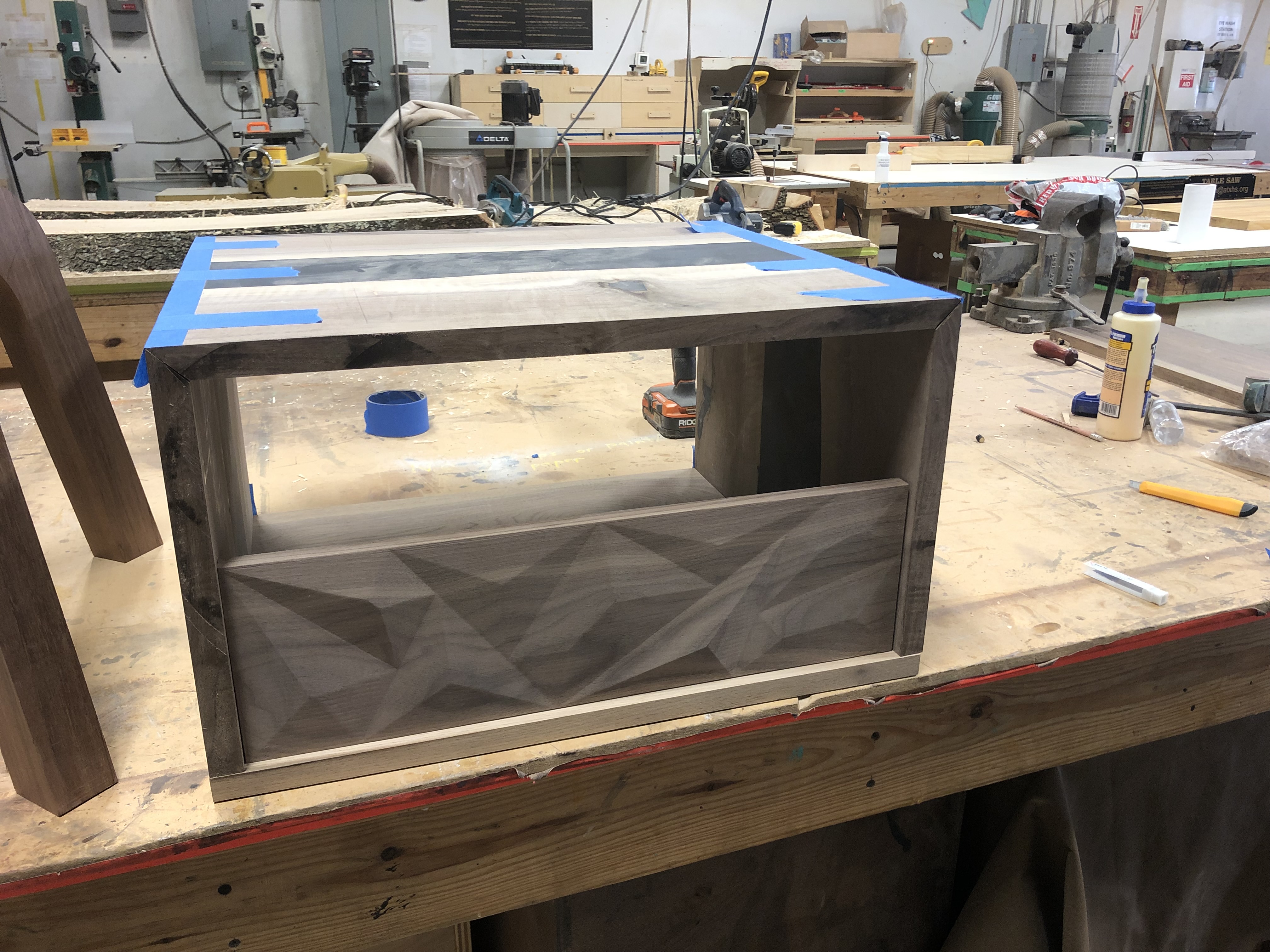

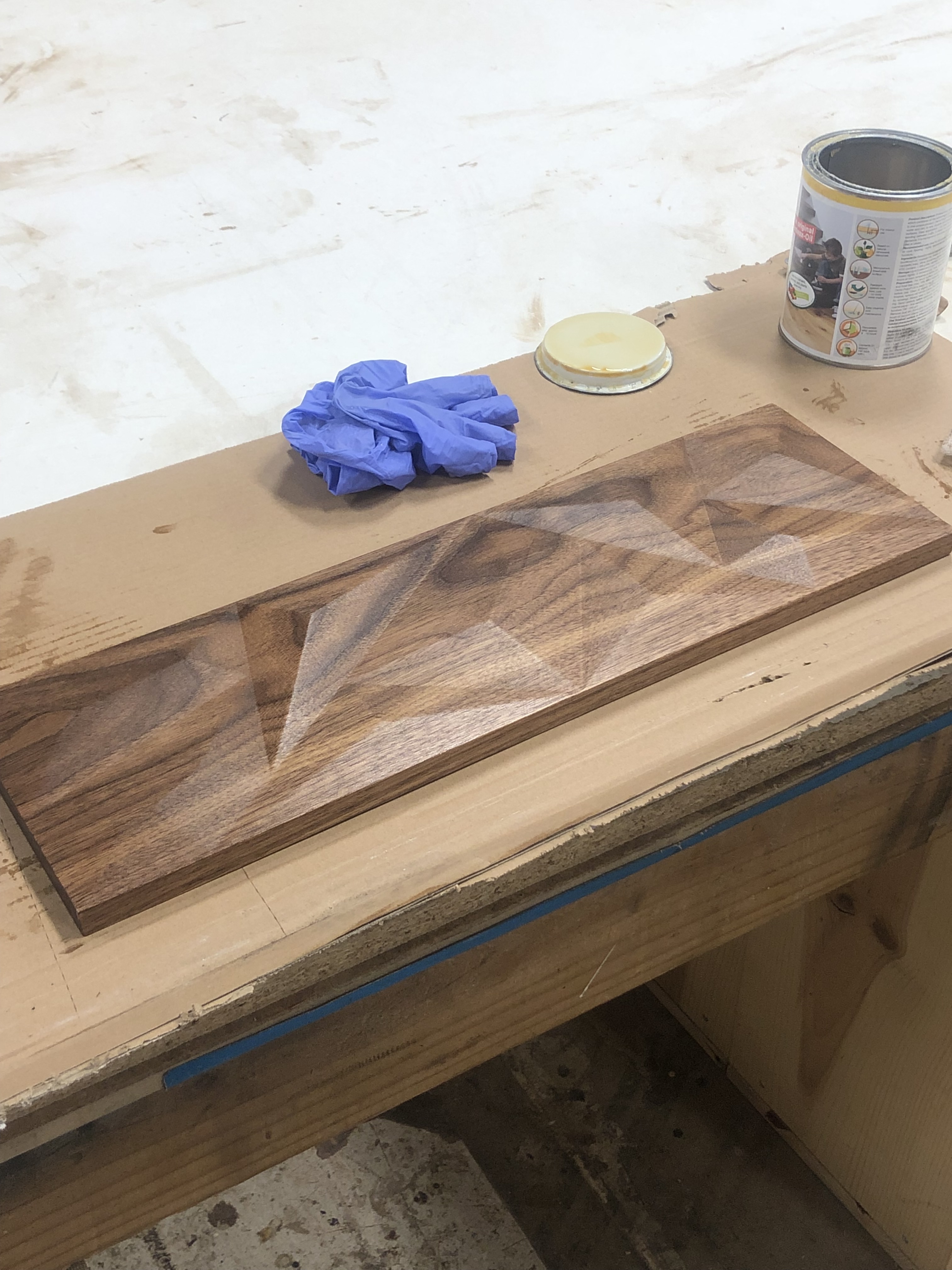

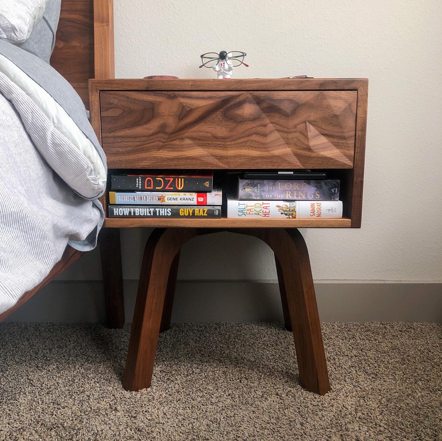

Vcarve has 3D profile cutting capability. You just need an STL. You’ll just need a roughing bit (like a 1/4" endmill or something) and a ball nose bit for the final fine pass. the smaller the bit, the finer the 3D relief can be. I did one a while back with a 1/64" ball nose V-bit and got great results. It does take a long time though, as step over is like 1/128” or something. Pics aren’t the greatest, but you can tell it’s a 3D geometric pattern and it required minimal sanding. On the first image. if you zoom into the walnut piece on the top left side, you can see my first attempt which I had to abandon as it took too long lol

Dude, I’m loving that polygon-look. It has a futuristic retro look if that makes sense. Would love to see the finished piece!
Thanks Steve! I tried a texture path but it took forever and looked like a disease :sweat_smile: I may need to adjust my approach.

Thanks! Credit for the technique goes to Bevelish Creations on YouTube, but I designed this one. He has a tutorial here: https://www.youtube.com/watch?v=PDR6hpo27Kc

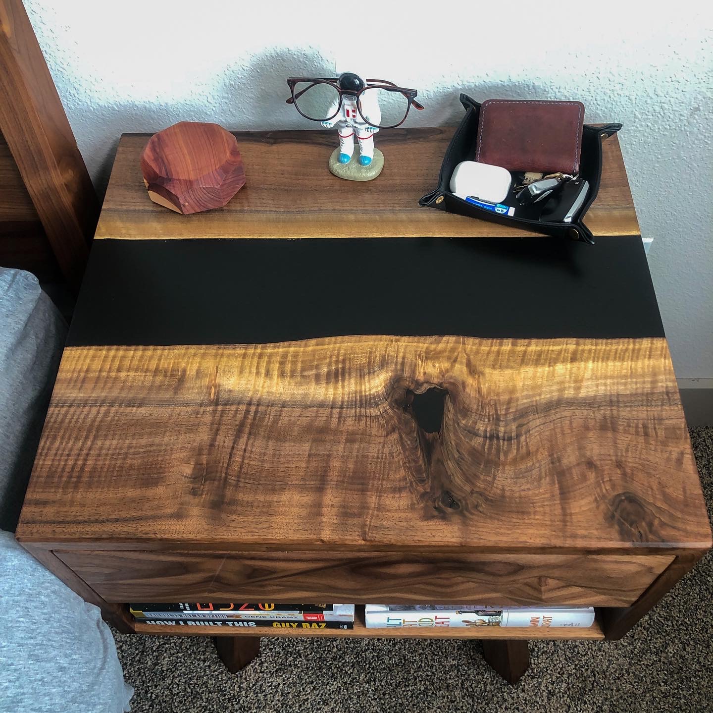

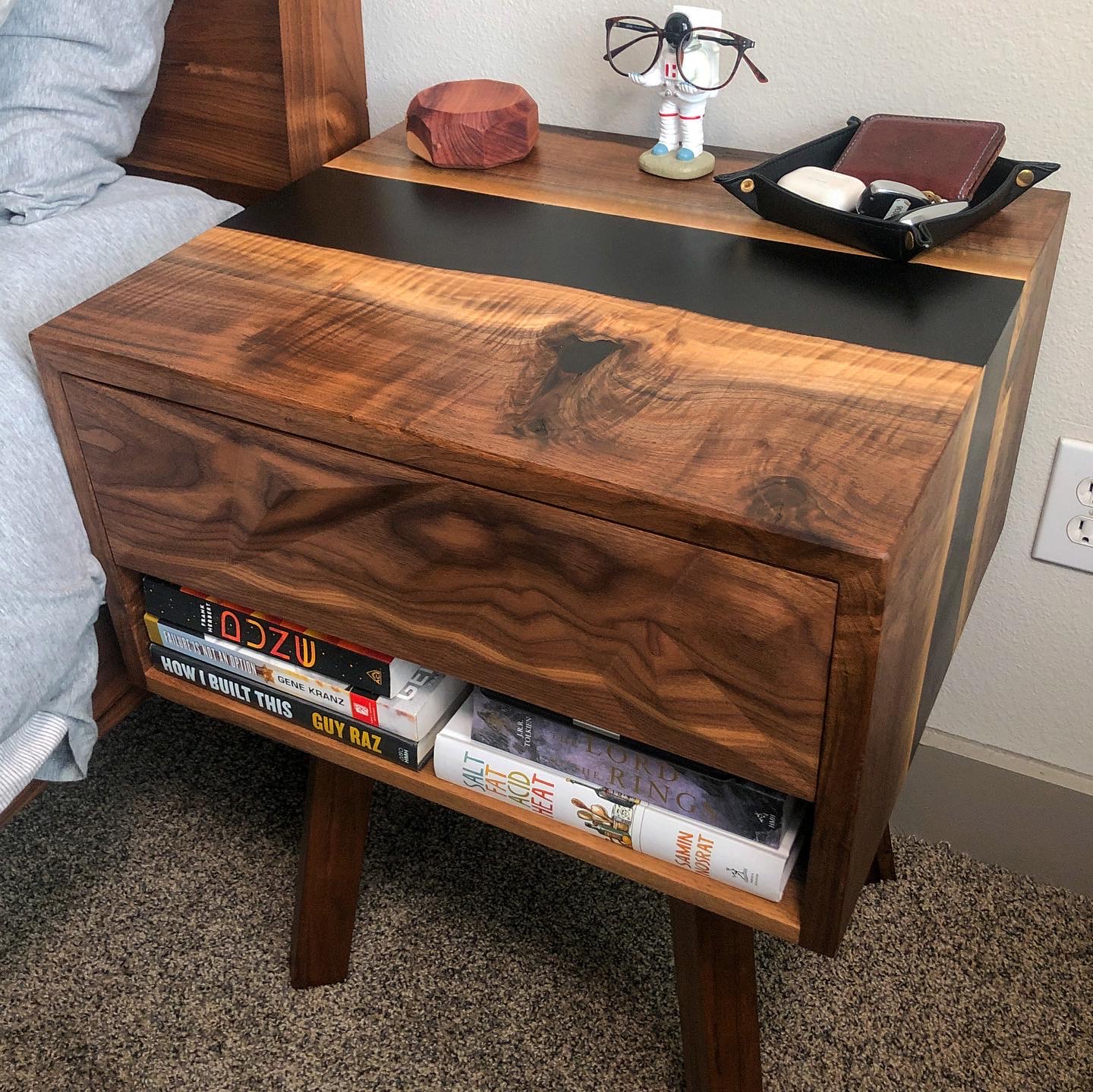

Here’s my piece finished:
