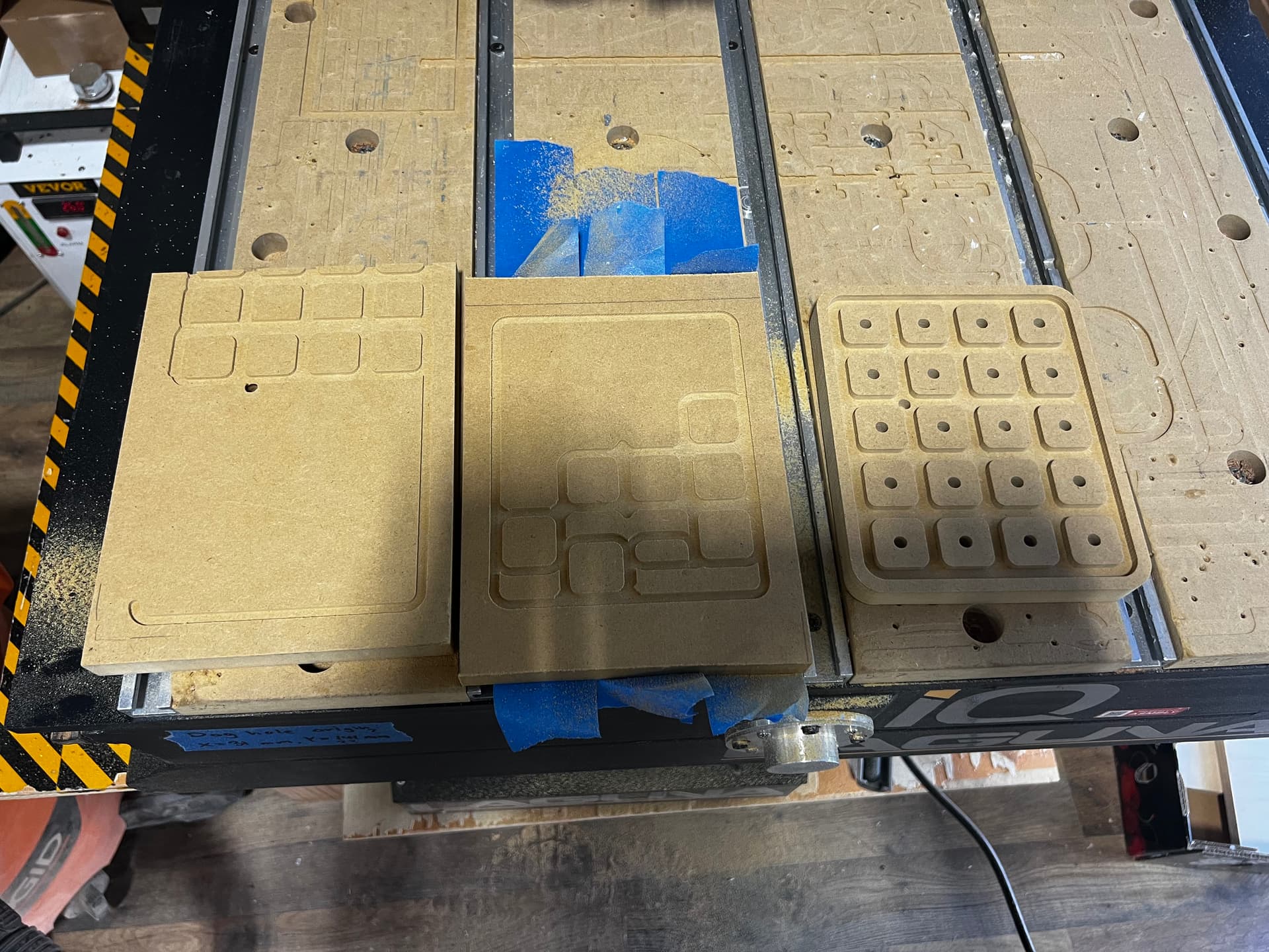

yes. Just today. first set of runs resulted in 1 good unit (on right).
Next two shown failed, unsalvageable. Final one (not pictured) only failed on the last three of the drilled holes, so I just cut the outline manually.
These were not long running jobs at all. No idea on the solution.

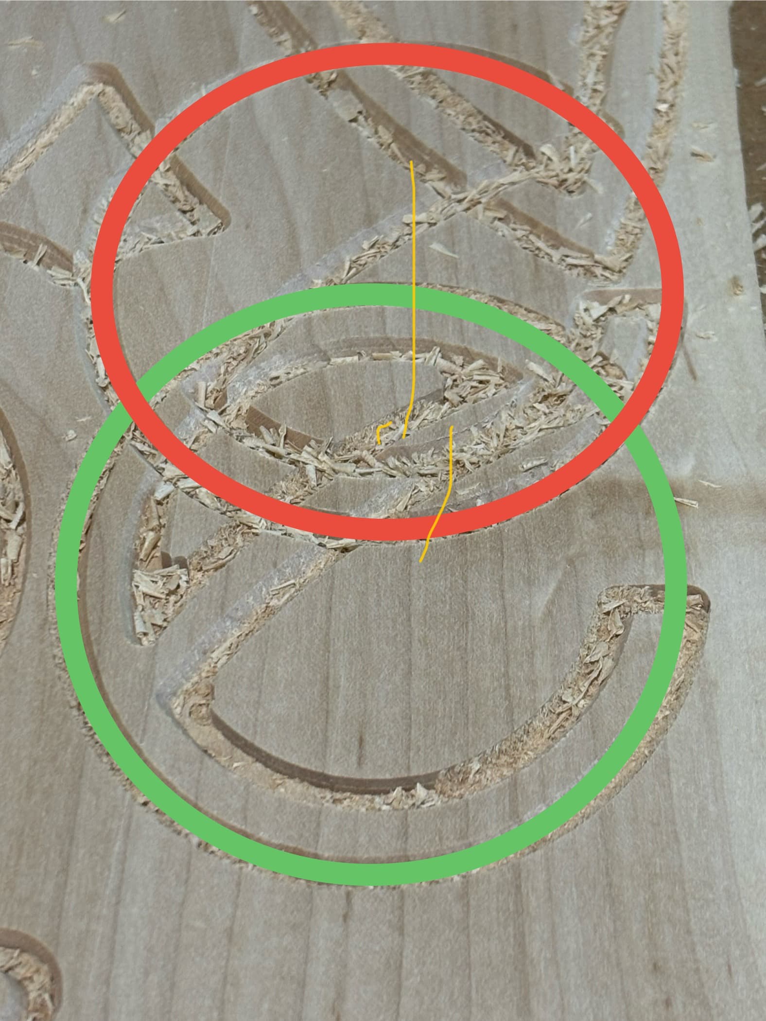

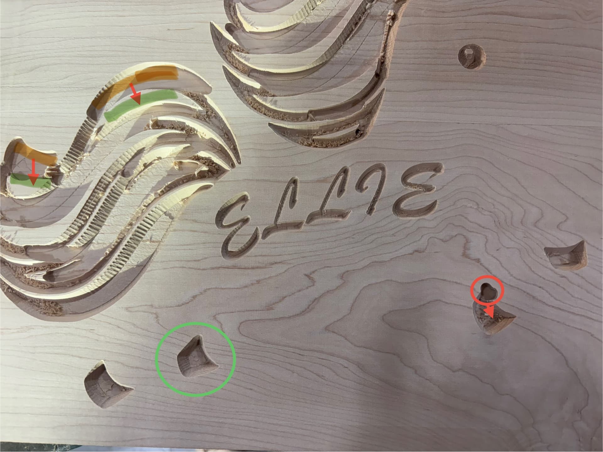

I had the Y-axis change, mid-tool path, with no stoppage, today. First, I ran the same tool path twice, and the second was way off of the first one. I planed the board before I took a picture. I thought the problem was related to the fact that I was using g-code generated for the big CNC on the small CNC, so I generated the correct g-code and tried again. The first two tool paths seemed to work fine, but not the third.
In the upper left, the tool path was the green area, but the orange area was carved. I thought that the Y-axis (which was off by 13), changed between toolpaths, but then I realized that it cleaned out the shape in the green circle (lower left, early in the tool path), but was high in clearing out the shape in the orange circle (lower right, later in the tool path).
The y-axis jumped over 2 inches, mid-run, this time. Green is the original y-axis, red is the new.

But honestly I don’t see evidence of that here. Steve’s photo doesn’t show the bit getting stuck mid-cut. The description is that the Z offset upwards, so that generally rules out all mechanical problems with the Z. It has to originate in the drive’s step/dir signals or before. And it appears the offset happens between runs- that points to a problem in the controller.
Frank’s photo shows offset in X or Y, which is a totally different problem. The orange hole is very possibly a stall point. The working axis kept moving in a straight line but the design doesn’t go far from there. There are no burn marks so the bit isn’t worn or overloaded. This could be RPM set too low, but more likely there’s a mechanical problem (gunked-up axis jamming the ballscrew or linear bearing) or electrical problem in the step/dir signals. It is unlikely the controller caused this one (possible, but unlikely).

Looking at my failed parts again, it looks like the controller simply skipped some lines in the program and just continued on.
On the sample on the left it should have completed the perimeter path then cut out the “grid” pattern. but in this case it did 3 sides of the rectangle then skipped the left side (-y movement) and started in on the grid above the full rectangle path that should have enclosed the whole part.
Second one completed the rectangle but then skipped +y movement and repeated the grid cutout on the bottom 1/2.
For the the first failure, I was adjusting the VFD spindle speed when It happened, but the other failures the speed was not adjusted mid program.
