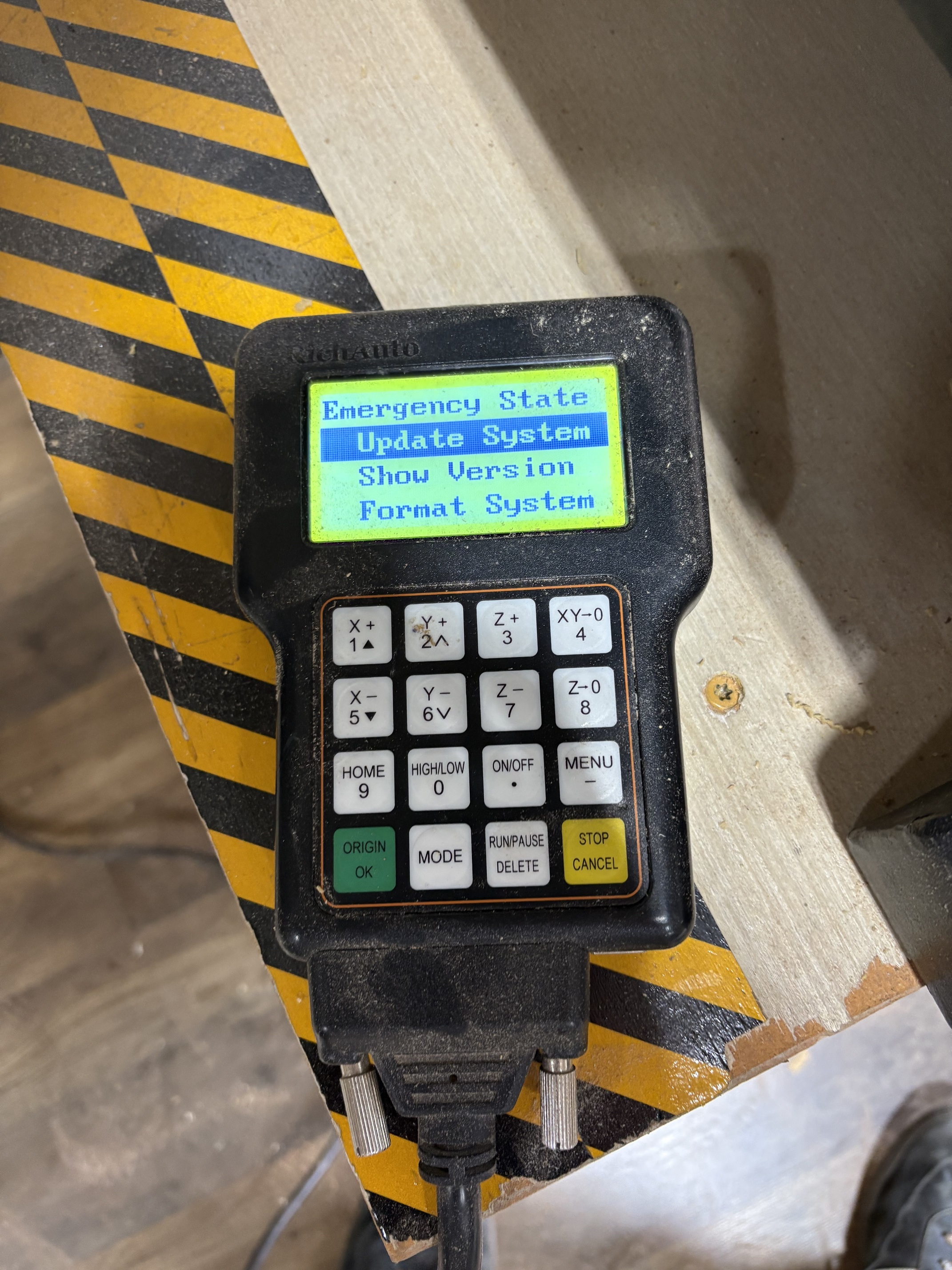

Hm. I had opened a red tag yesterday (or thought I had) about the small controller showing an emergency update needed. Did you see that too @bwatt ? Could there be a software issue lurking?
It did not show “the small controller showing an emergency update needed”. It just returned to the standard default screen showing X, Y & Z coordinates. And a message that said something about “user finished”. Next time I’ll take a picture, but I was so surprised it happened that I forgot to do that.
