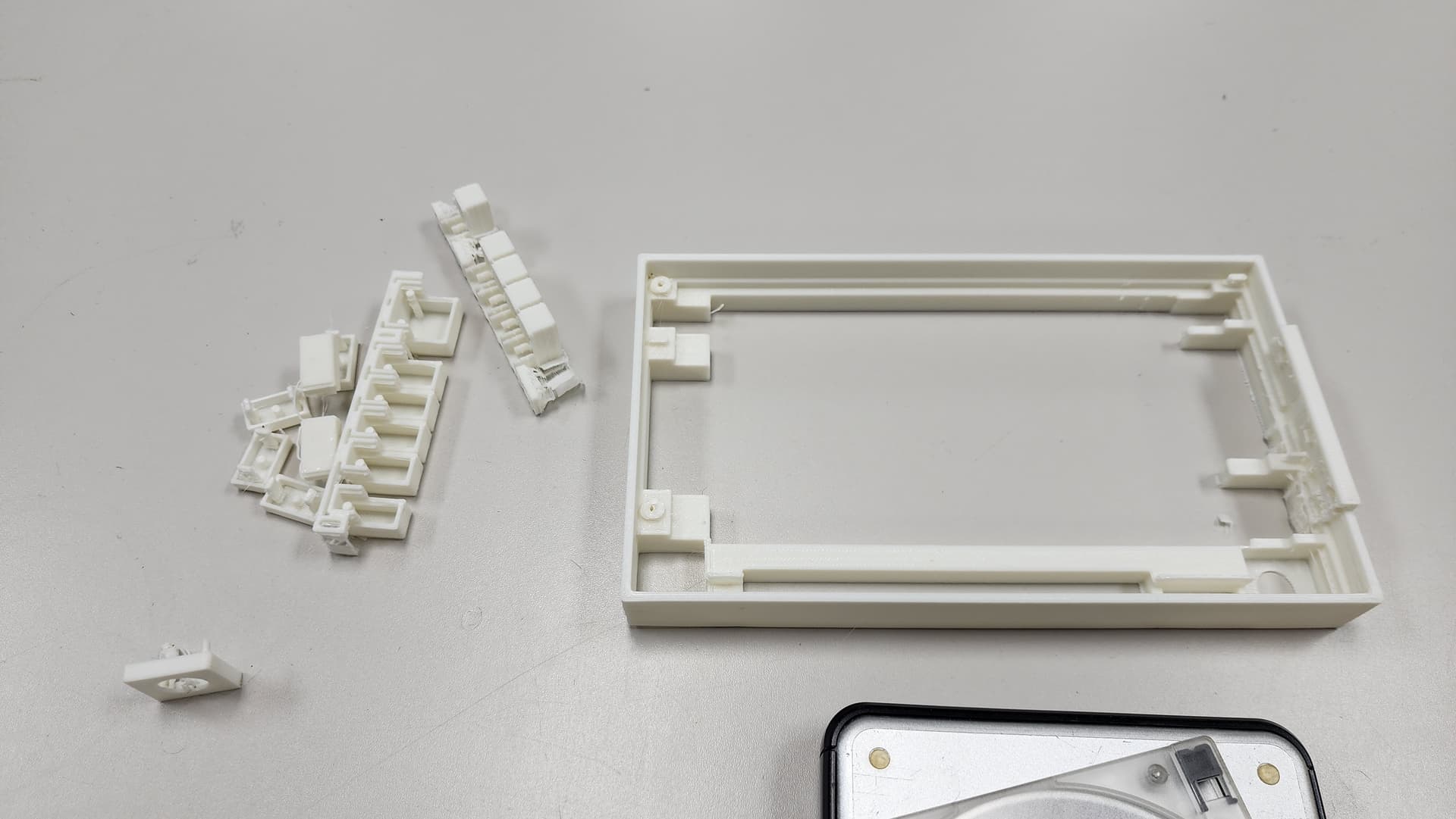

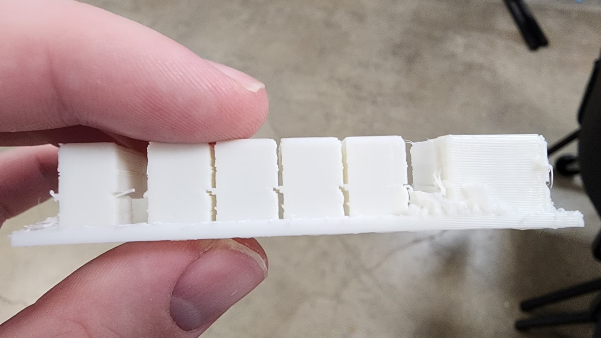

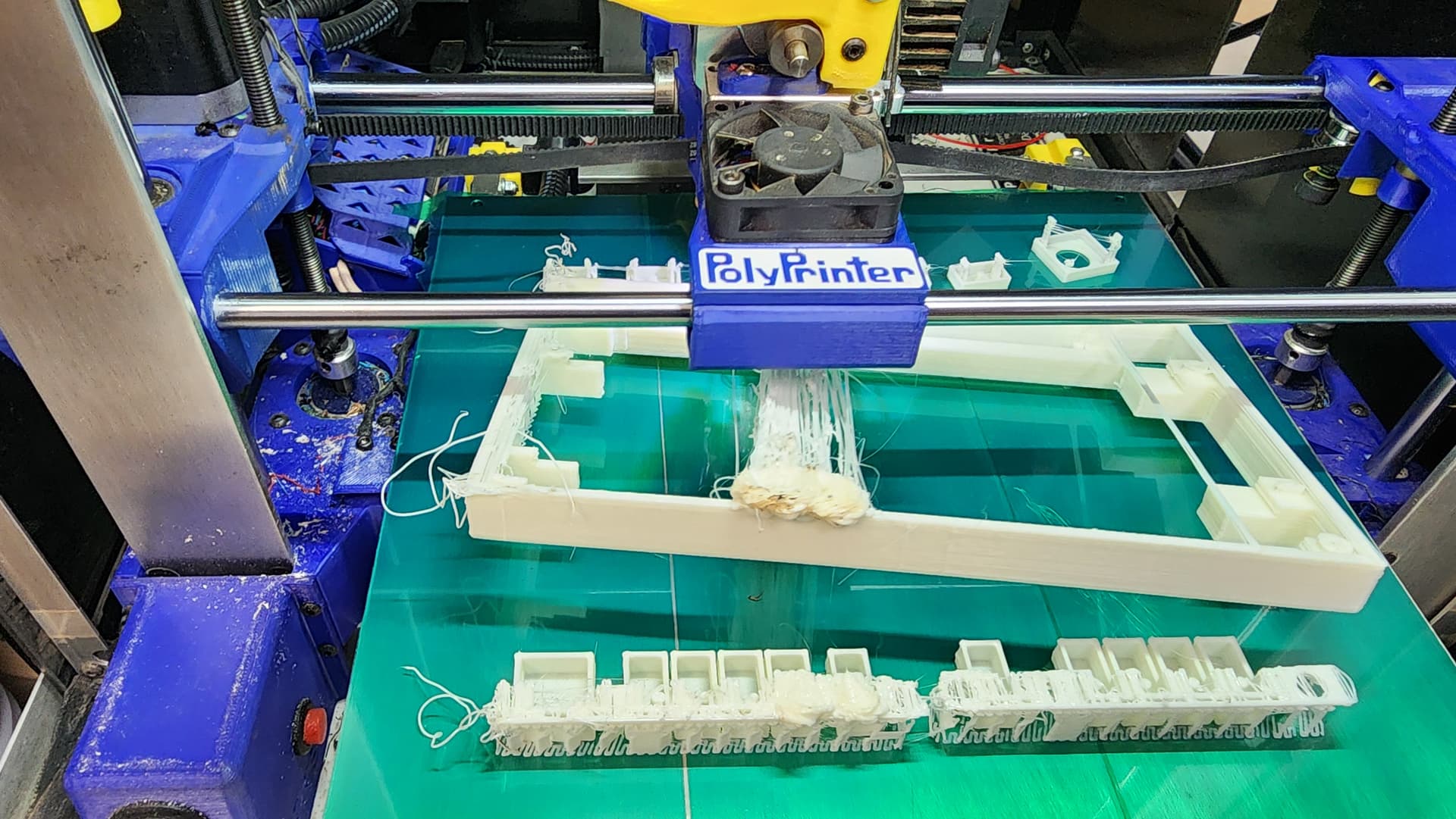

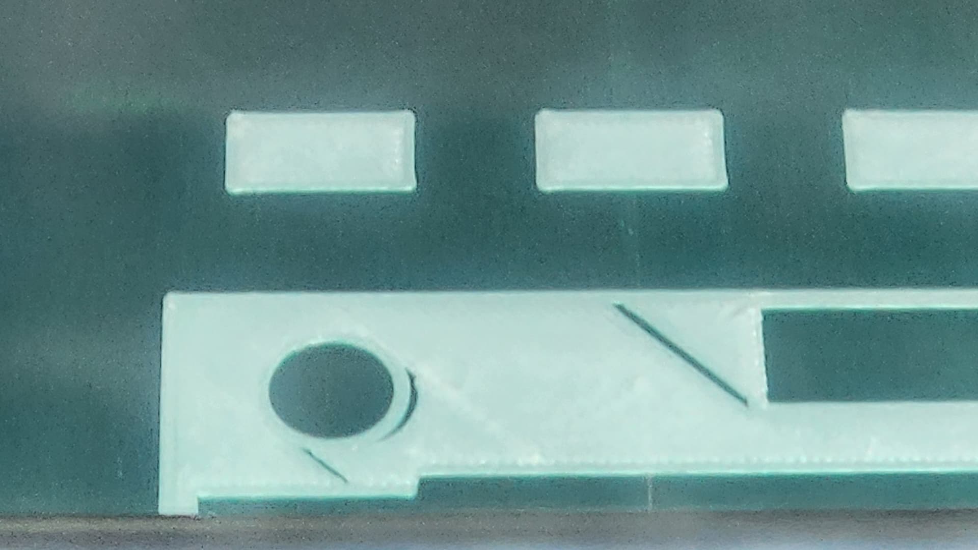

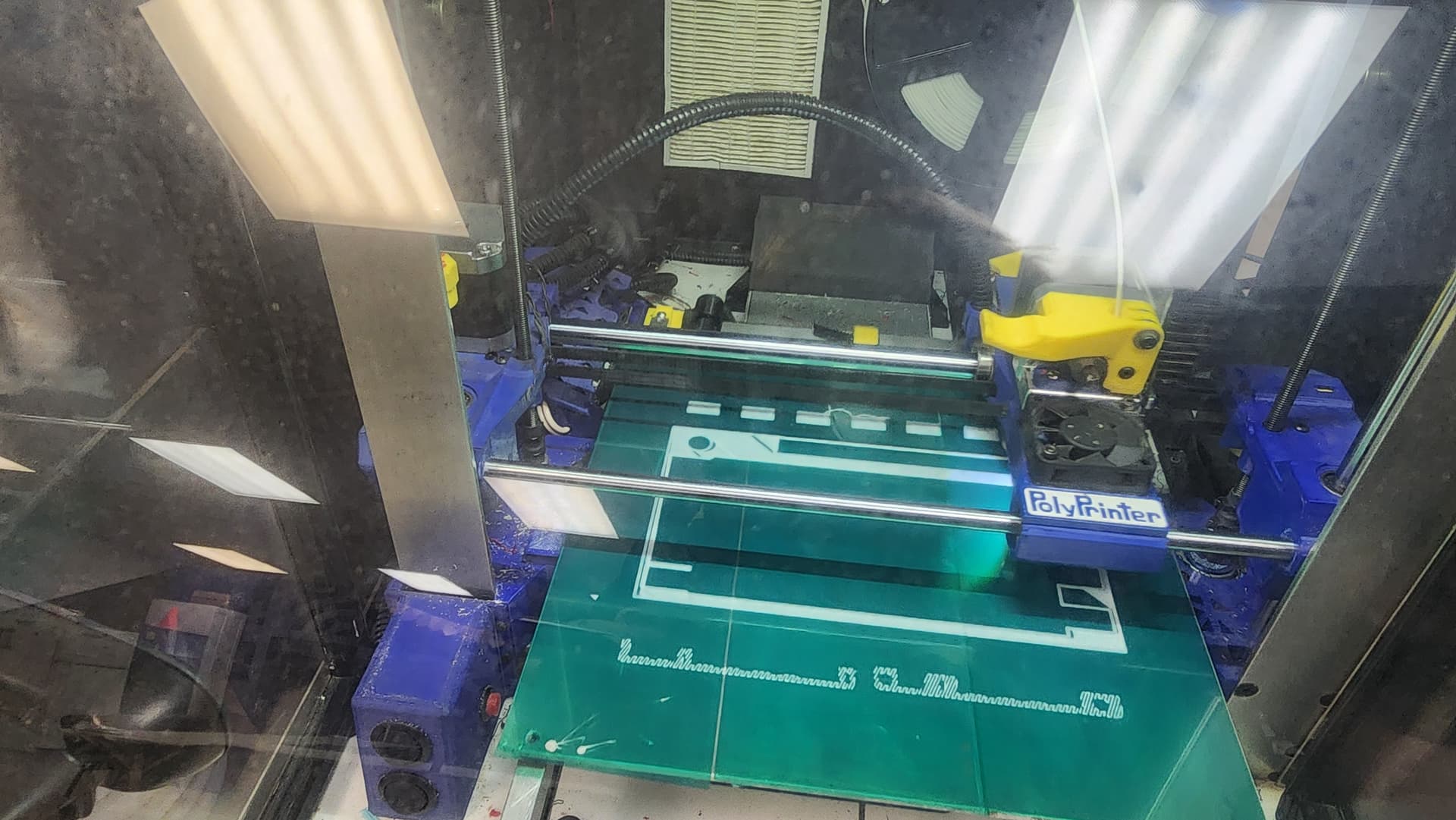

I just started the print and there are some gaps in the first layer, which is similar to what I was dealing with before. I’m going to let it print overnight but can come back after lunch tomorrow. @aneel , will you be at the lab at all tomorrow? If the print shifted again, I can stay there a bit longer and we can figure it out.
I checked my KISSlicer settings after I got home and found that the nozzle was set to 0.35mm. Possible that that was causing the issue? I mean, the gaps are bigger than .05mm.
I tried downloading the newest version of KISSlicer too but it didn’t have a default 229 profile for some reason…
Unfortunately, I’m no expert on the PolyPrinter (@EricP is the best bet for that). I’d be willing to run a print for you on the Bambu and see if that helps.

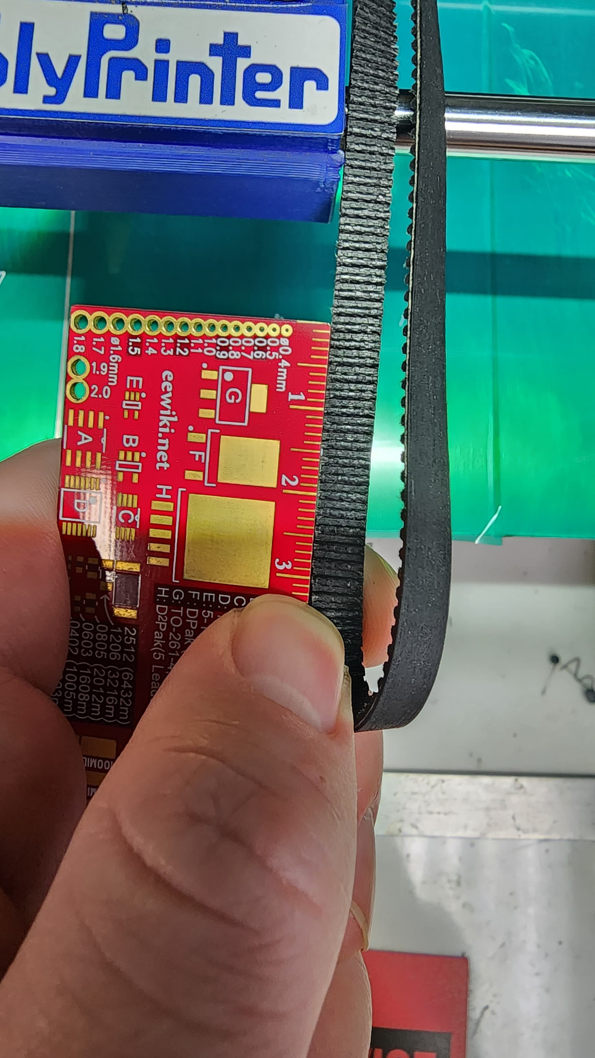

Hmm I adjusted the belts and oiled everything down. I was getting good prints but didn’t do extensive testing. Try that same print with the speed setting all the way to precise. I think we should go ahead and replace the belts.
that Nozzle size is correct .35mm,
I’ve reached out to PolyPrinter about replacement belts. If you know the specs, we could look for a 3rd party source.
I re-generated the GCode with that setting and am heading to the lab now. If it looks like the print failed, I will book time and try it with that GCode.
Print was a bit rough. I started the more precise print and it looked like it was maybe going to have the same issue, but I will see how it turns out this evening.

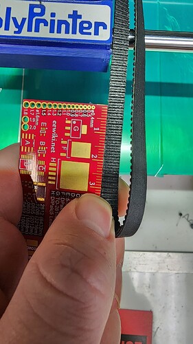

Here is some of the belt specs but we need to know the thickness of the belts from top of rib. etc. also for the y cariage need to know the rib distance spacing. @AidFHonda could you measure for me.
Polybelt.com is where we should look, I think.
One that is close for the top belt but need to choose correct thickness
270XL037 Timing Belt Polyurethane Steel cord 135 Tooth – PolyBelt.com
there is a diagram on that poly belt link that illustrates what info we need.
I can measure that when I’m back at the lab.
Well, I measured it, and it was easy because the pulley had come off. I had to red tag the Polyprinter.
