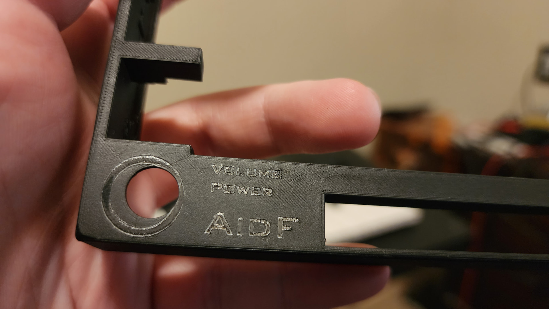

Making Car Buttons?
I’m using a Prusa MK3S+ with a 0.25mm nozzle. I would like to be able to at least try swapping filaments because I discovered that even low power can melt the plastic. Plus, there is no frame of reference for the origin on this engraver.

That may be too thick. I have an idea for an inverted stencil I will try.
Paint ran under it so that won’t work.
