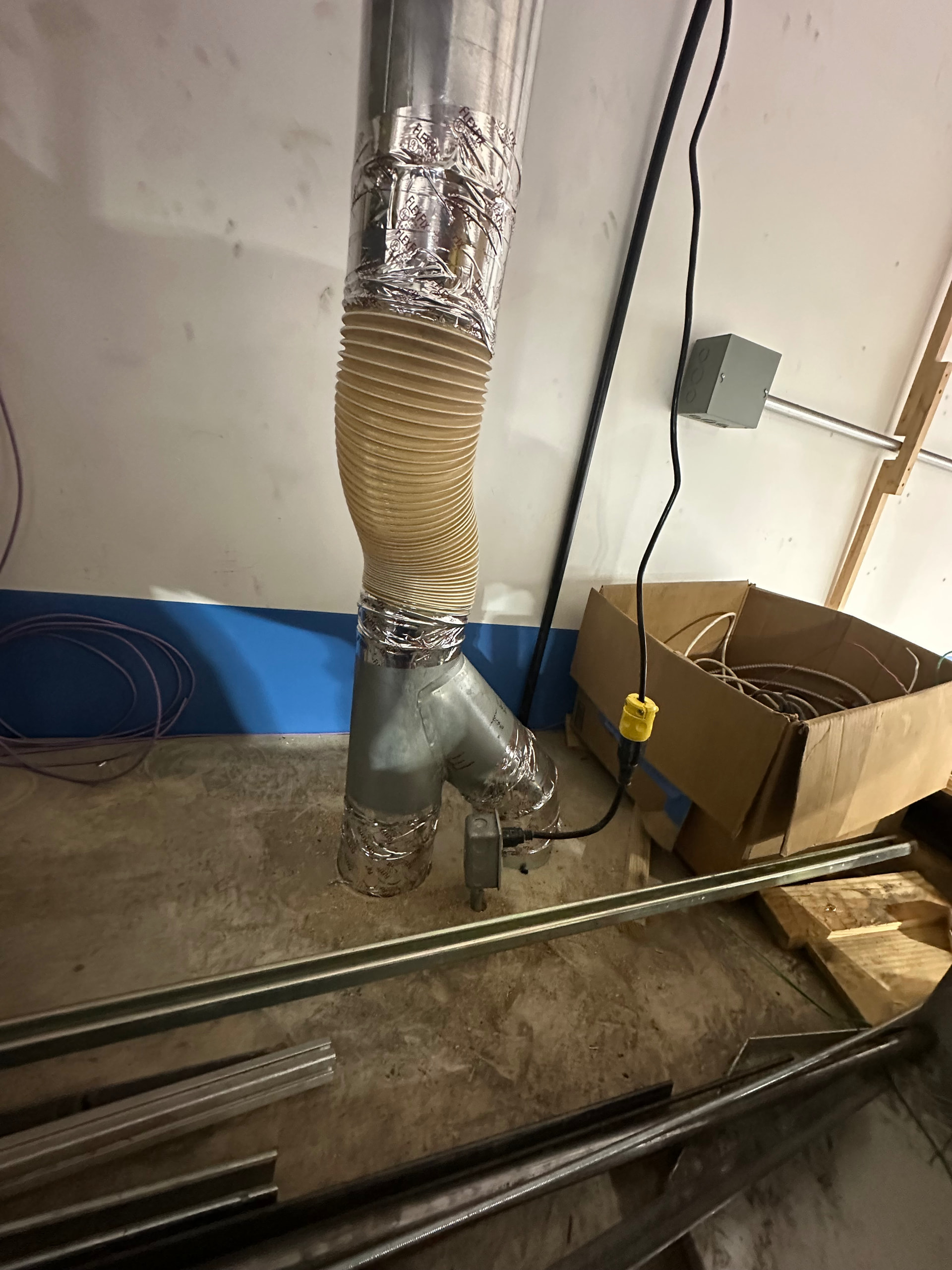

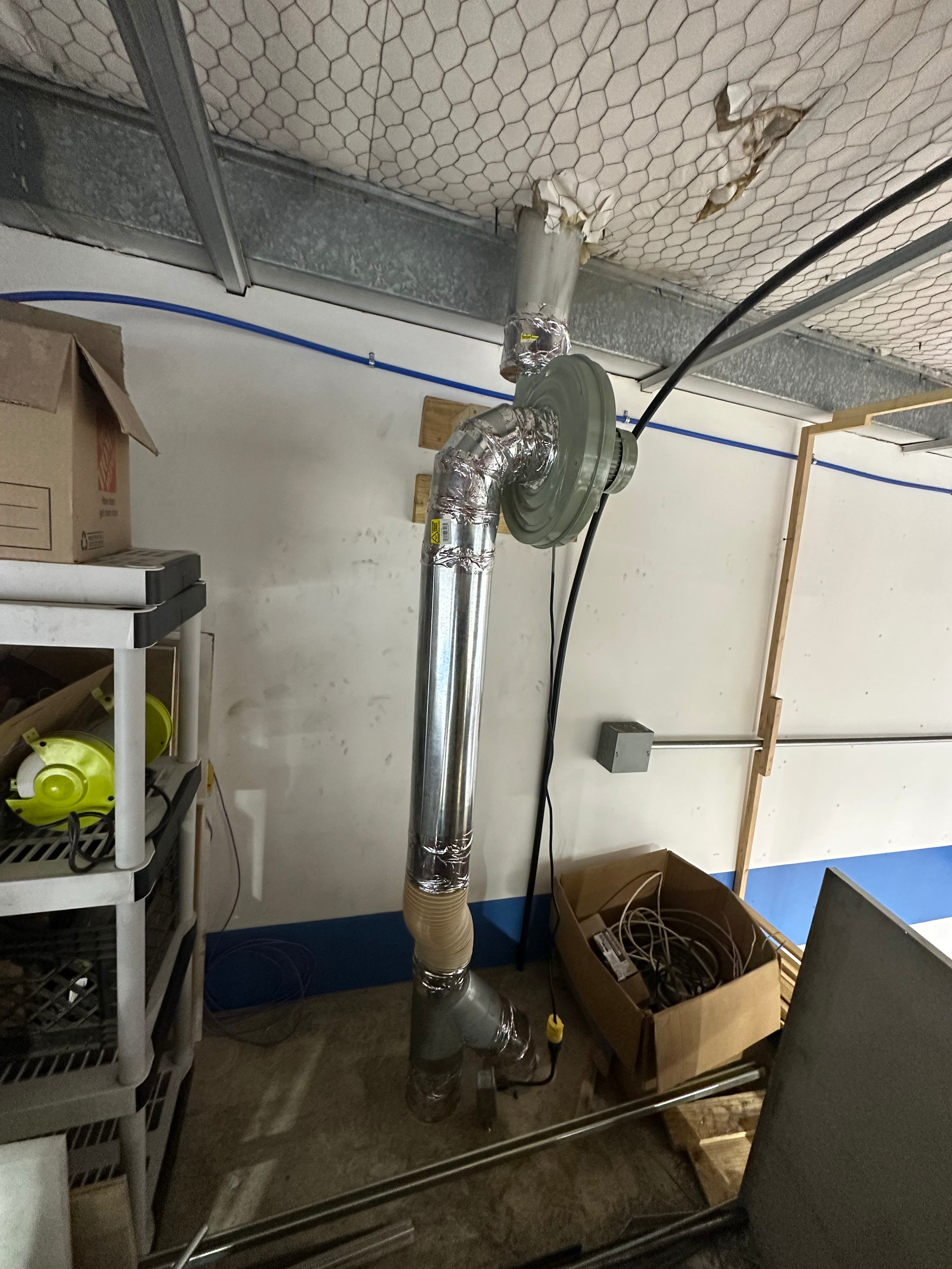

In the meantime, that is not the only obstacle to using the laser welder. If someone wants to meet with me on Sunday to discuss setting up the ventilation system properly — the temporary setup I put together as proof of concept fell apart (not surprising, since it was literally balanced on sticks) — that could speed up matters. It is not a trivial undertaking.

Eric and Patrick were working on fixing (upgrading, actually) the ventilation setup. Then I’m going to get people together to work on the training class.
We got the ventilation knocked out. There was a slight offset so we used a short section of flex to make it work.
That is amazing. Thank you so much!
