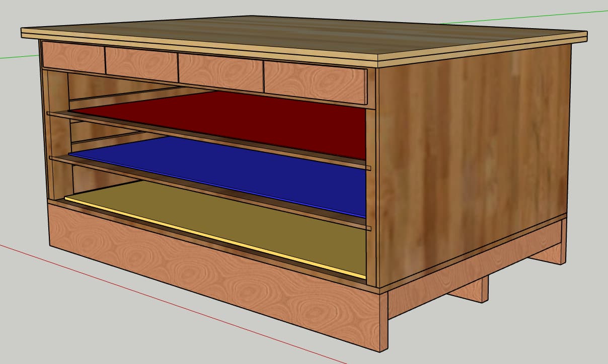

We’re finally building the new central worktable for the laser shop which will provide a completely open, flat 4’x6’ work area (all tools will be put away in drawers!) with inlaid cutting mat, as well as shelves we will be stocking with plywood sheets members can purchase onsite. This will be a sweet member perk for those who come up with great ideas on the weekend and hate the limited options at big box stores, as well as those with vehicles difficult for transporting sheet goods.
This cabinet is massive and as such is designed to be compatible with a skid jack for moving it around as needed. Here’s a model to give you an idea of what it will look like for the most part:
The shelves will be dado’d in from 3 sides and have a hardwood L brace on the front edge that fit into the dado in the front (not shown in model) to provide maximum rigidity for the shelf span while minimized additional weight. If we find down the road that this wasn’t enough support, we can always add more reinforcements later. However, we will be going with this design to start.
