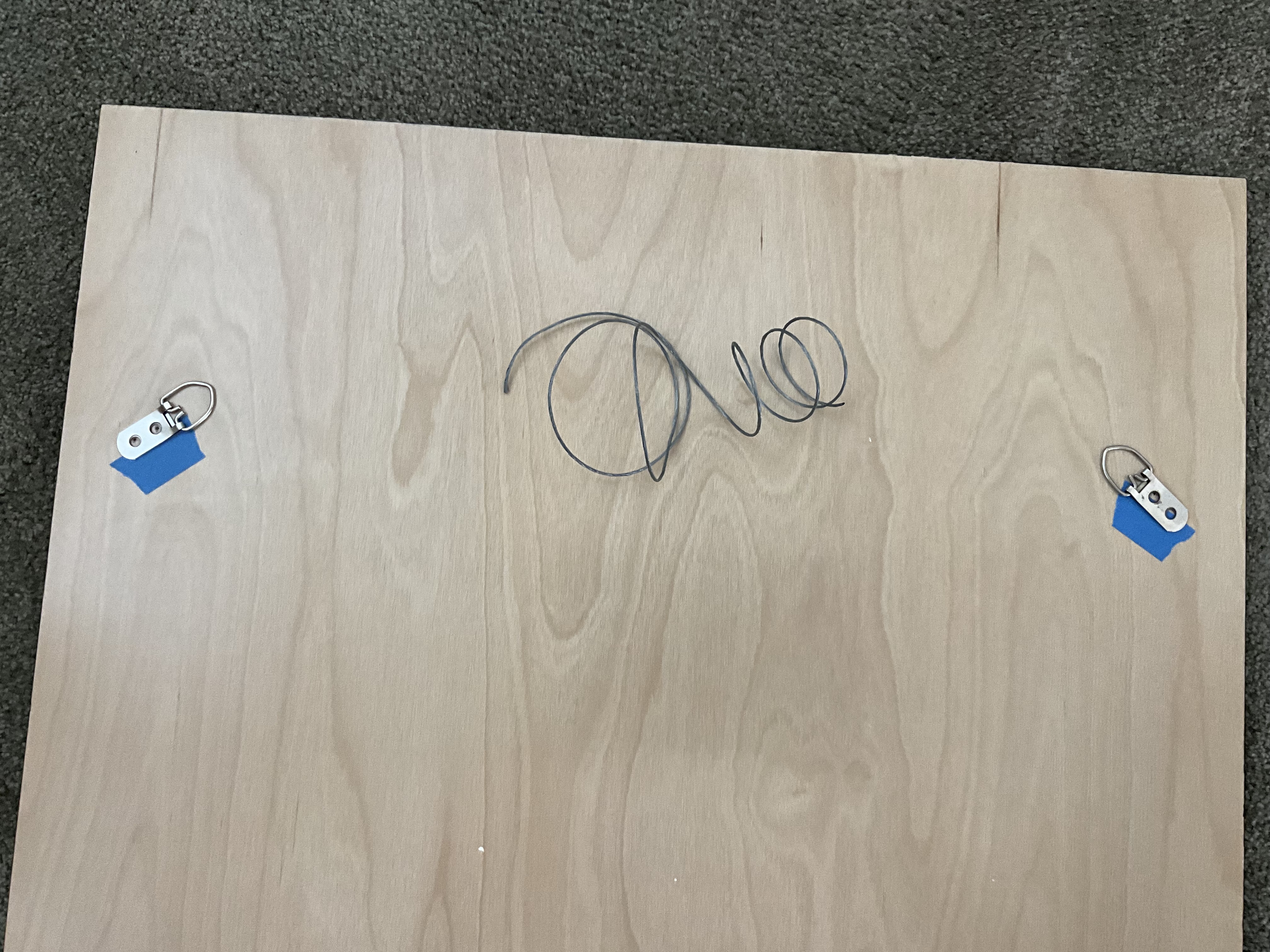

I was anticipating installing framing wire on the back of mine.
Layout
@bwatt no, haven’t gotten any takers on helping with french cleats. Hanging wire works but makes it harder to have any sort of consistency in the way they hang, so if we go that route we’d have to be very intentional on where hooks are for them in the wall so they don’t look like almost aligned but not quite.

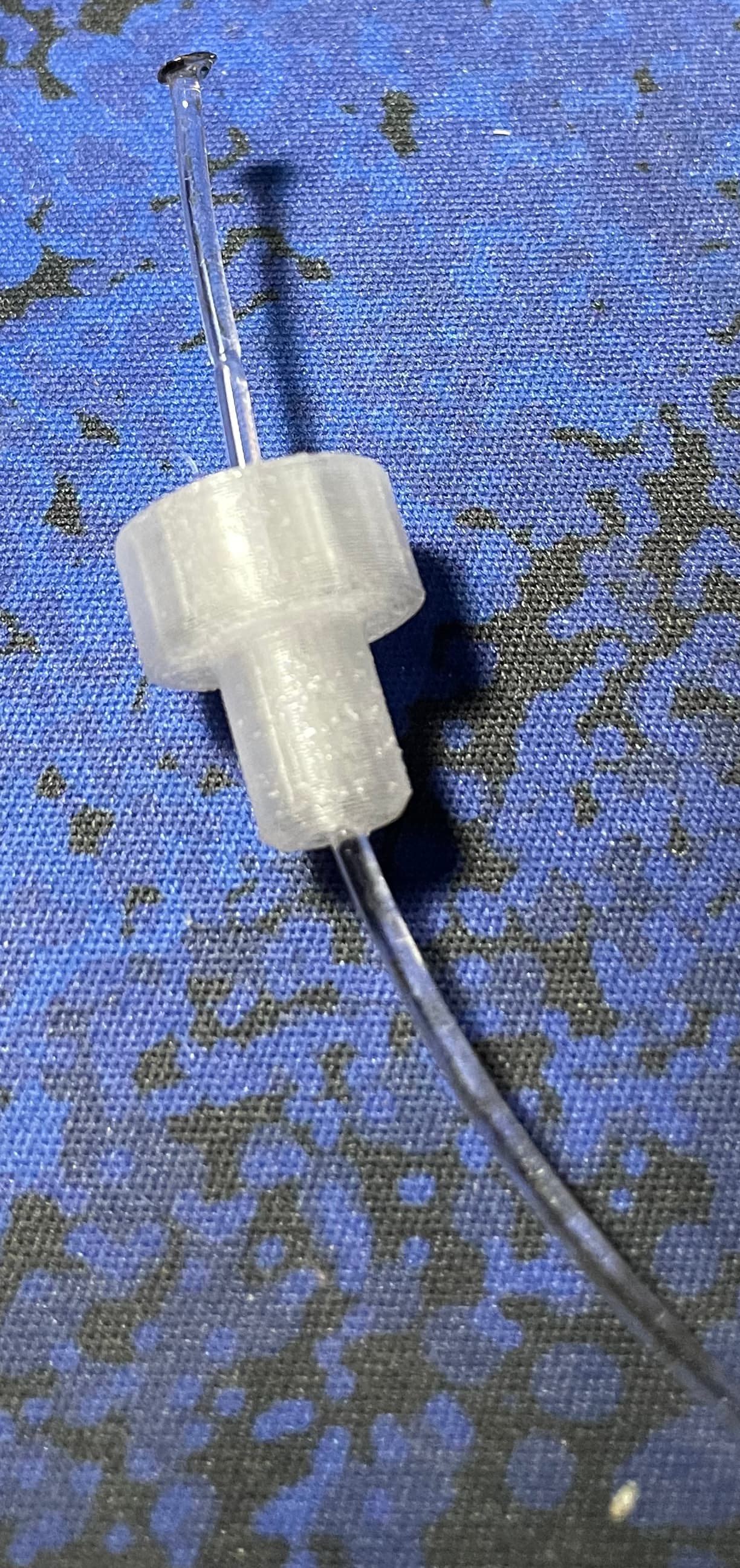

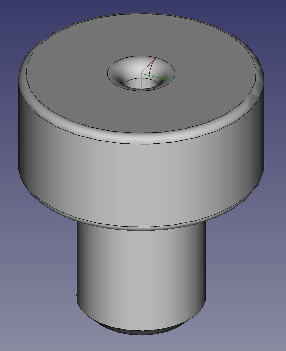

  4. Next I’ll 3D Print in Clear PETG ten T-Slot Adapters which fit into the T-Slot Rails (I already have the clear PETG $0.00). Note: There are nine people or teams signed up for the 2x2 challenge project.
  5. Each Adapter has a 10’ length of PETG filament attached to it (ditto $0.00).

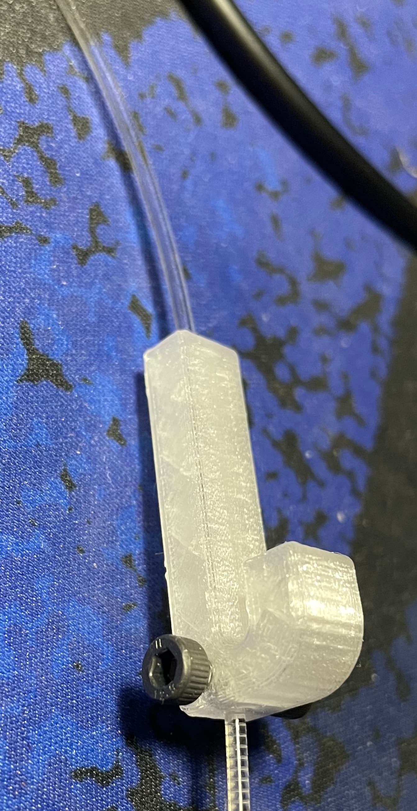

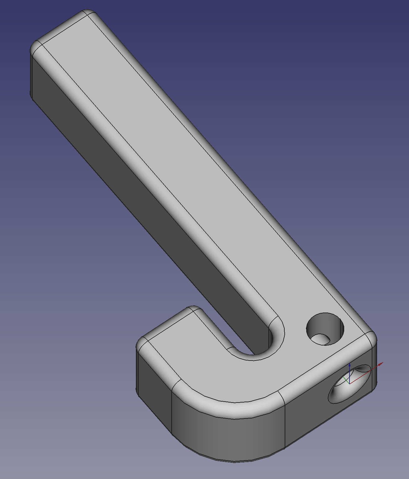

  6. Similarly I’ll 3D Print ten Filament Hooks, slide them onto the filament and screw them tight with 3mm hex screws (ditto $0.00).
See pictures.
Each Picture to be hung requires their own picture hanging wire or mounting bracket and will hook onto the Filament Hook. If mounting brackets are used I might need to create different Filament Hooks design for them. The pictures height is adjusted by loosening the 3mm screws, moving the Filament Hooks up or down, and retightening them.

Adapter, Hook and Filament (temporary White PLA Filament)
T-Slot Adapter and Clear PETG Filament (filament top melted to prevent pull through)
Filament Hook and Clear PETG Filament (Clear Filament should blend into the wall. Filament is presently on a reel and may be permanently curled)
T-Slot Adapter CAD (Center Hole for Filament)
Filament Hook CAD (Center Hole for Filament, Side Holes for two 3 mm Tightening Screws)
