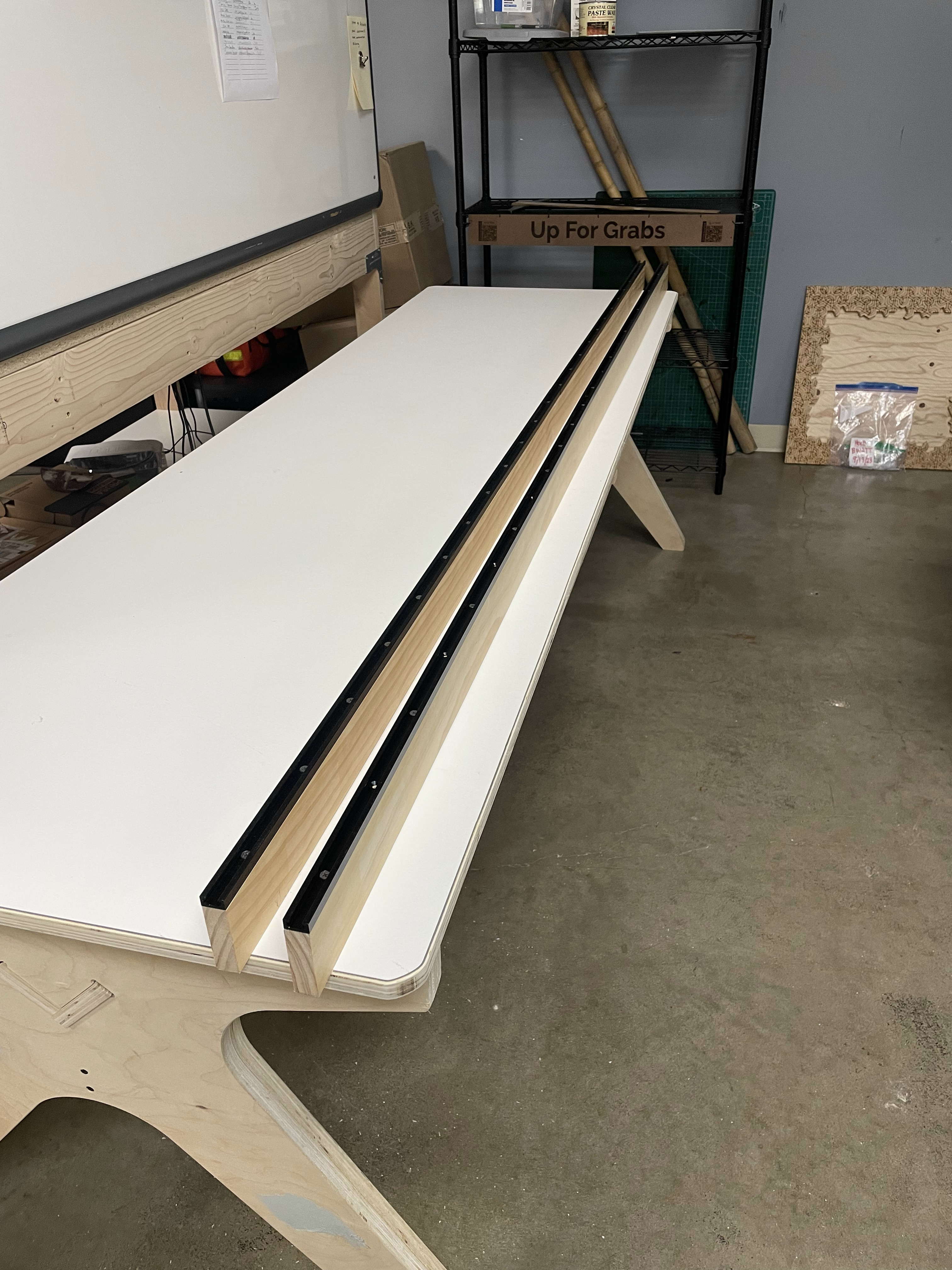

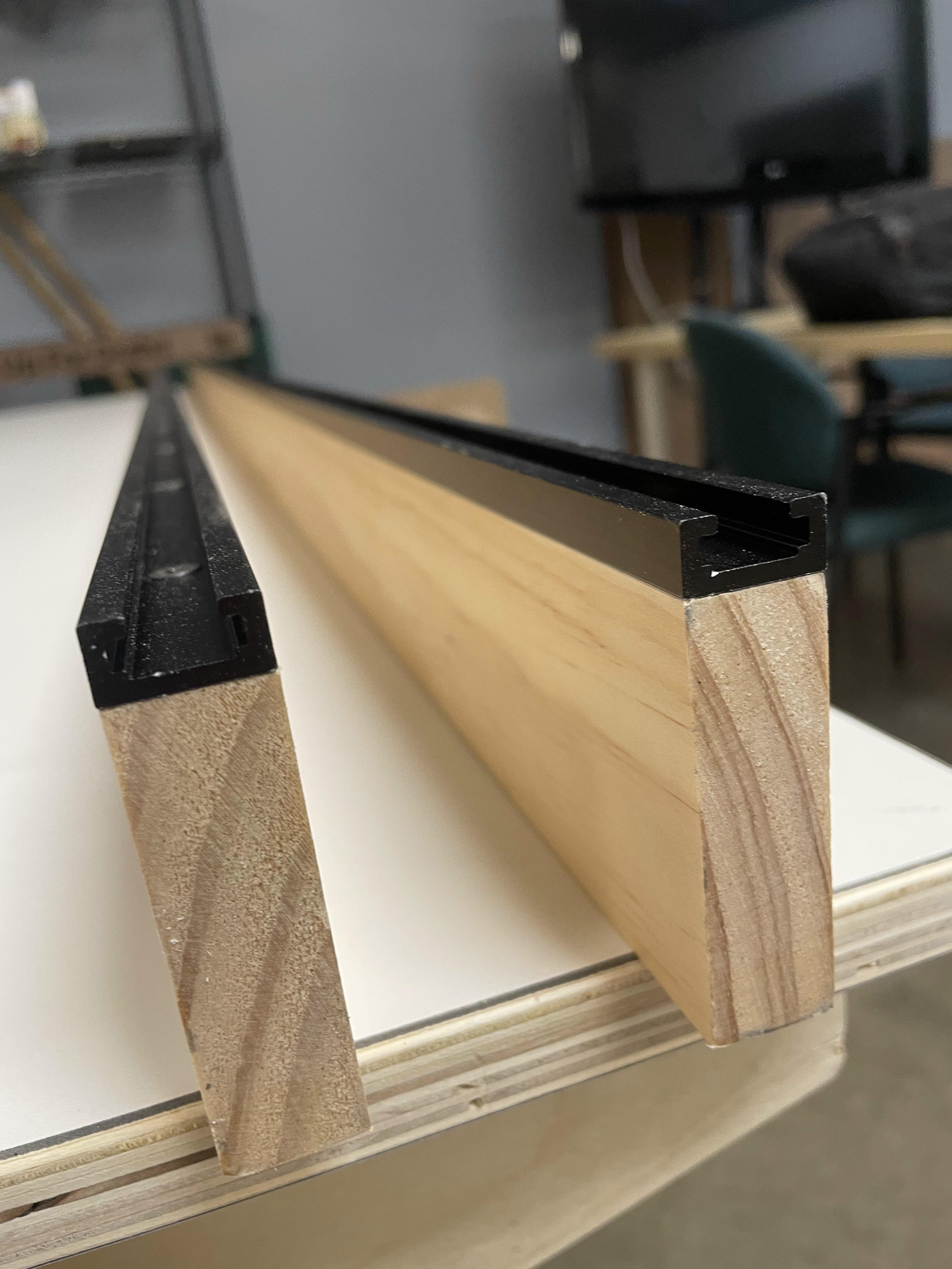

Got the package! Michael helped me find them under the table. I bought two 1x3x8, and put the T-Slots on them. Both are in the MPR with a “Hold” note with my name on them. Tomorrow, if @David is there in the afternoon and if we can find ladders we’ll attempt to mount them. Also I have a sample picture to try the hanging ‘hardware’. P.S. If there is some leftover wall paint I could make them match the walls, otherwise they’ll just be natural wood (the classic maker patina).

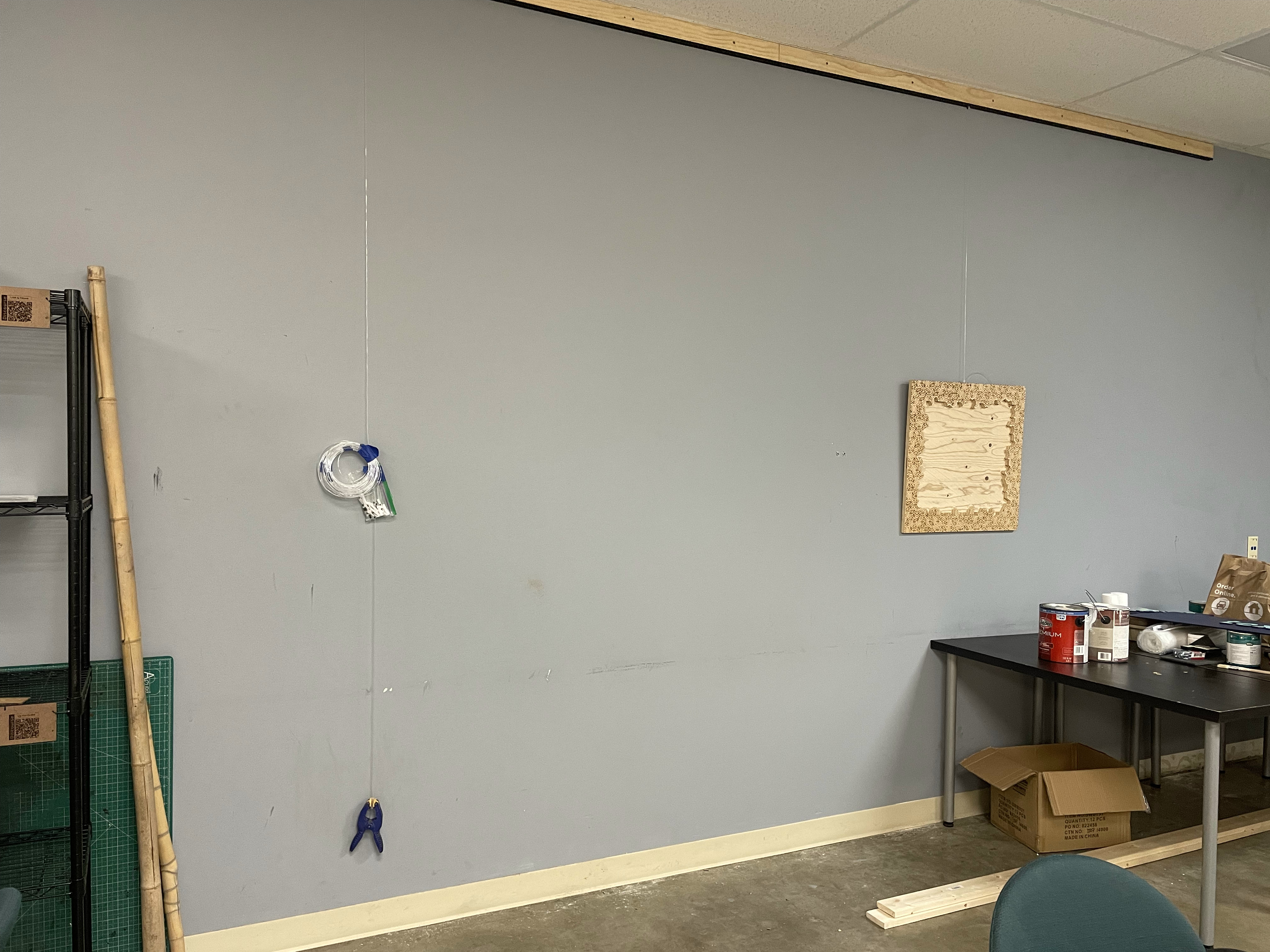

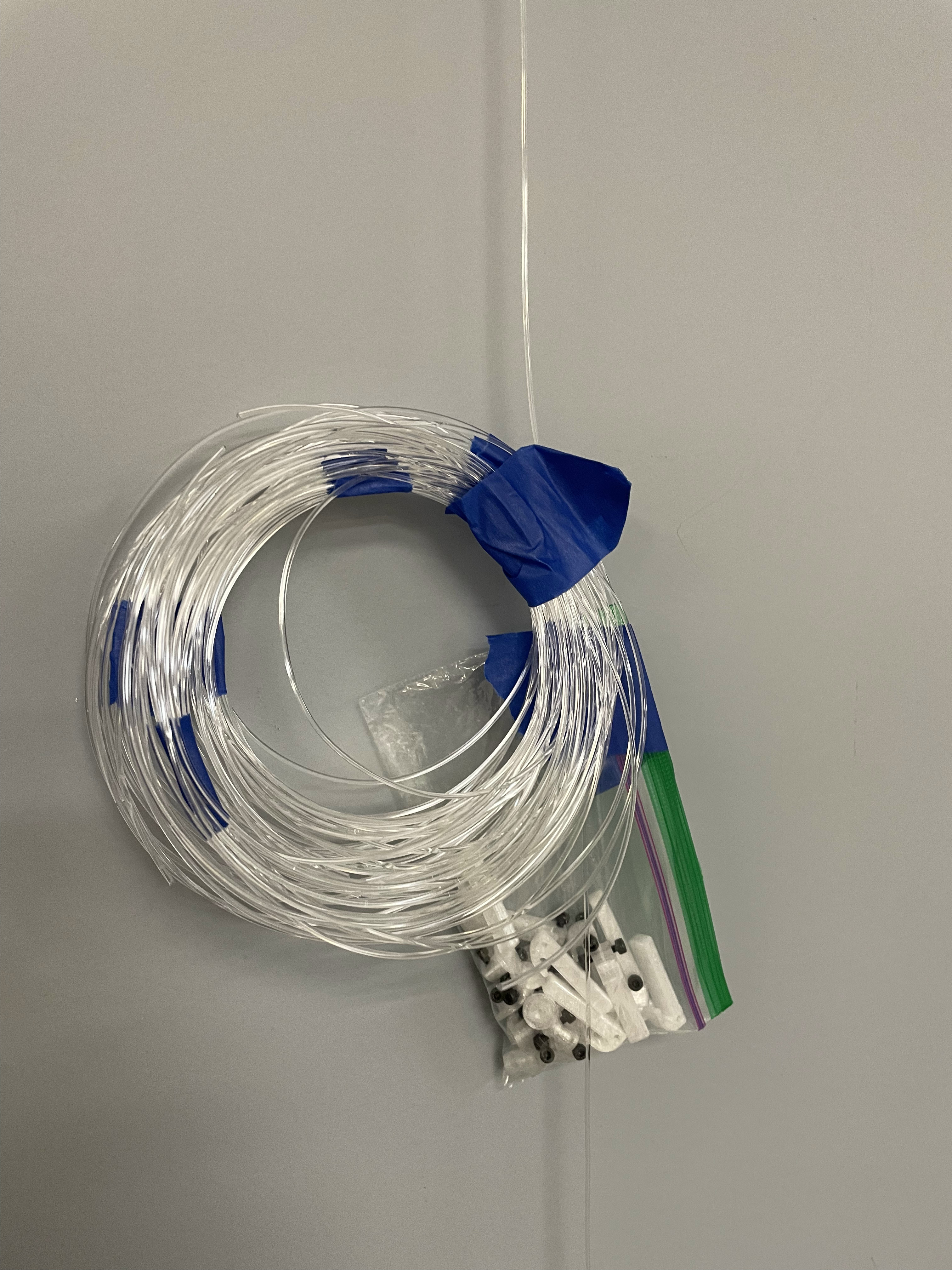

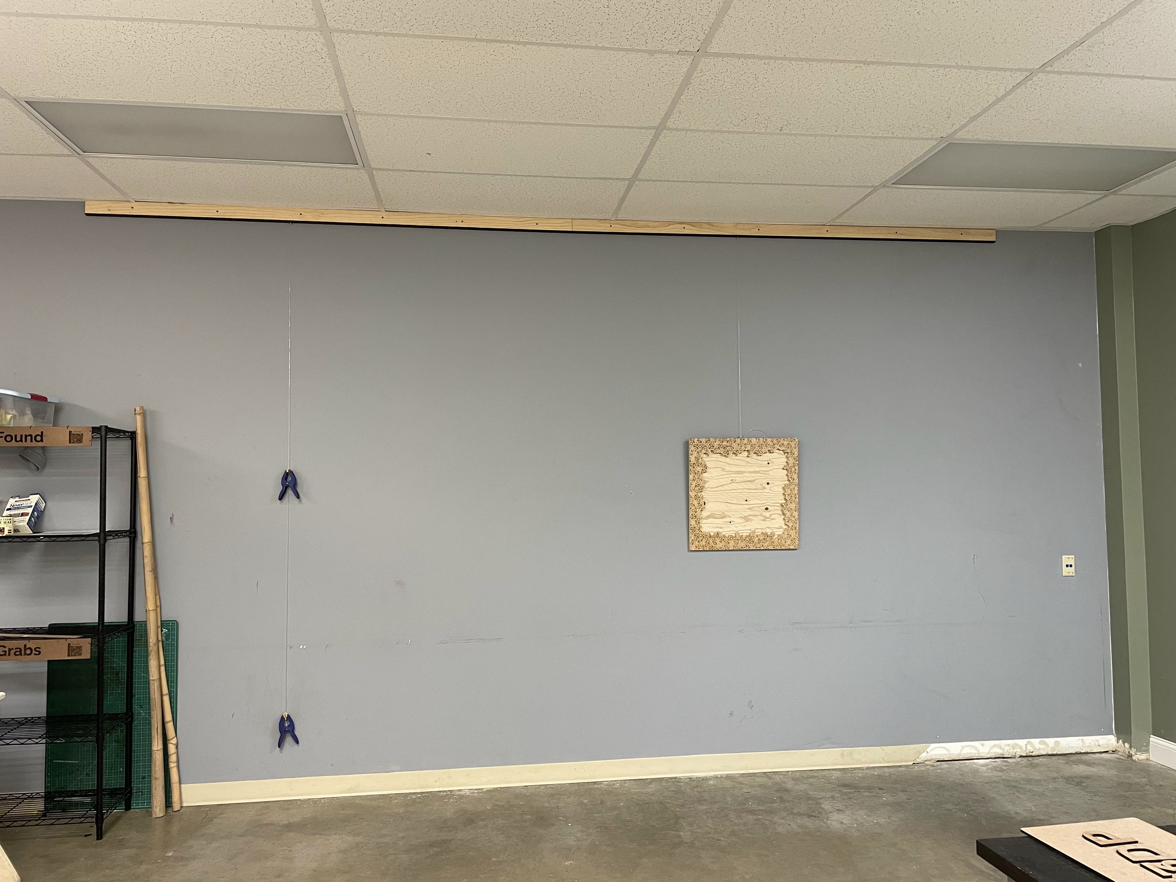

The picture hanging system is now ready for hanging the 2x2 challenge project. I have left 10 cut filaments, 9’ long, for hanging the 10 entries. Two filaments are already hanging with their t-slot adapters (tops) and hooks (bottom). The right one has a pseudo 2x2 as an example. The left one has some clamps to hold it down and the rest of the filaments taped to it along with a small plastic bag filled with adapters and hooks. Not all adapters and hooks have their 3x5mm set screws. I will getting more set screws shortly to complete the project. Until then here as some more pictures of the installation.
