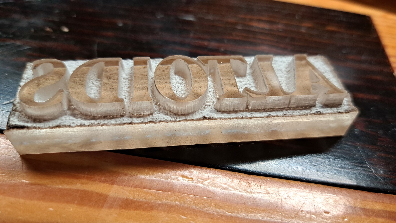

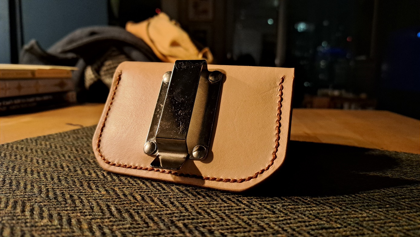

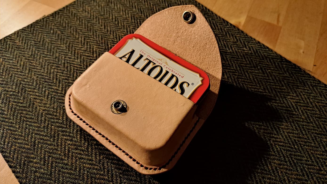

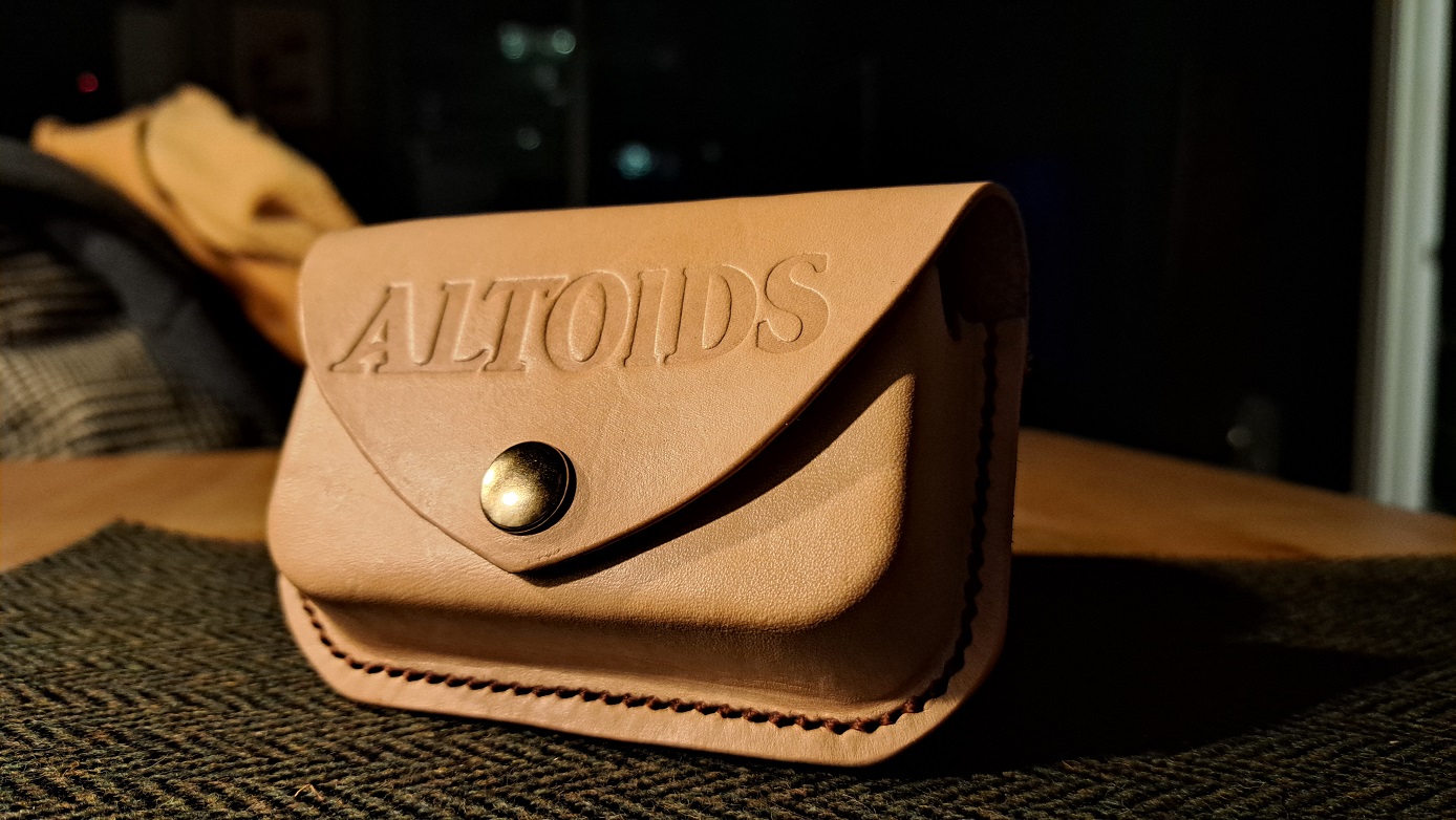

What will surely become the next craze a la the fanny pack, here is the finished… belt leather pouch for an Altoids tin:
The front is wet-moulded over an actual tin, and the debossing was done using an acrylic stamp made on Tarkin:
Was the stamp rastered in a thick piece of acrylic or cut and mounted on something else?
Yup, just 1/2" cast acrylic and raster. It works really well for this purpose, and I easily could’ve gone for half the depth without any problems.

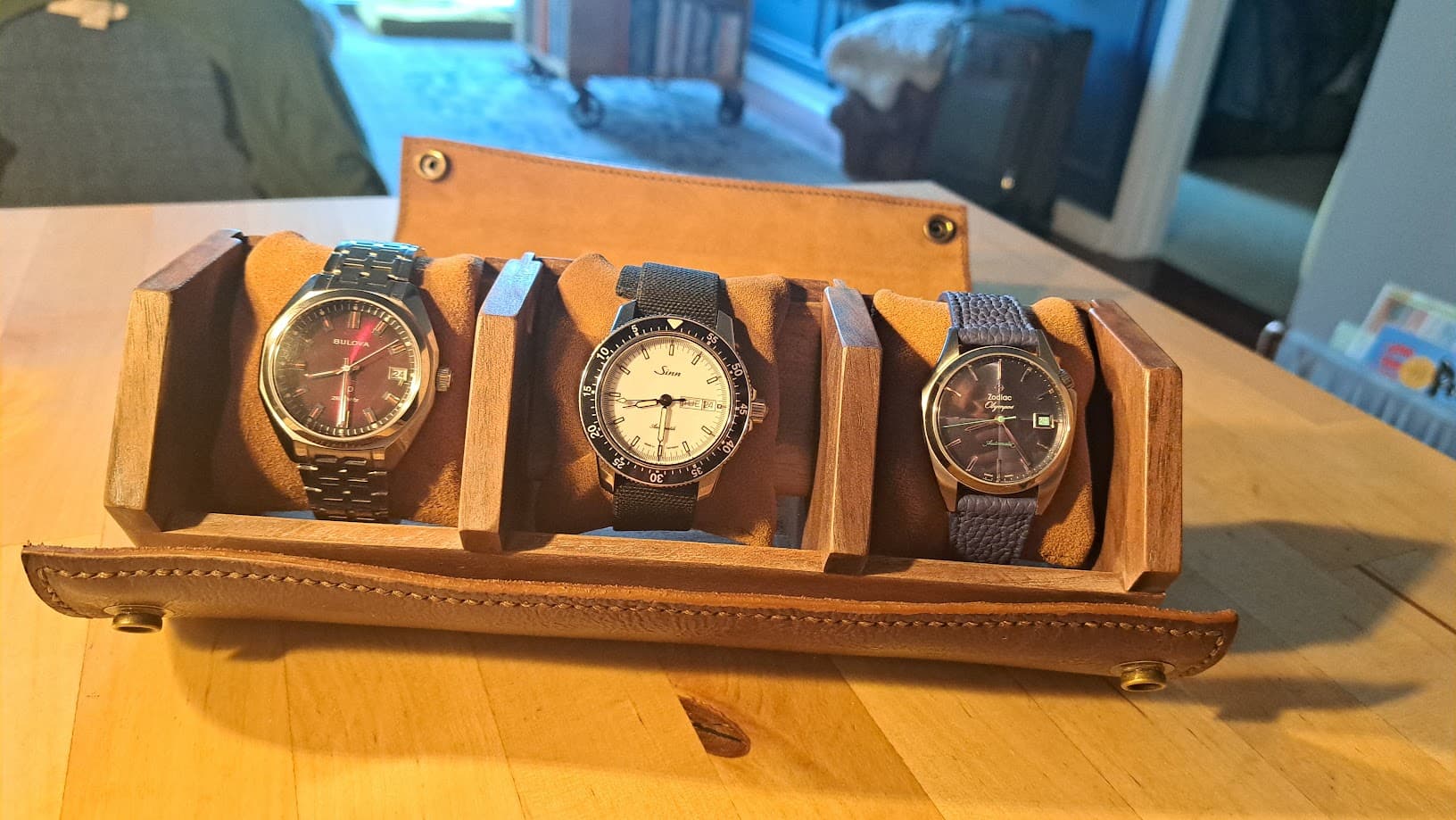

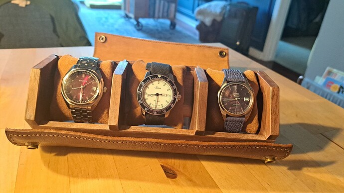

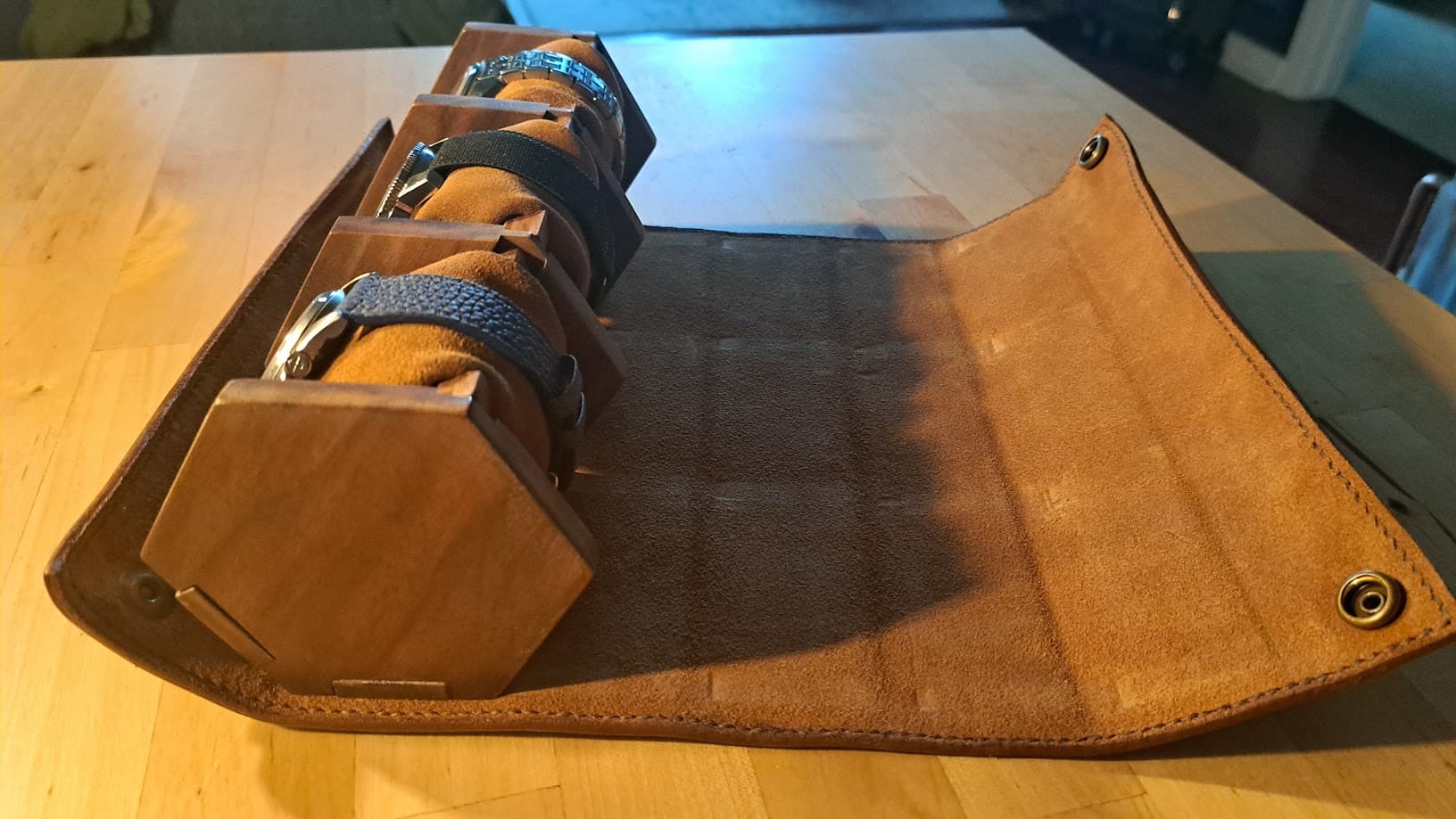

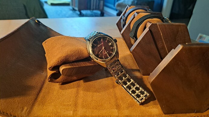

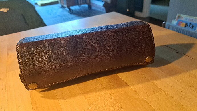

Finally – finally! – calling this one done. It took a back seat to several projects over the last 6 months (no maker has ever had that happen to them) but I made a point of wrapping it up recently.
It’s a travel case for watches: the inner structure is made of walnut, the outside roll is buffalo (?) leather lined with suede and reinforced with stiffener material, edges are painted, and the cushions are foam wrapped in suede. Strangely enough, it was the cushions that took the longest to figure out.

WOW, just WOW! I’m in awe of your talent @Branislav Your work is impeccable, stunningly beautiful and so creative. I’m so glad you post these projects as they continue to inspire me.

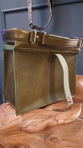

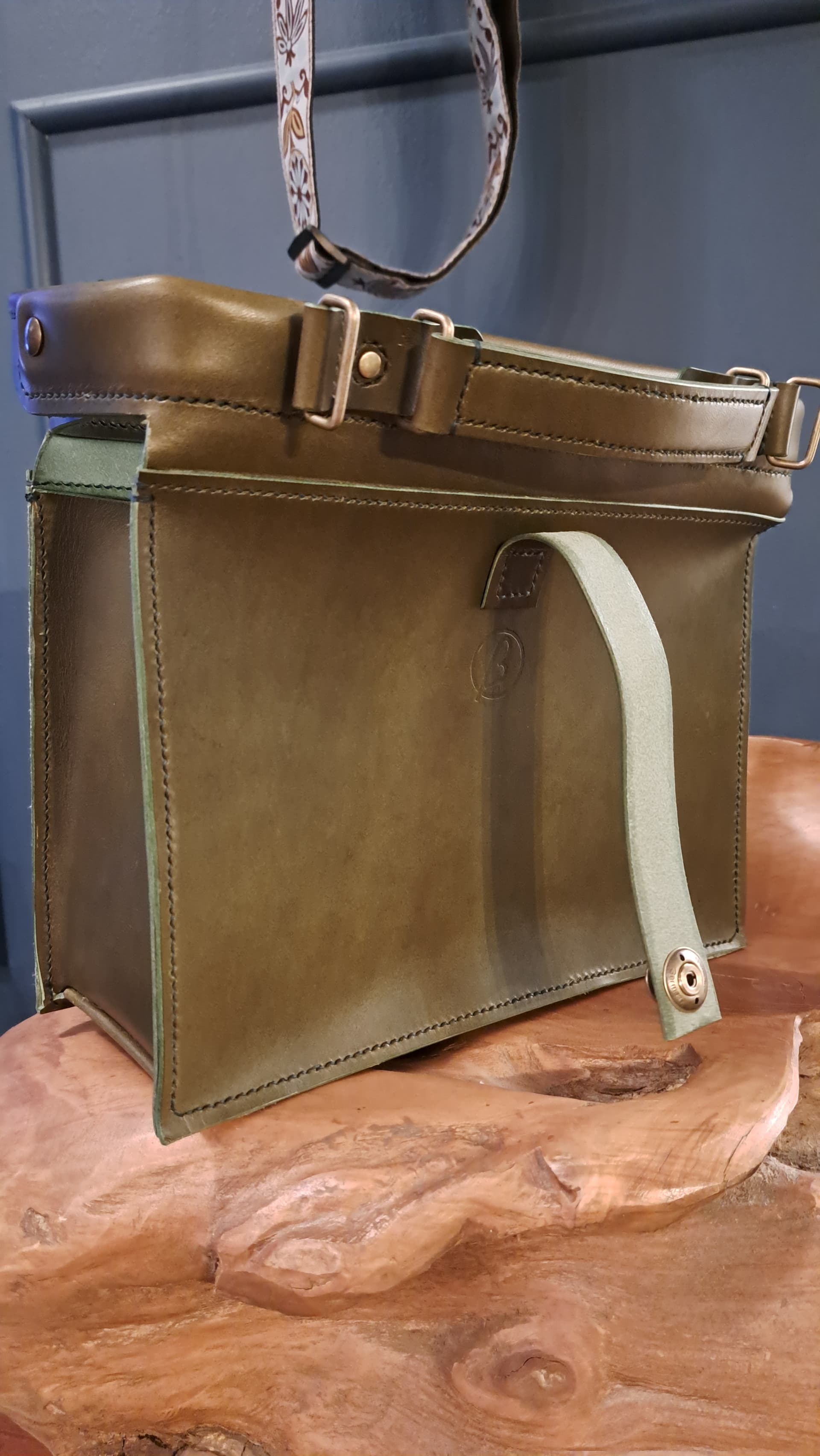

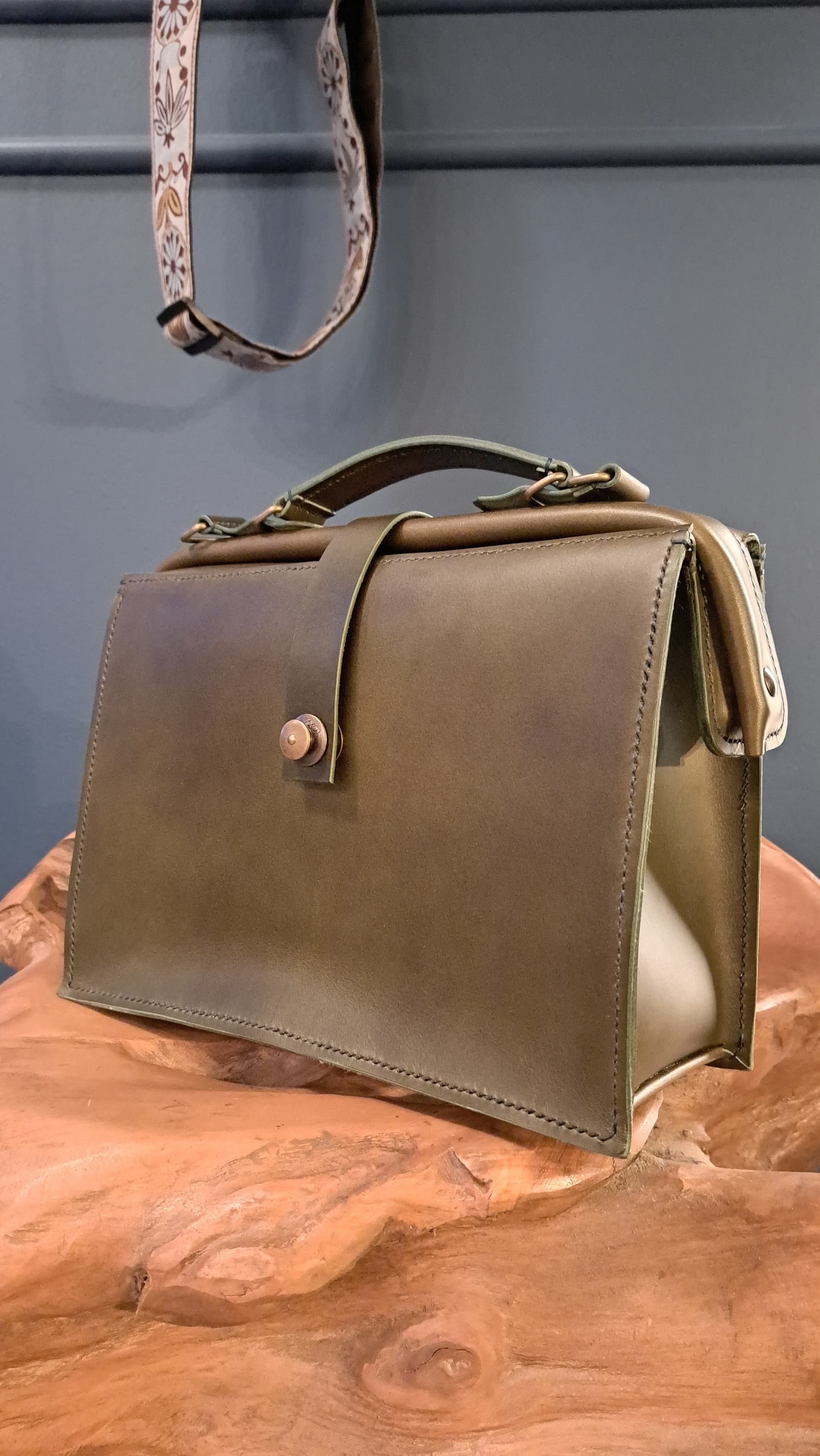

You may have seen me in Textiles making a bag with some gorgeous Buttero leather and here is the finished* product: a small, old timey doctor-style bag with antique brass hardware, measuring about 10.5" x 8" x 4.5":
And a video: https://i.imgur.com/RTHQkHV.mp4
*I’ve yet to hammer down the stitches and make the shoulder strap but shhhh
Joining the panels to the gusset was way trickier than I expected so the corners and edges are an absolute casserole, but I’m OK with it.

You are a leather artist! Very very nice
Beautiful as always Bran. And for what it’s worth, I think the corner casserole looks delicious.

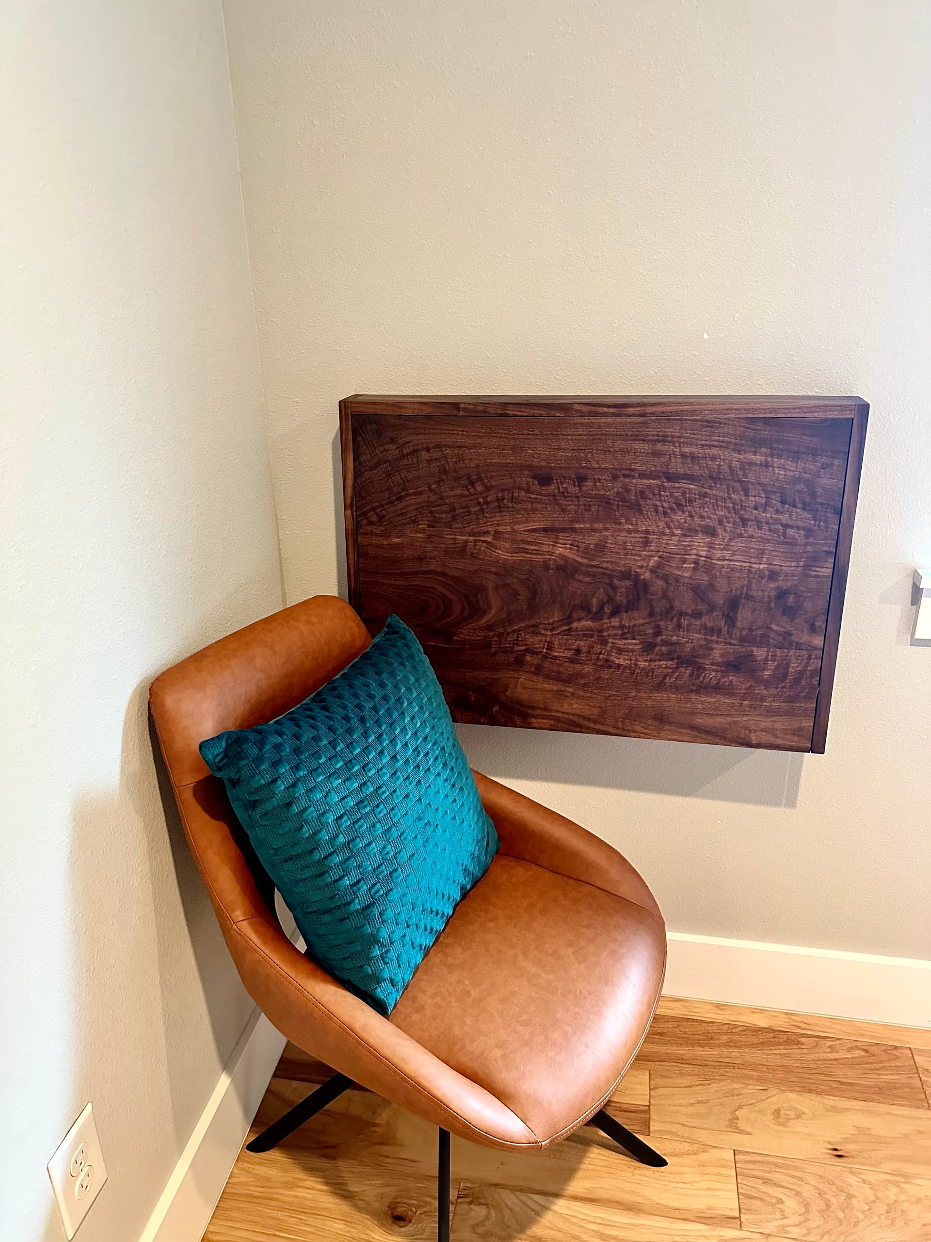

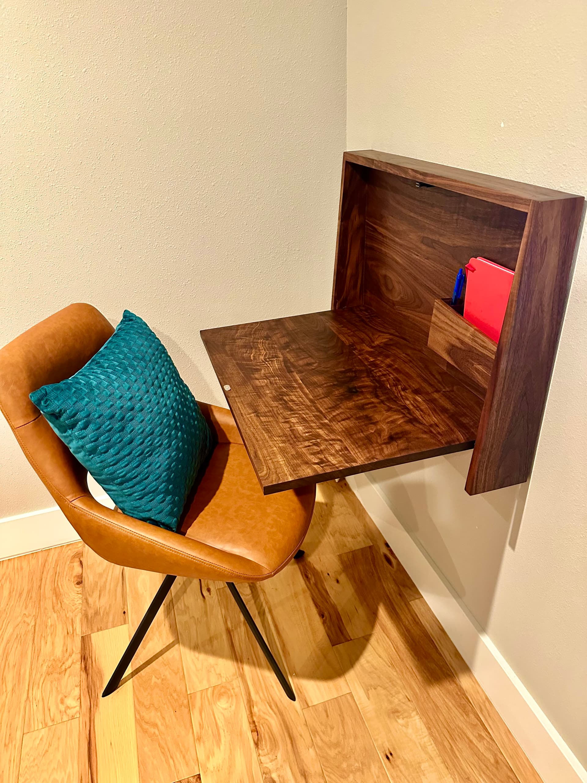

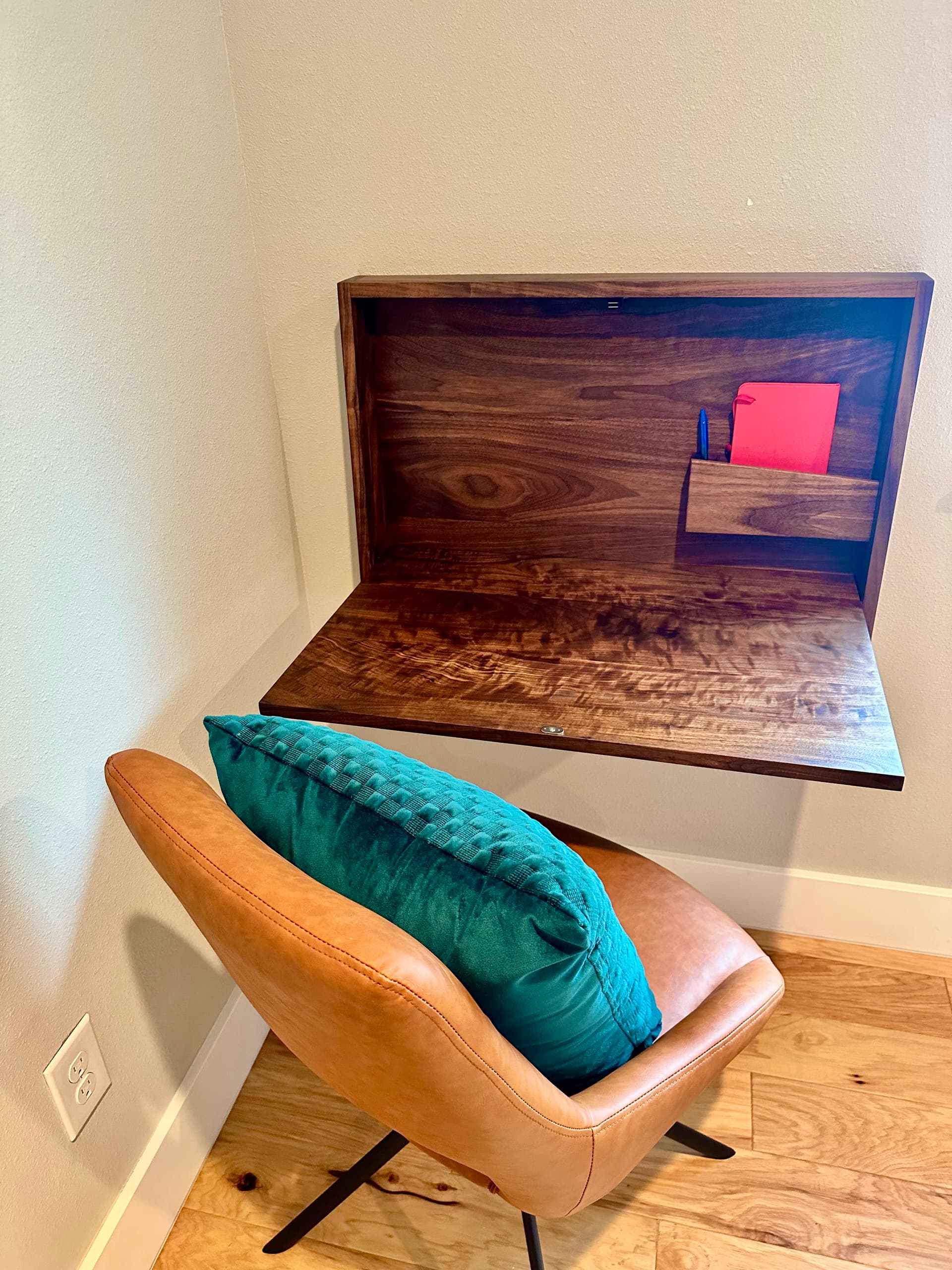

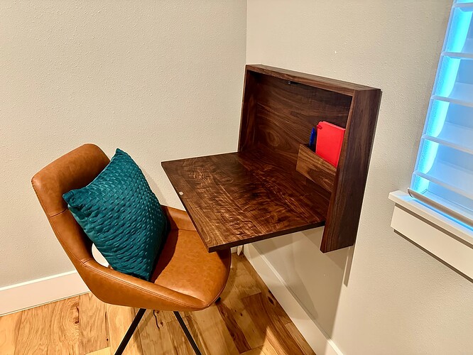

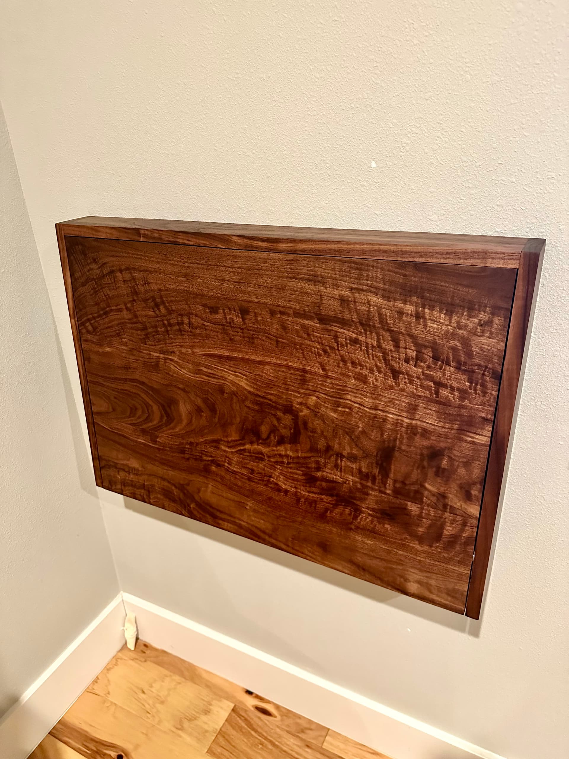

I finally finished this one! It is a “Murphy Desk”. Hopefully it holds together :slight_smile:

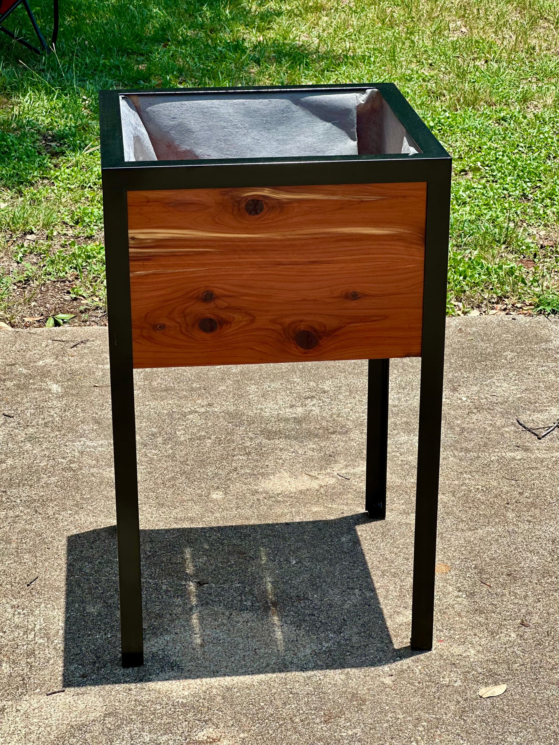

I also made this planter:
