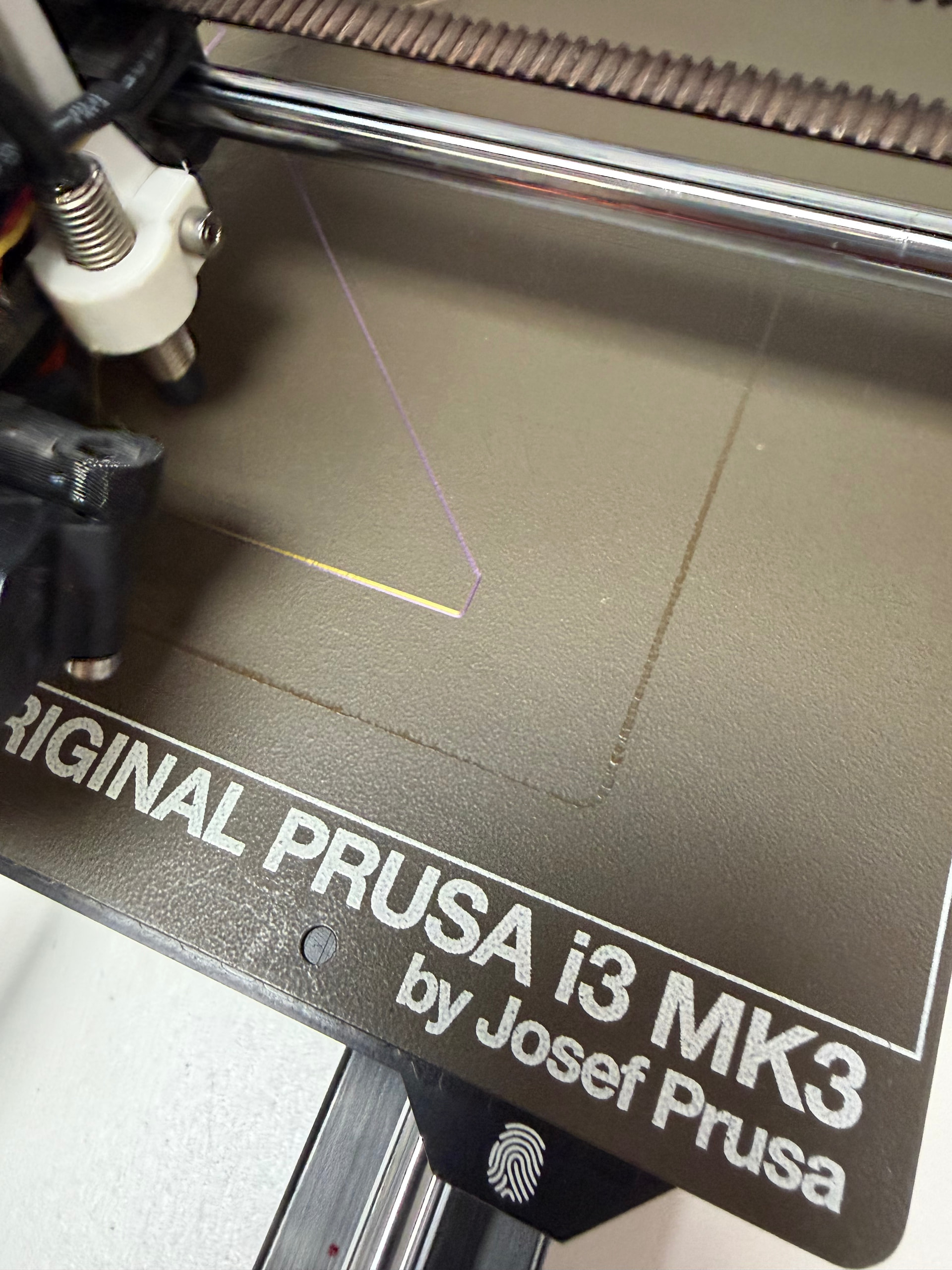

I did some test prints on Hermes this evening. I noticed a couple of problems: the sheet was set for Custom1 even though the Satin sheet was on the printer, and the Z height was set to somewhere near -2.7mm. This was low enough that the first layer was being ground into the plate.
The outer line in this picture is at -2.7, the inner is almost a whole mm higher.

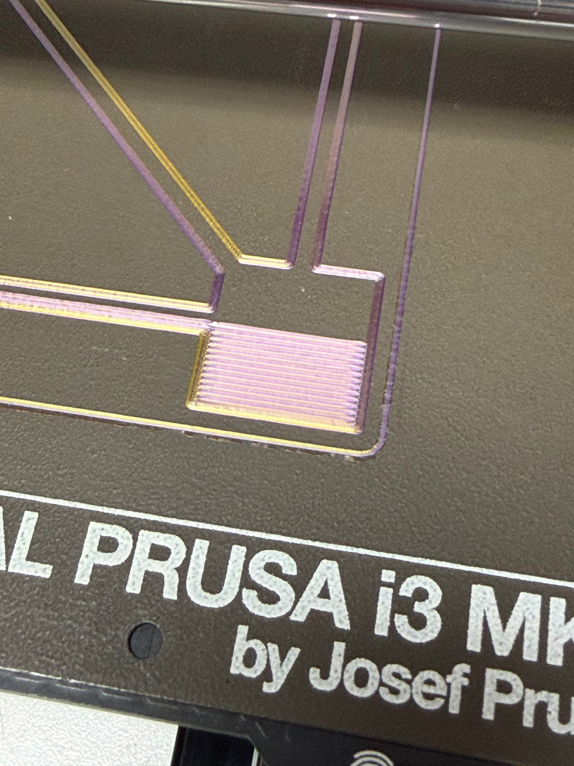

this is what you’re looking for on a first layer:

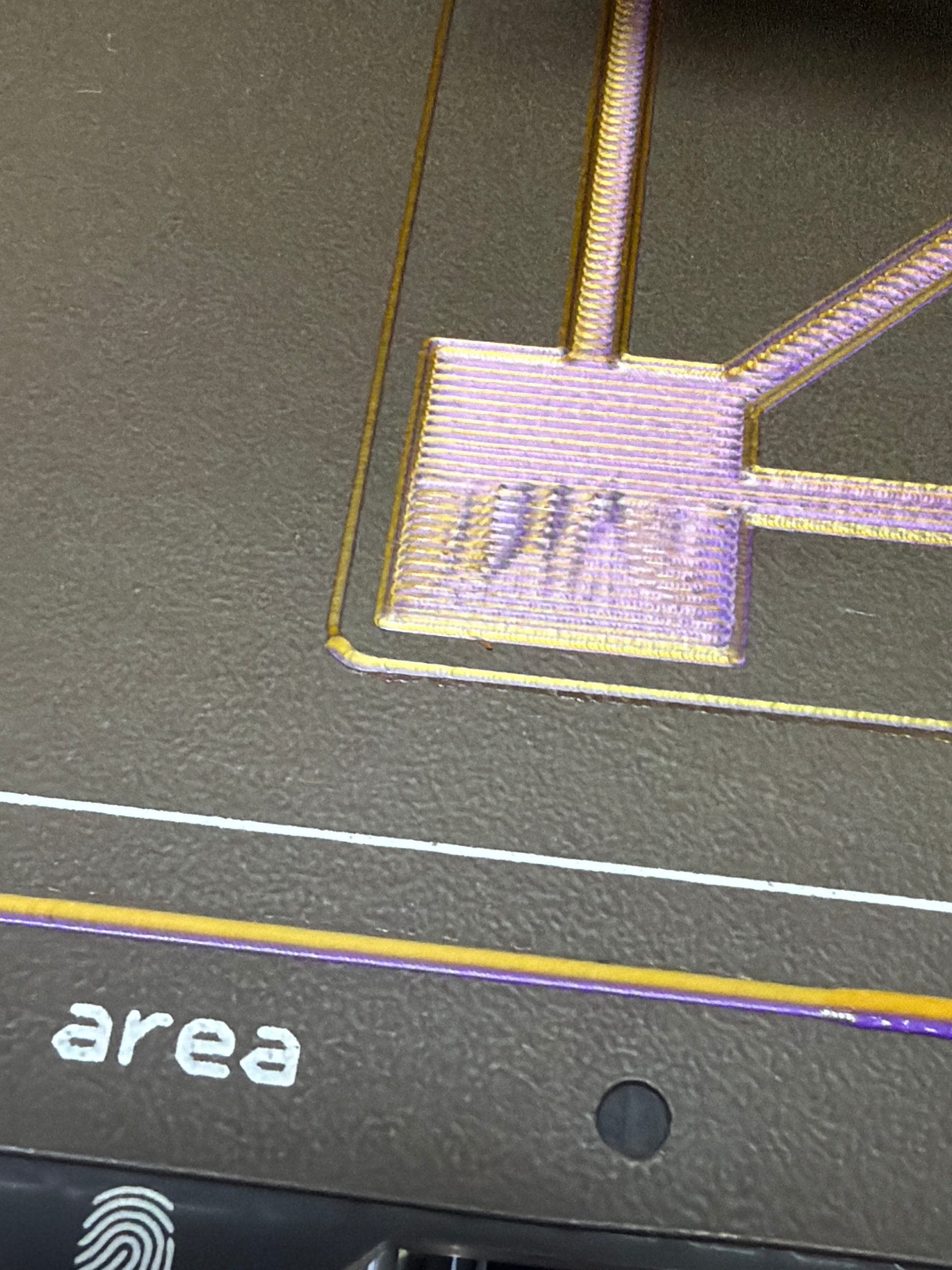

If you see wrinkling like the lower half of this, the height is too low:
