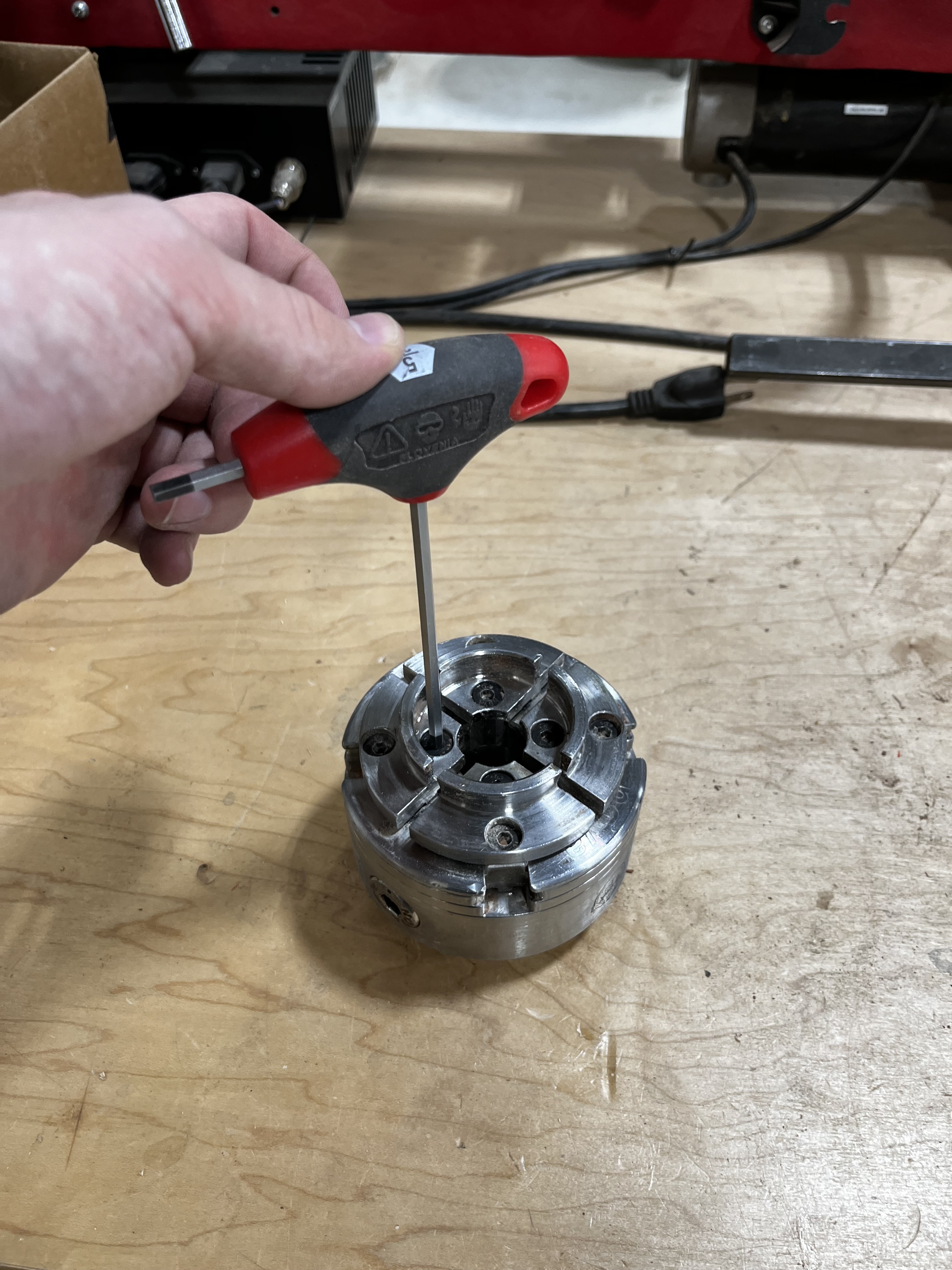

Sorry I missed this! These smaller Allen keys in the drawer can be used to remove the 8 screws on top and switch out the jaws. I can try to track down a video on the jaws.
I can also try to help if you tell me a little bit more about what you’re trying to do with the jaws!

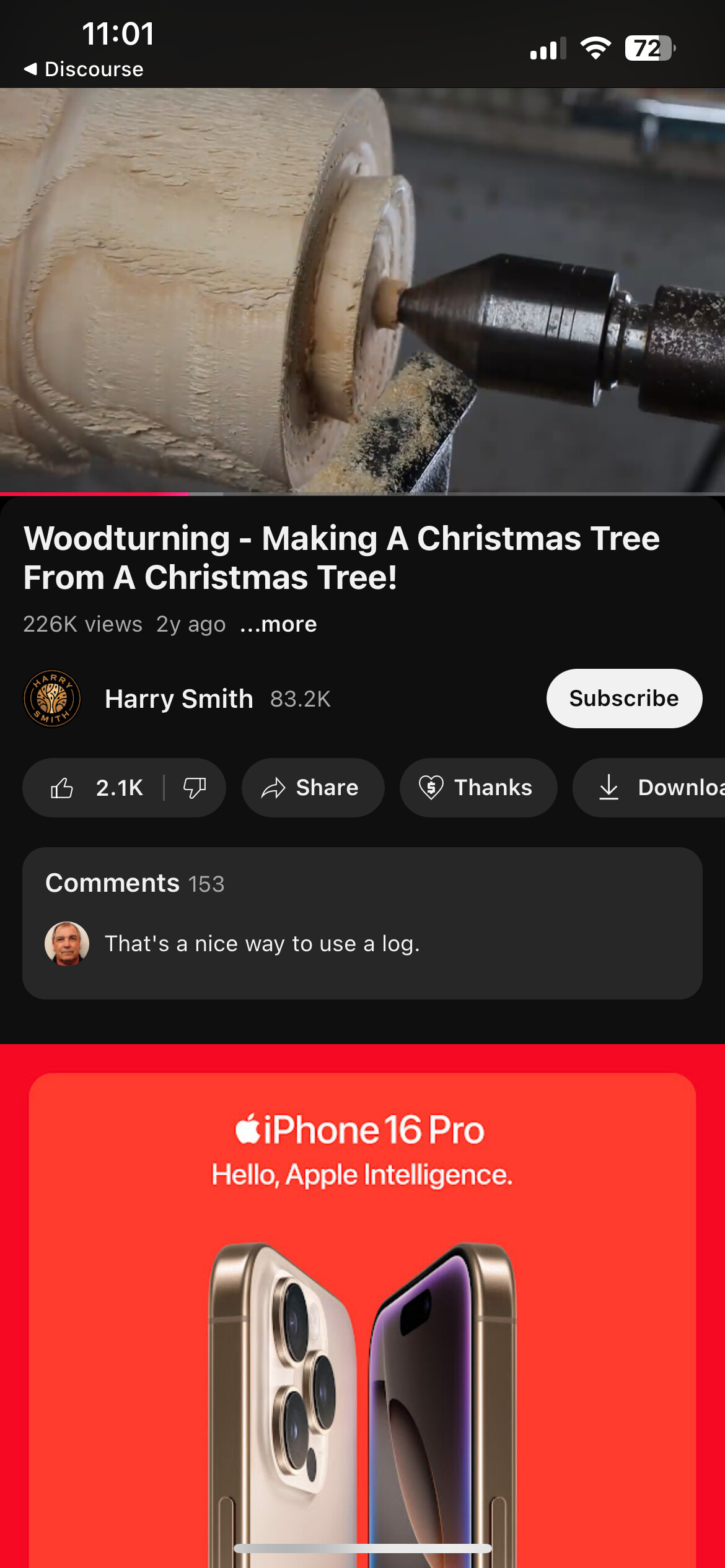

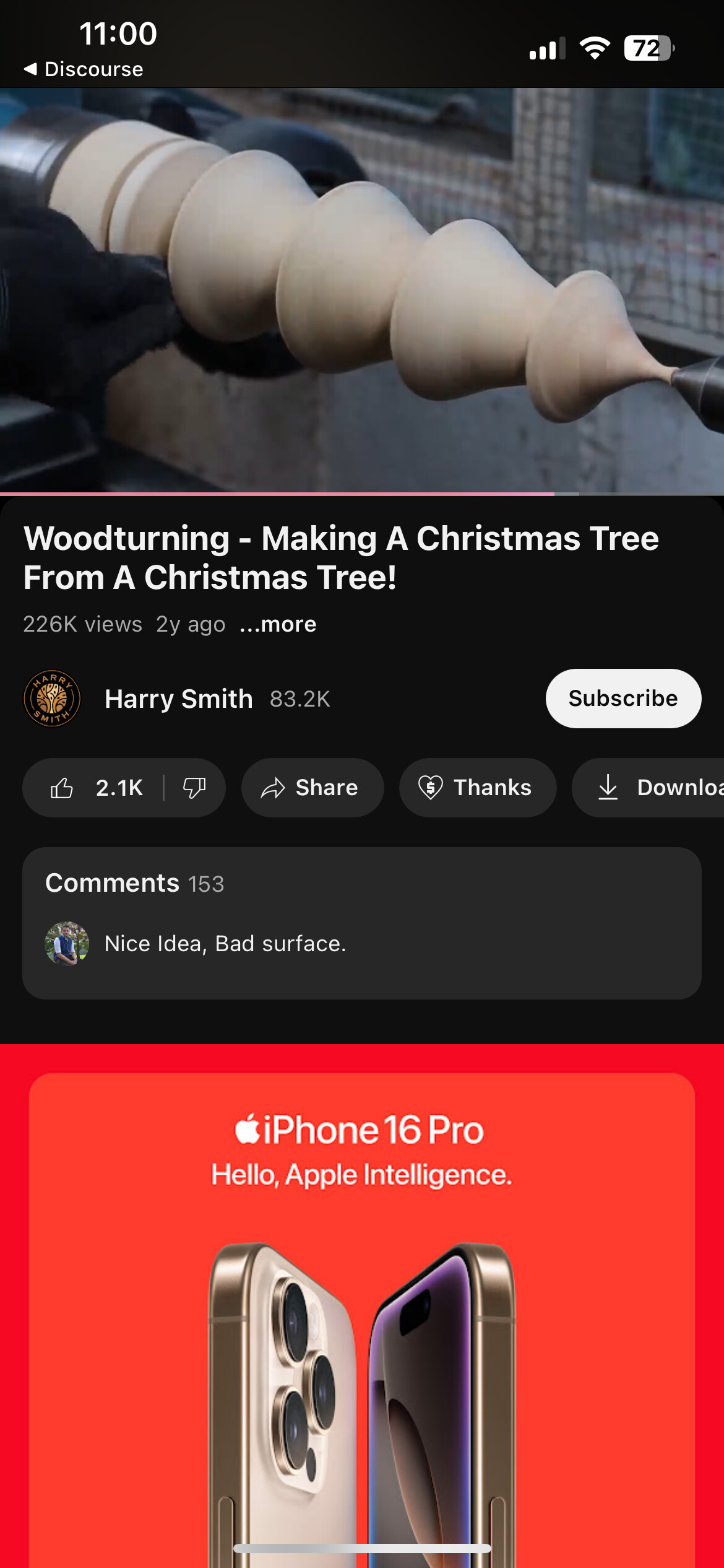

I was trying to make Christmas trees out of some scrap wood I had lying around, something like this video: https://www.youtube.com/watch?v=l6fqqZK1N7U (but only ~6" tall).
That wasn’t the original video I was referencing - the one I saw initially only used the chuck, and didn’t include the backstop. The wood only sat inside the jaws about half an inch, so it wasn’t very stable (and started wobbling as soon as I turned the lathe on). In most of the videos I’ve seen, it looks like you want at least an inch or so of the chuck to grab onto the wood.
If you’ll be around the shop sometime later this week, I can come in and show you what I was trying. Otherwise, I’ll just try to grab some pictures/video next time I go in. Thanks in advance for the help! :slight_smile:
Ok cool! I would probably use the jaws in my picture above to clamp down on it. A few things I’ll suggest:
  1. I’d keep the tail stock on as long as possible, especially with something this long. Bowls can do fine with just the head stock mount, but anything that extends more than about 5-6 inches from the head stock needs a bit more support in my experience. You’ll see in that video they leave the tailstock in place up until the last second before finishing.
  2. Also, you’ll notice they put a slight inward/downward angle on that tenon. That will help pull the jaws into the piece and align it. I would recommend replicating that.
Hope those things help! And @Rolo is great at woodturning, I’d be curious if he has additional suggestions that I’m missing.
