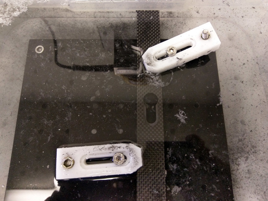

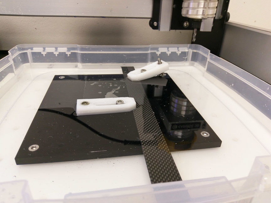

I would like to buy or build a water bath that you can mill CF immersed inside of it to trap the dust even better than using coolant.
