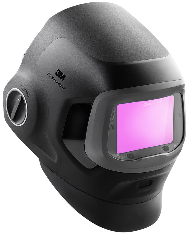

  • I can’t afford $1500 for the Google recommended 3M mask.

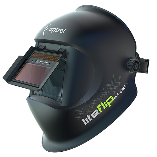

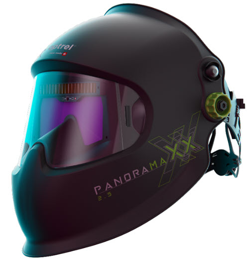

Optrel has this feature (and maaaaany more) for a $3-900 price point, depending on other features.
This is the one I bought three copies of for my kid, wife, and I.

I like speed glass helmets. They have darkness controls that are easy to use.
Large visibility.
