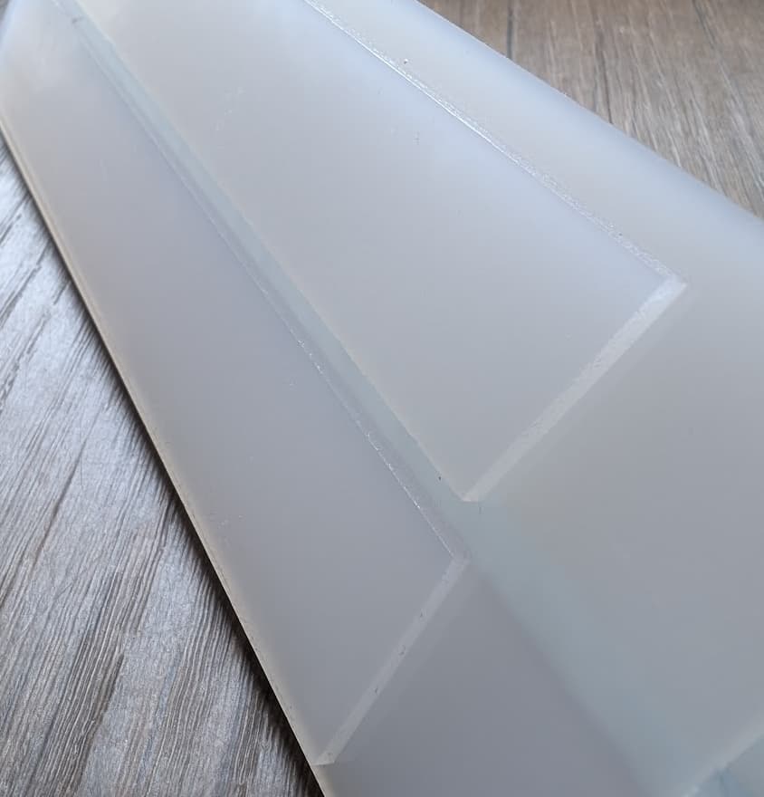

I knew that it was meant to weld acrylic, but was not expecting the strength I got from just resting a piece of 6mm acrylic on its edge and adhering to another scrap perpendicularly.
I assumed that it would surely snap right apart with such a small amount of surface area, and being 90° (no clamps or weight, I just pressed firmly and walked away)
But the bond is so strong, that if I tried any harder to break them apart I would need to put on some eye protection because it would take quite a bit of force.

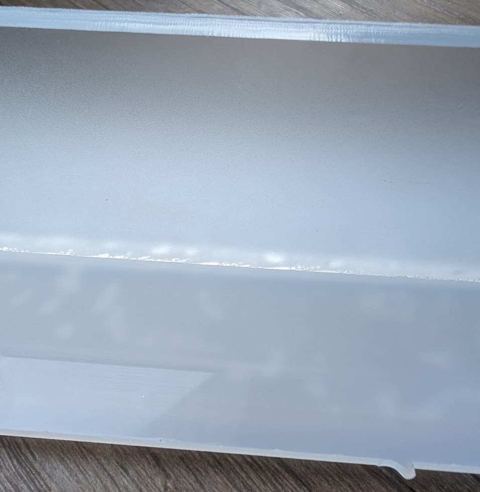

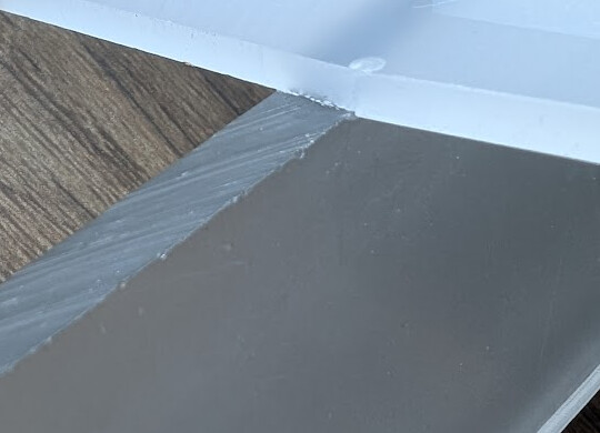

You’ll notice that the acrylic looks to have been cut with a table saw or something on the edge that I bonded, so it had a little texture, but was very smooth to the touch.
You can see air bubbles underneath, but that was from gluing other scraps surface to surface, and not clamping or doing anything to mitigate the bubbles, so those were to be expected. Oh, and some of my spills are being hidden by the frosted texture, so next time I would be prepared to clamp and wipe my surfaces after application.

EDIT: It came off with just a little bit of mechanical help, and it was clear that only the high spots bonded, so it’s not as miraculous as I thought, but still promising results.
