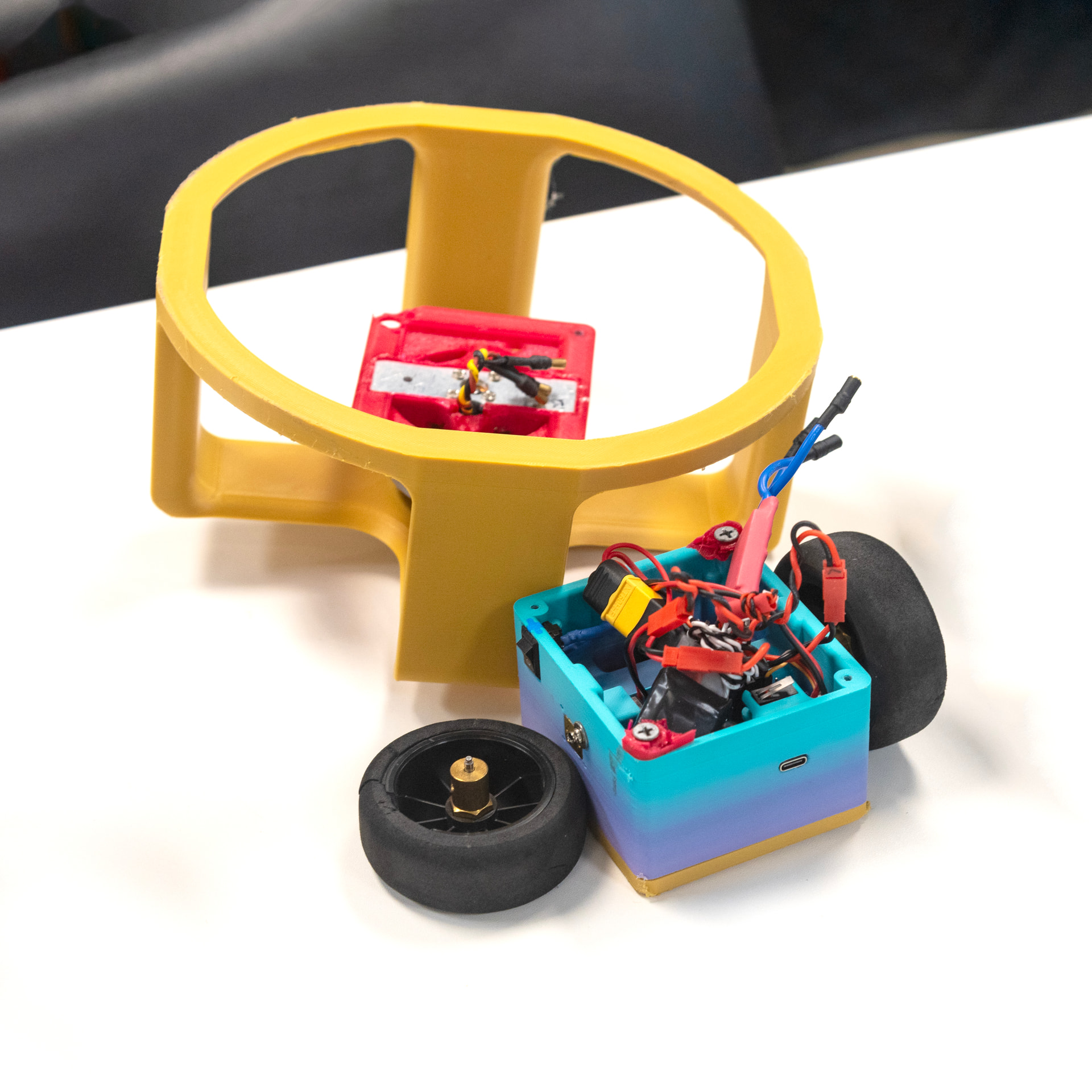

That’s a very good question and I think it depends on your preference. I tend to start designing the body and trying to put those weapon ideas in CAD, cutting them out of cardboard or even a tupperware… whatever works for you.
Doing this will force you to figure out your motors, motor drivers and controllers. The sky is the limit, so you could just go and buy a small RC car or whatever this thing is so you can hack it and control it your way.
If you need ideas in terms of parts to buy, you could always buy some of the same components we use in the Weaponized Plastic Robot Workshop, but again, it is a creative process, so you can go a in a completely different rout if you like.
Would you want to share your initial idea and see if we can help you figure out some of the components?

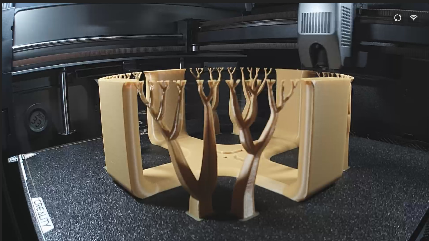

I am printing a new weapon tonight and will start working on my laser pointer guided controller tomorrow

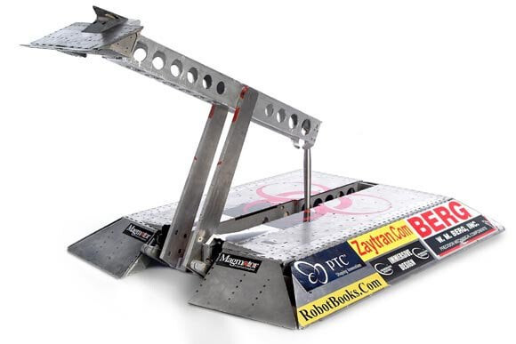

the best example i could find already existing is a battlebot named BioHazard. my plan is to build a bot with a low profile and wedges running around the body. tucked at the front of the bot is a hinged arm that will act as either a flipper or a lifter, depending on how its development goes. its wiki page seems to provide a few leads on how it was assembled, but there isn’t much detail. my guess is to begin by designing the overall shape of the bot.
That is one cool Weaponized Robot!
I’ve never built a robot with such potential energy, so I imagine you would have to reinforce some parts with metal in case it is spring loaded, but as long as they are exposed or used to get in contact with the other robots, I think you’ll be fine.
My friend made Up and Down last year and it uses a similar idea, so we could ask for advice in case you need it.

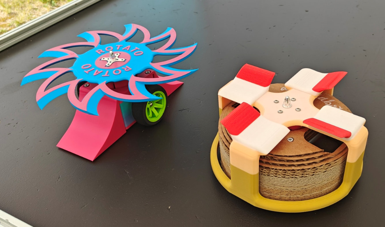

Hello all!
I don’t want this to sound like a threat, but we have already built 8 ROTATOs that are (probably) ready to fight again as soon as their builders repair the damage from their very first little “friendly discussion,” so I’m hoping to start seeing more Weaponized Plastic Robots around Asmbly that are not just ROTATOs soon :grinning_face_with_smiling_eyes:
We just wrapped up another successful workshop last weekend that ended with 3 happy builders… and my own robot looking like it lost an argument with a lawn mower.
We’ll have a new S.I.G. meeting on June 11th, right after the official WPFL competition in New Hampshire, so there’s a very real chance I’ll show up with even more broken robots and questionable engineering decisions by then.
A few of you have been asking where we source parts to repair or upgrade your bots, so I’ve started compiling the list of components we use during the workshop. Whether you’re rebuilding a ROTATO or designing your own Weaponized Plastic Robot from scratch, these parts should help cover most of the essentials.
Most of the links are Amazon affiliate links. They don’t change the price for you, but they do help support the project a bit. Some of those funds will go directly toward building the arena so we can have proper fights where only cheap robot parts are at risk.
So now I’m curious… I know a few of you are building creative controllers for Rotatos, but is anyone already building new Weaponized Plastic Robots? What kind of ridiculous ideas are cooking in your CAD tabs right now?

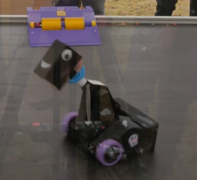

Greetings from New Hampshire! :robot:
Two rotatos made the trip to compete in an official Weaponized Plastic competition this weekend, and we’ll be streaming the event starting around 11:00 AM Austin time:
https://www.youtube.com/watch?v=wCc2mgZ0Zls

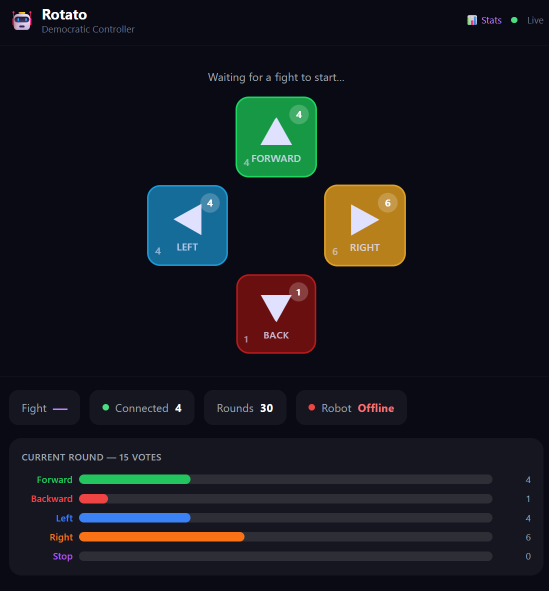

WE NEED YOUR HELP DRIVING A ROBOT.
One of our ROTATOs is competing as a Democratic Fighting Robot. Instead of having a single driver, the robot follows the will of the people. Every few seconds, the internet votes on what it should do next, and the robot obeys.
Asmbly can make history in this year’s WFPL! https://democracy.thehomelab.dev
The other ROTATO will be driven by Kaitlyn, one of our workshop graduates, who has equipped her robot with a weapon that looks significantly more dangerous than my engineering judgment would normally recommend.
If you’re around this morning, tune into the stream, help guide the Democratic Robot, and let’s see how far crowd-sourced combat strategy can take us.
