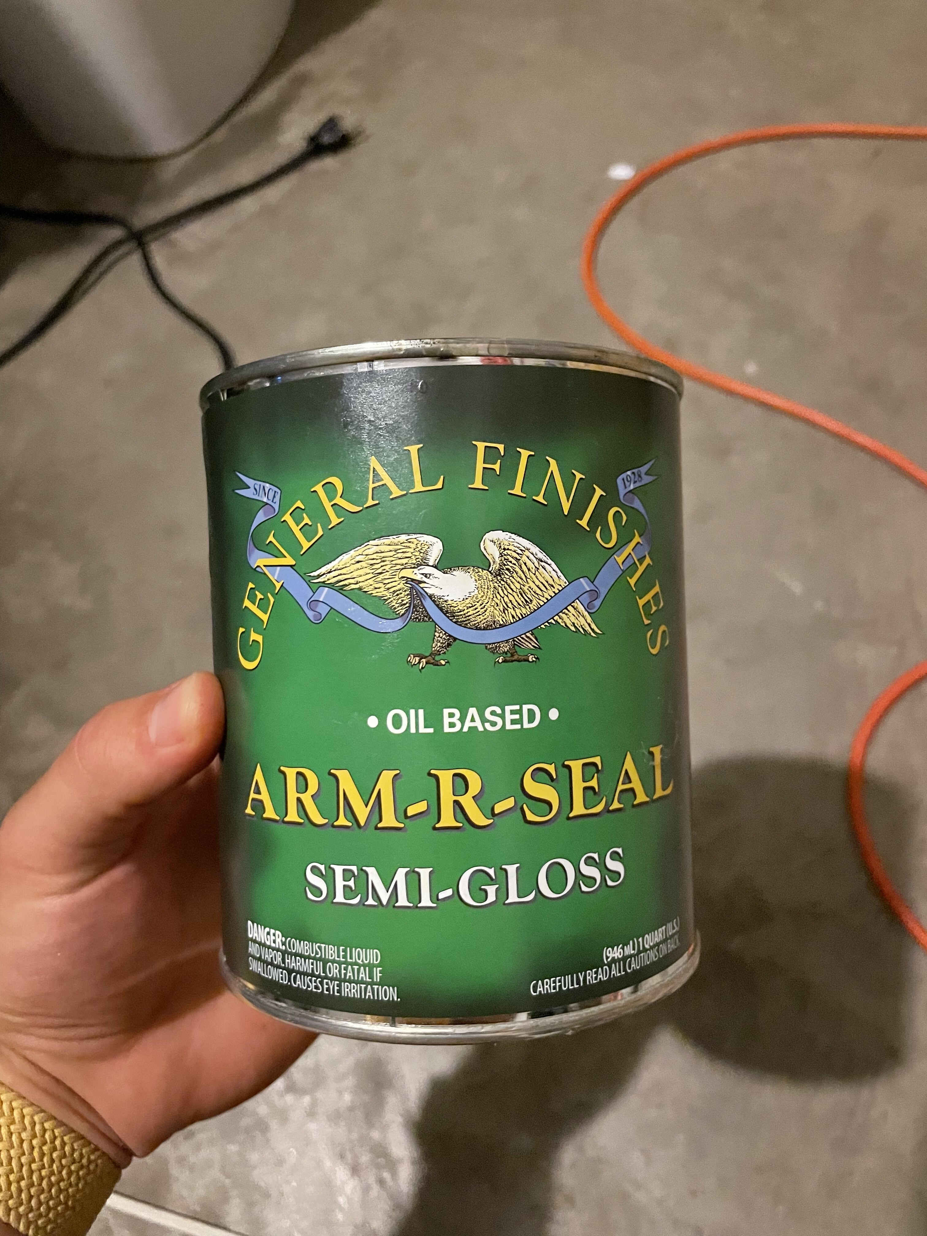

This is my favorite for natural finish!

This is good tutorial on Armor-Seal.
My second favorite part of this video is watching Matt’s grooming transformation. I’m always surprised by how many viewers miss this.

I used clear wood grain filler and shellac on the walnut desk I made awhile back, I think the post is somewhere here. I may have also used arm r seal? It has been awhile so Im not entirely certain.
Personally I really like the result, but the grain filler was honestly a pain to use.
