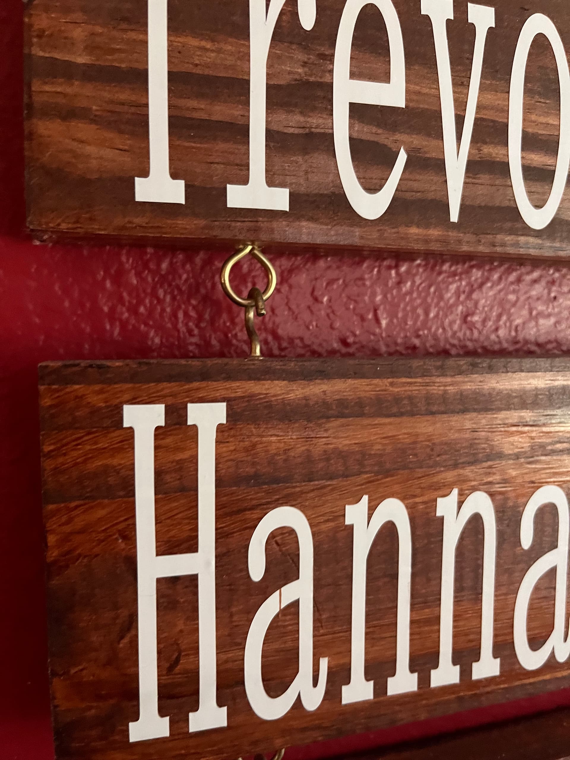

Is anyone familiar with or know about using vinyl lettering? I have a small commission to create similar pieces as in the picture. I’m having trouble finding premade vinyl lettering and believe they were originally custom designed by the maker. Would I be able to possibly use the laser to cut letters from adhesive backed vinyl? Or should I look for a shop that specializes in making these? Any advice would be awesome!
