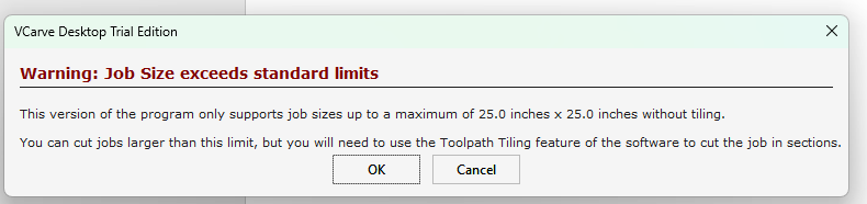

I’m trying to setup VCarve at home with my makerspace account. I had this setup previously with 12.0, however when starting it up today I was prompted to go install the latest version.
Now that the install is done, I’m on version 12.504 and I get this error about Job Size Exceeds Standard Limits. It seems in this version I can only create something 25”x25” or less or it will start “tiling”.
  1. Did I miss something in my setup? I’m logged in to my account that was registered to the makerspace edition. (at least I think I did).
  2. I downloaded the machine configuration for the Laguna Swift, although it only has an option for the 4x4 model.
  3. What is “Tiling”?
It looks like the Laguna Swift 4x4 is limiting you. And I assume if we can find the Laguna Swift 5x10 config it would work as before. But that’s just a guess.
I was hoping that would do it, but when I updated the dimensions to 4’x10’ in the configuration, it still doesn’t like something over 25x25
I’ve been advised this could be related to an issue on Vetric’s side. Are you installing this on a laptop Robert?
So, historically, the job size limit has been something VCarve enforces on Desktop / non-Pro editions of VCarve. I have a personal license for the Desktop edition of an older version (9.5, so I admit it’s quite out of date now) and it displays that dialog.
Just noting that as an FYI in case it helps with troubleshooting. I haven’t entirely caught up with how Vectric handles the Makerspace licensing workflows in more recent versions.
FWIW, “tiling” is essentially what it sounds like: VCarve is capable of splitting large toolpaths into smaller physical tiles that are cut in separate sessions. Sounds like a monumental hassle that I’ve never wanted to experience in person. :cowboy_hat_face:
It sounds like you have the trial edition and not the asmbly makerspace license. The smaller size is a telltale limit of the trial edition.
Finally getting back to this. It seems I did in fact have the “Desktop” version downloaded instead of the “Trial” version.
Downloading the “Trial” version, then signing in, I’m good to go!
Thank you everyone, and kuddos to @SteveW for calling the exact issue out.
