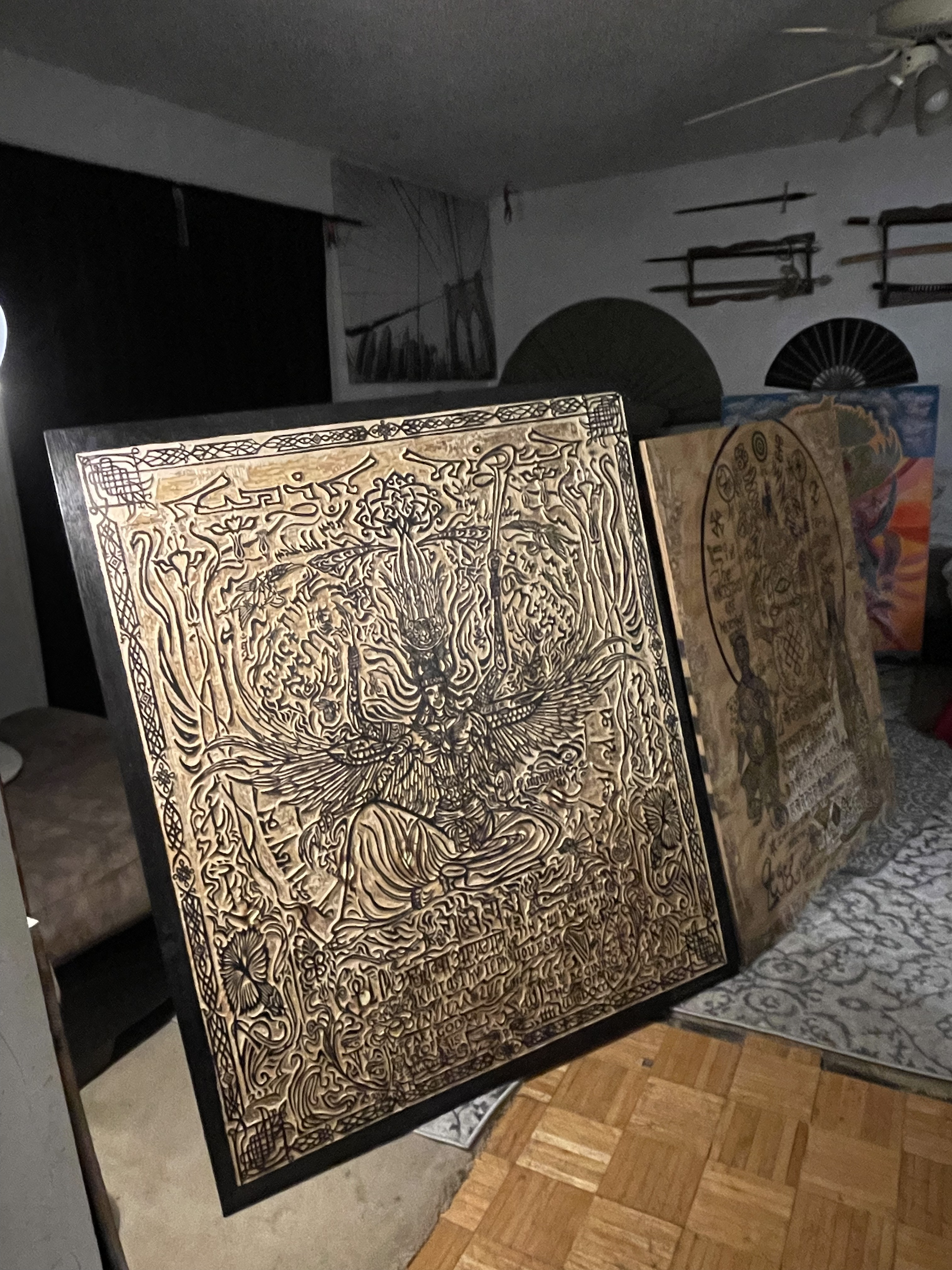

Asking for help to anyone who thinks they might understand my dilemma. I’m used to carving intricate Mandala woodcarvings by hand, I recently took the cnc router class, but still cant figure out how to properly cut this Mandala out. Any suggestions? My tool paths were too much for the system and crashed every time. Thank you in advance
