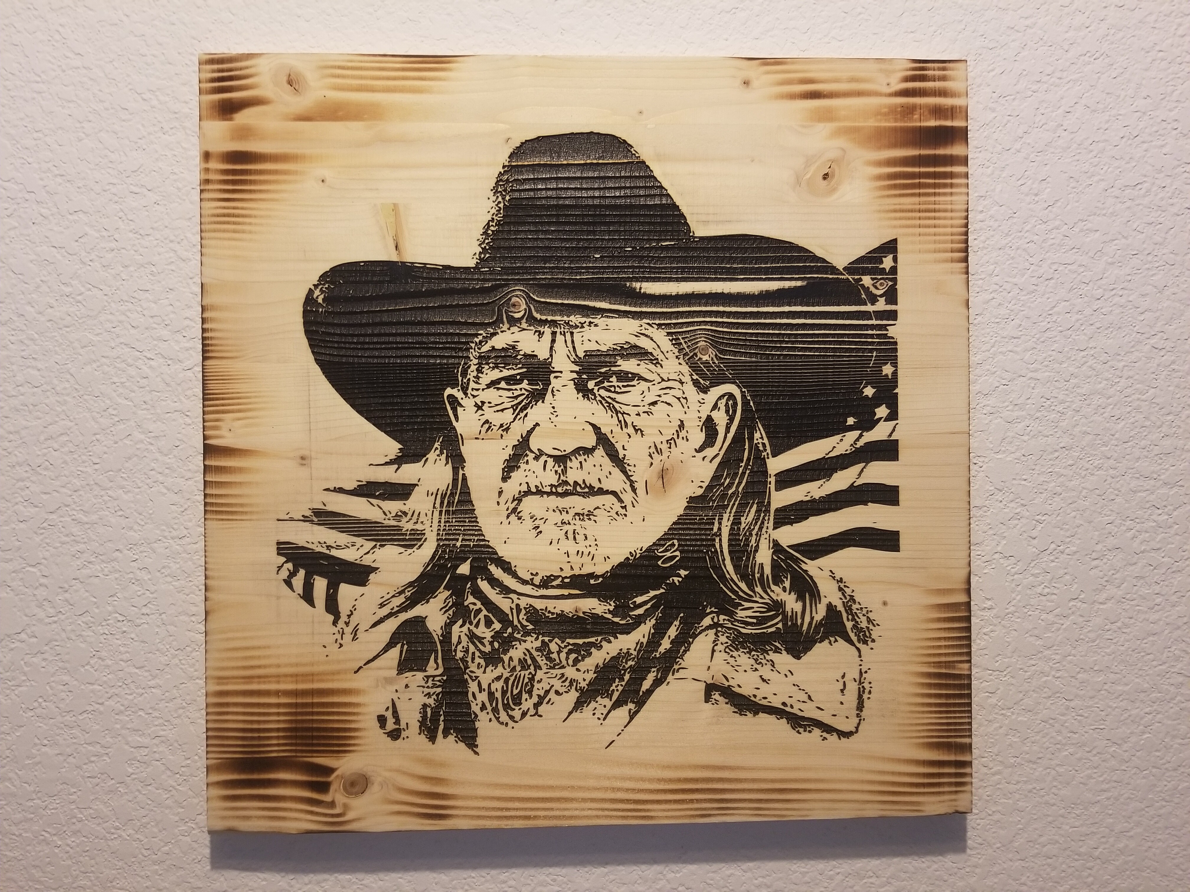

I have a question for people who has experience with using acrylic paints for wooden pieces
Here’s an example of what I do:
Material - regular wooden board from Lowe’s (probably pine)
The process:
  1. Laser engraving
  2. Coat of black Home Depot paint (I guess it’s called latex paint)
  3. Sanding
  4. Two coats of water-based poly
I’d like to add some color to it and everybody’s saying that acrylic paints are super affordable and easy to use. But is it ok to use them on top of water-based poly or just raw pine?
Pretty much all the hardcore professional artists doing something called GESSOING to prep their wood for acrylic paints which takes about a day
I’m wondering if there’s an easier way. Or maybe I should switch to a different kind of paint
Sorry if it sounds confusing or dumb. But I’m stuck in my research and would love to hear any opinions or advises
Thank you,
Cheers!
