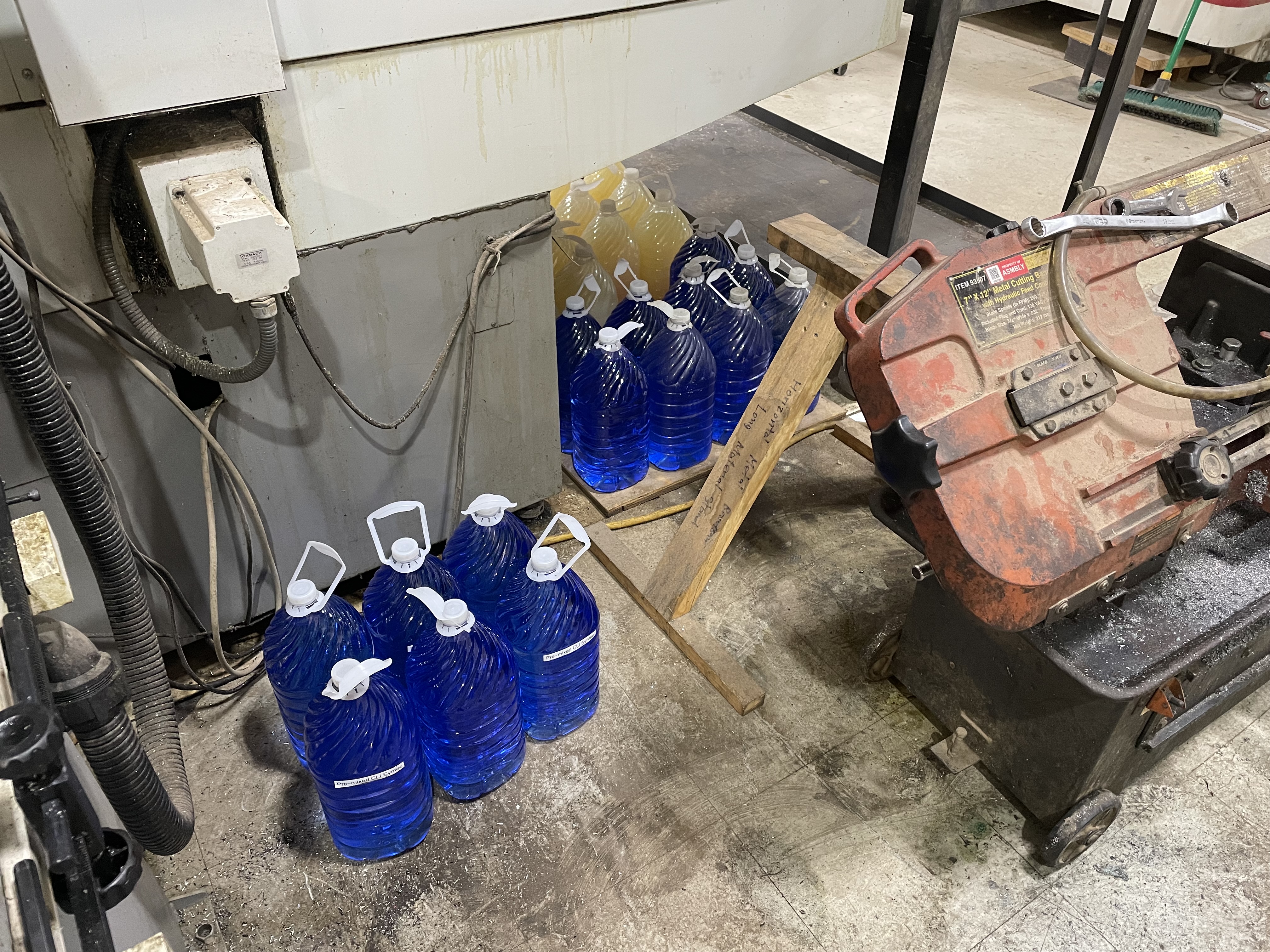

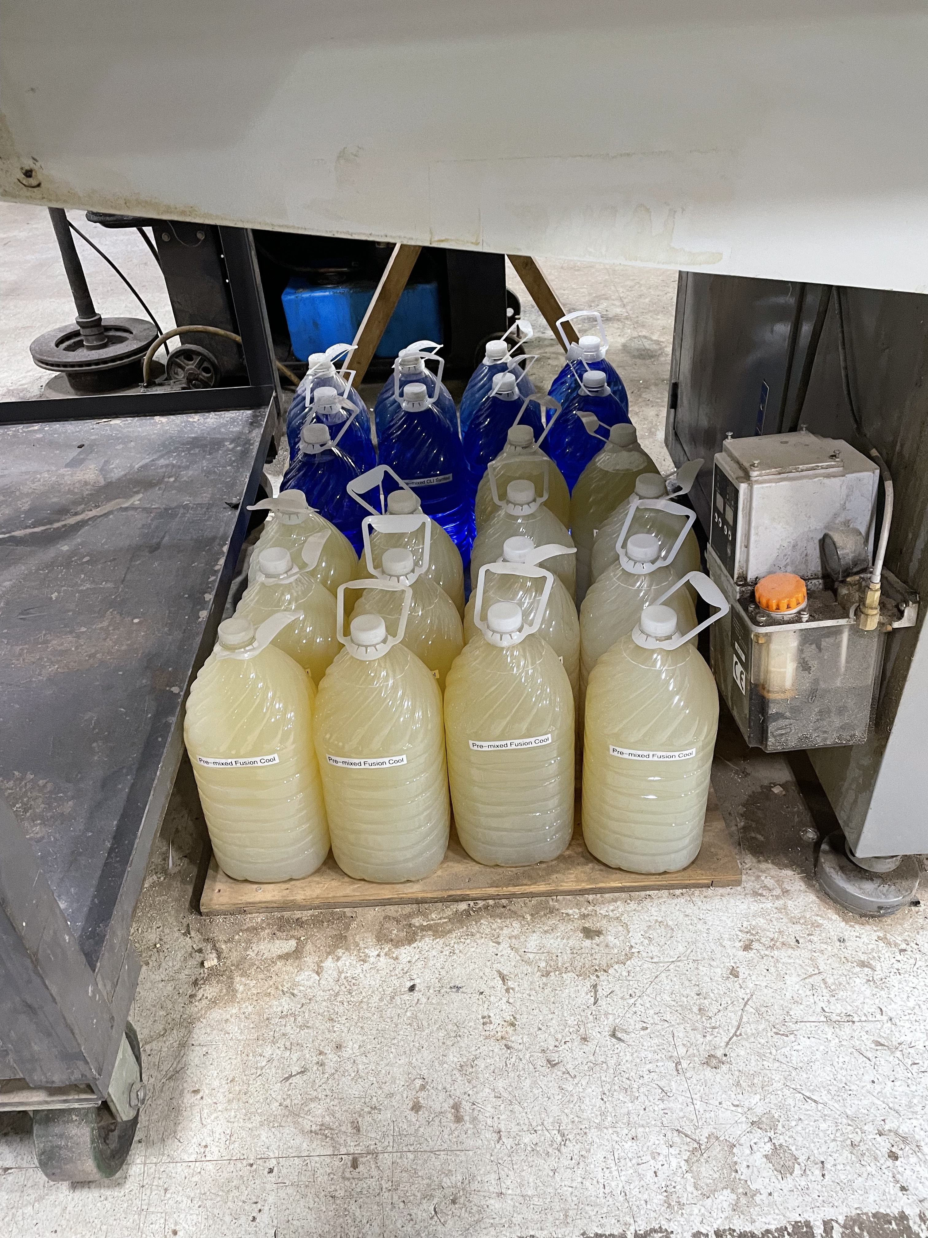

This pre-mixed fluid will be mostly stored on the shelf below the left side of the Tormach, as shown below. There will also be some pre-mixed fluid in a large bucket on the lowest shelf of the machine shop cabinet. The concentrate, mixing equipment, and most of the distilled water will now be kept in the metal shop annex storage area.

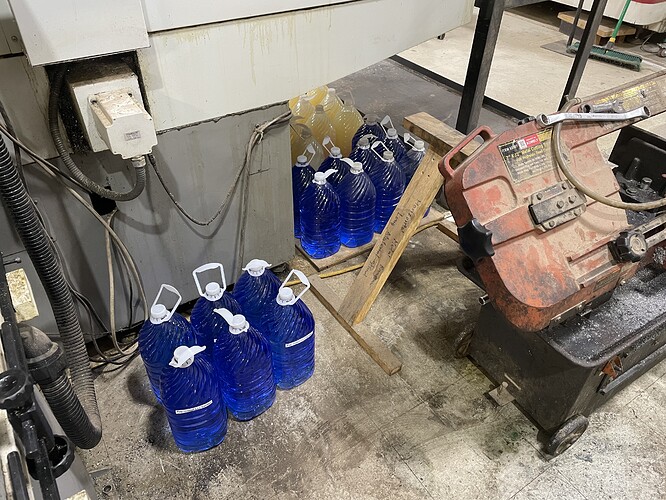

We are also pre-mixing a larger quantity of the blue CLI Syntec, storing it either on the same shelf or next to the Cold Saw.
