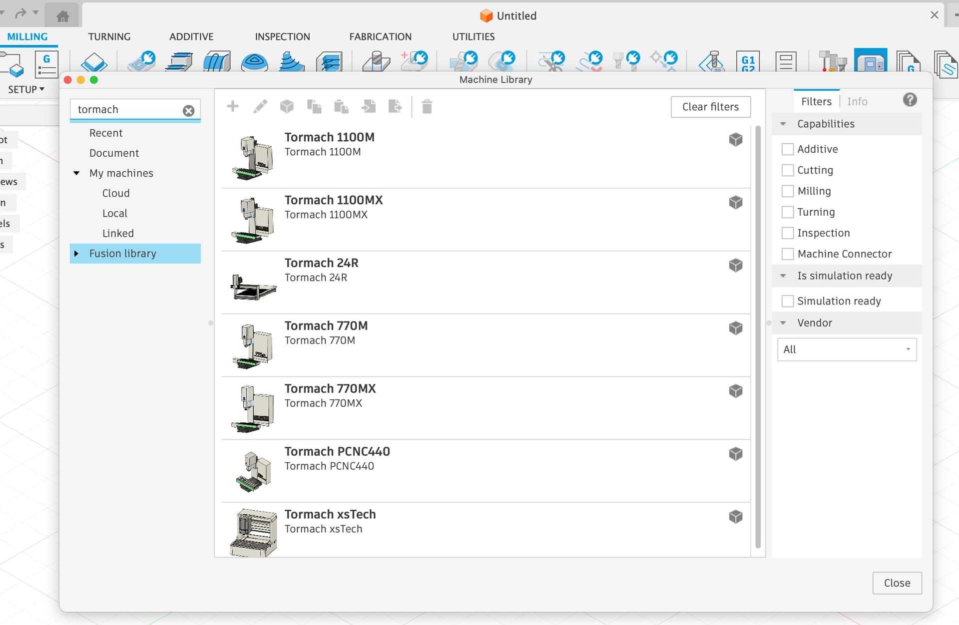

For tool settings, you should be able to search fusion Machine Library for Tormach (Tormach 1100M is closest)
This won’t get you much but it will give you some bed size characteristics that can be helpful for laying things out. There is also a tool list you can import, but I don’t find this particularly helpful https://cam.autodesk.com/tools/download.php?name=Tormach/Tormach%20-%20PCNC%201100%20-%20Starter.

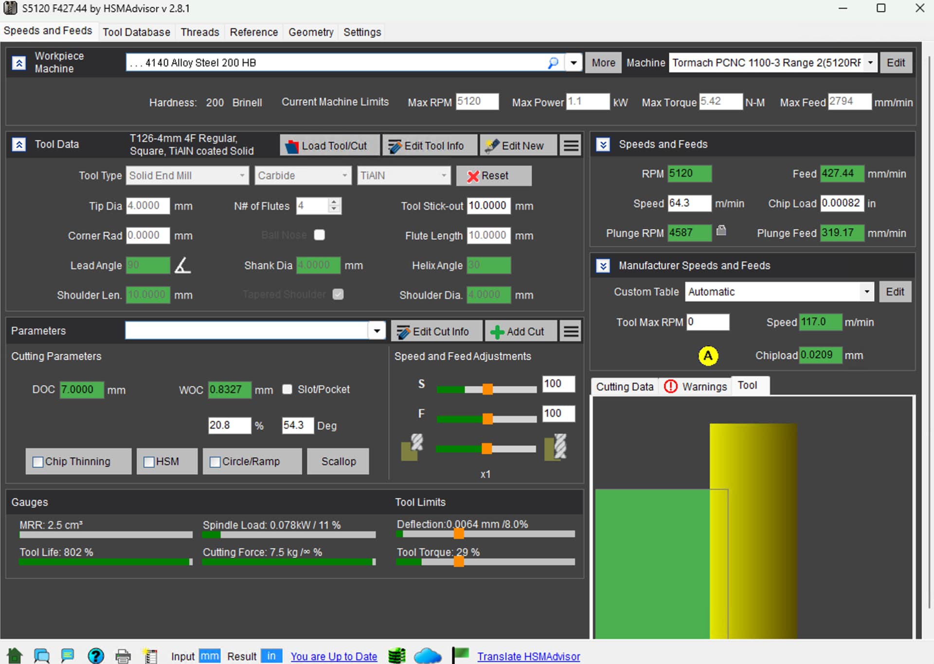

Everything else will come down to feeds and speeds. After a lot of reluctance, I finally committed to buying HSMAdvisor for small cnc. I can say, hand down, I will not load a tool into the tormach without running (and doublechecking) settings in HSMAdvisor. Clean, very efficient cuts that are calculated within the limits of our particular Tormach (PCNC 1100 Series 3) HSMAdvisor > All HSMAdvisor Licenses > 3 Horse Power Lifetime Floating License. You can probably mess around with the free version.
I have a small CNC at home that I abused for years trying to “feel it out.” I also destroyed a lot of end mills that way.
