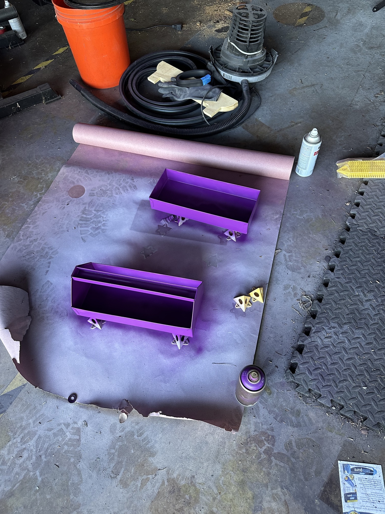

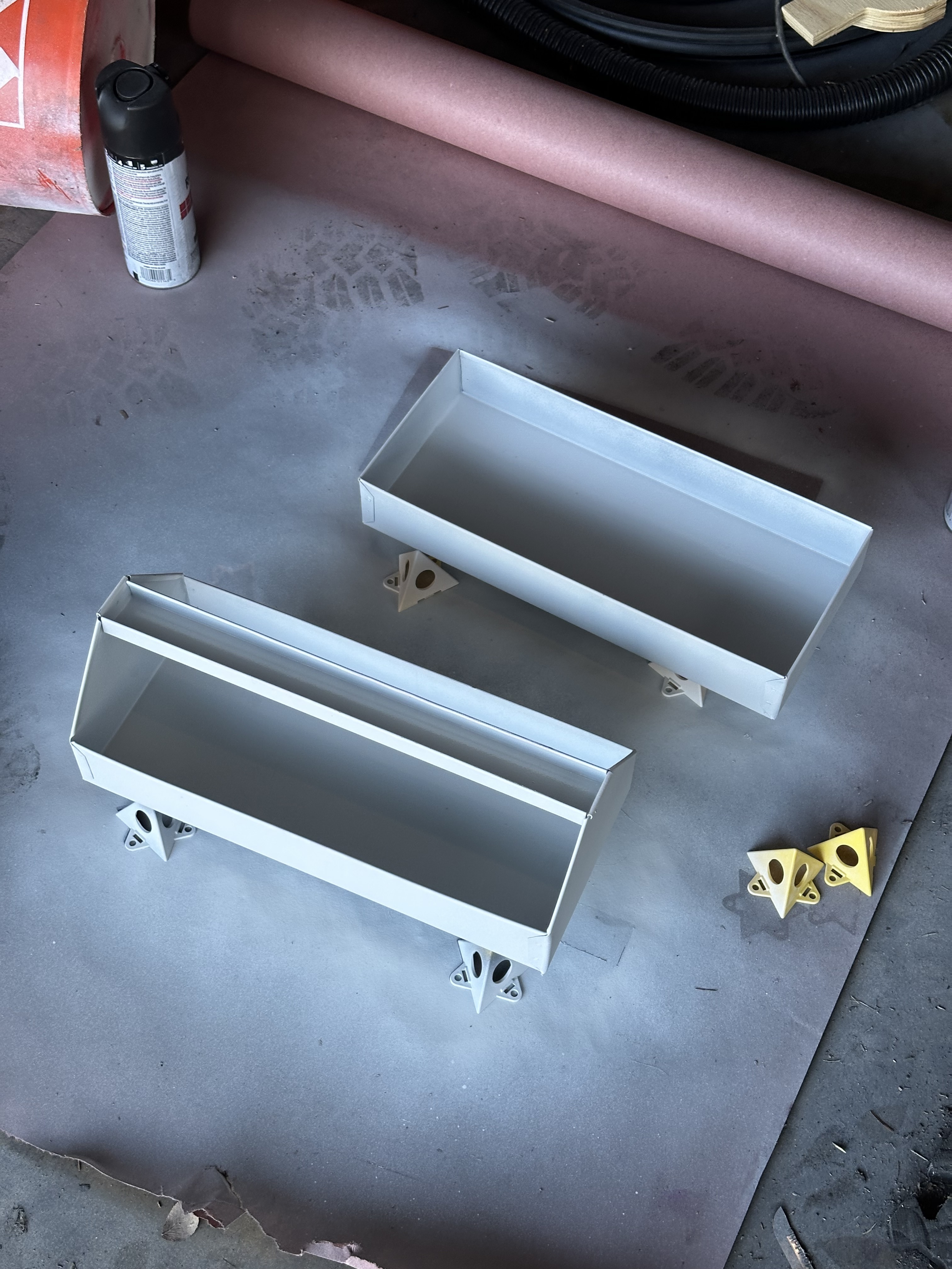

I’m taking a class at ACC where I’m making a bunch of tool boxes (Intermediate Layout & Fabrication: Ferrous Sheet Metal). What’s the best paint option for a durable finish that will chip and scratch as little as possible when actually filled with tools?
I’ve tried to research this online, but AI slop and SEO spam are making it hard to find a discussion of the options and tradeoffs.
So far I’ve put on a Rustoleum primer and some acrylic paint: Montana GOLD Acrylic Professional Spray Paints | Jerry's Artarama
