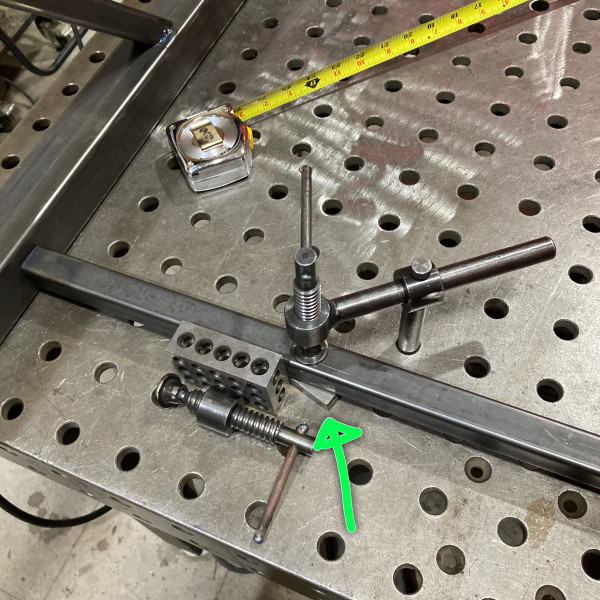

I have a plastic bag full of metal rectangles which I carry around to raise the workpiece. They’re called “TIG welding coupons” or “flat metal coupons.” There are also table dog pins in the drawer.
Good advice Aditya, and that’s crazy David! I can honestly say that’s never happened to me but I can understand how it happened. I always make sure the tables are pushed together and when I have a smaller project to have the ground on the table I’m working on, if not directly to your piece as I teach in class. It’s also been discussed to get another arc flat table to pair with the other one and those would easily be connected to each other and act as one long table. I have also gotten used to the practice over the years of making sure my piece is touching the table instead of grounding directly to my piece to avoid spatter buildup on the ground- at least when MIG welding.
