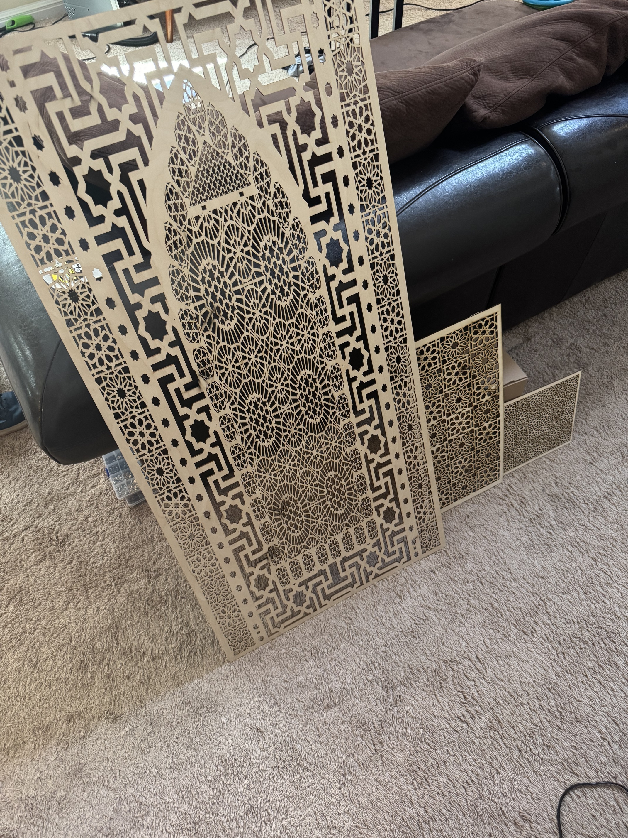

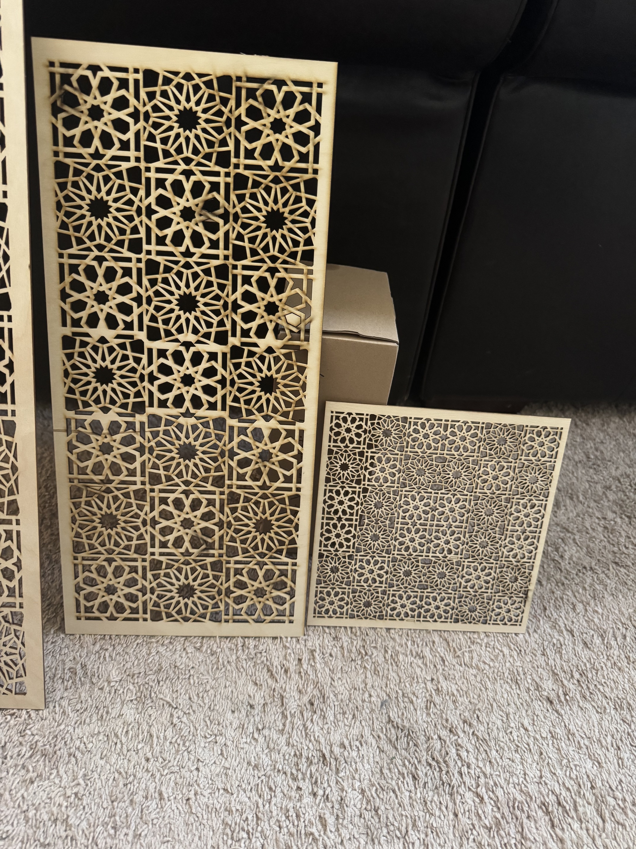

If you’ve been near the laser room in the past week, you’ve probably seen me cutting out these shutters/privacy screens for the windows in my house-

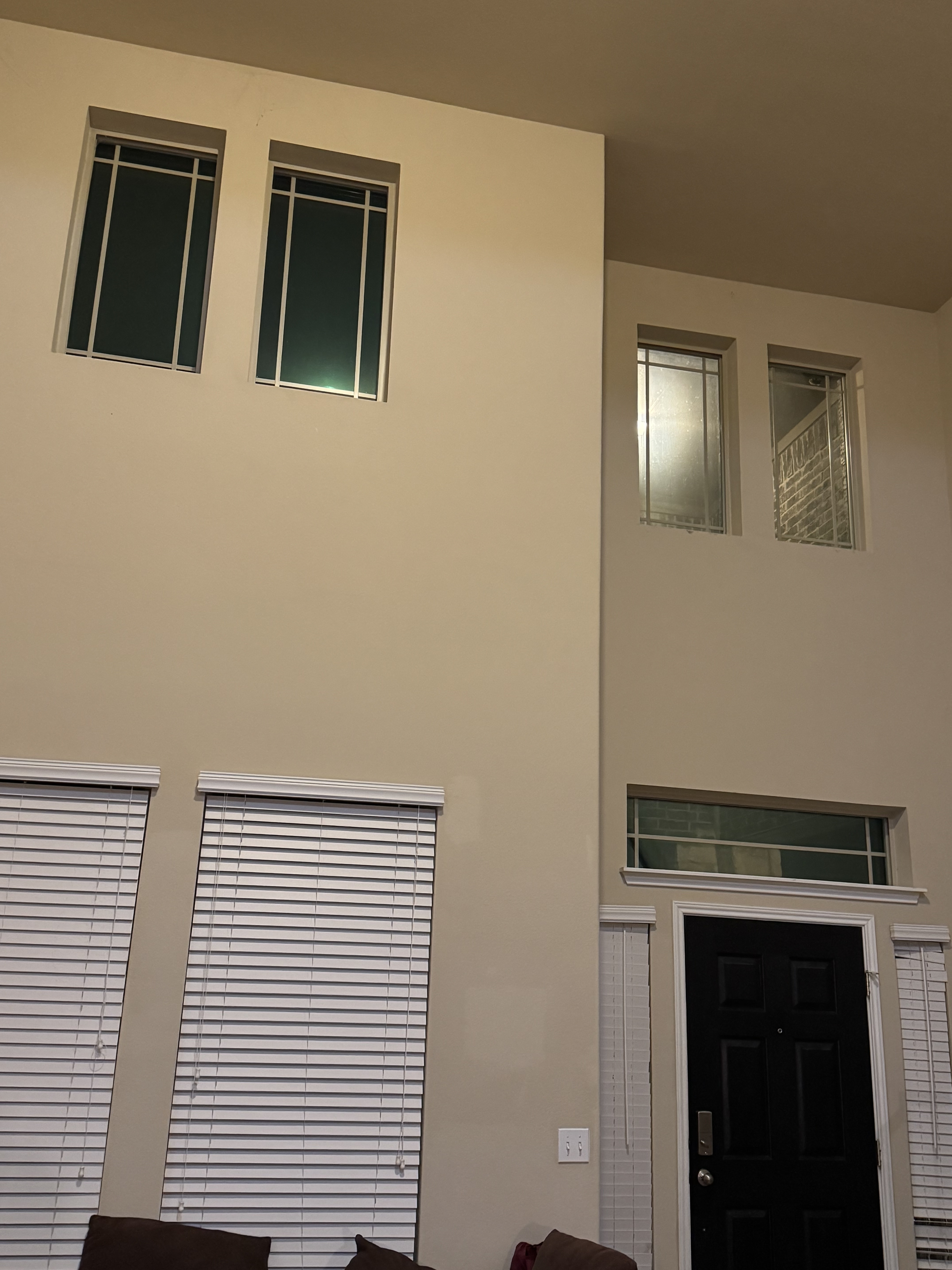

Here are the windows in question:
I’m going to be glueing two of these panels together for each window, giving me a 1/4” panel, and plan on running a grooved frame around the outside edge. I want to finish them to match my cabinets, which are a super dark brown/black color.
What are your favorite stains/finishes to use on plywood in these situations? The one caveat is that the final coat needs to be spray-able, as the detail in these panels doesn’t allow me to sand the char (and therefore burnt smell) away. Because of this, I need to use a spray capable of “sealing” the burnt internal edges.

@aneel this is a few purchased designs I slapped together to fit the dimensions I needed.
I lived in Jaipur for a while, where this type of window was “common”, but wanted a bit more variation in design than the ones there.

Being that they’ll be in the windows up high, would that matter greatly?
it depends on who has to dust them, right?
What is this thing you call dusting? :wink:
