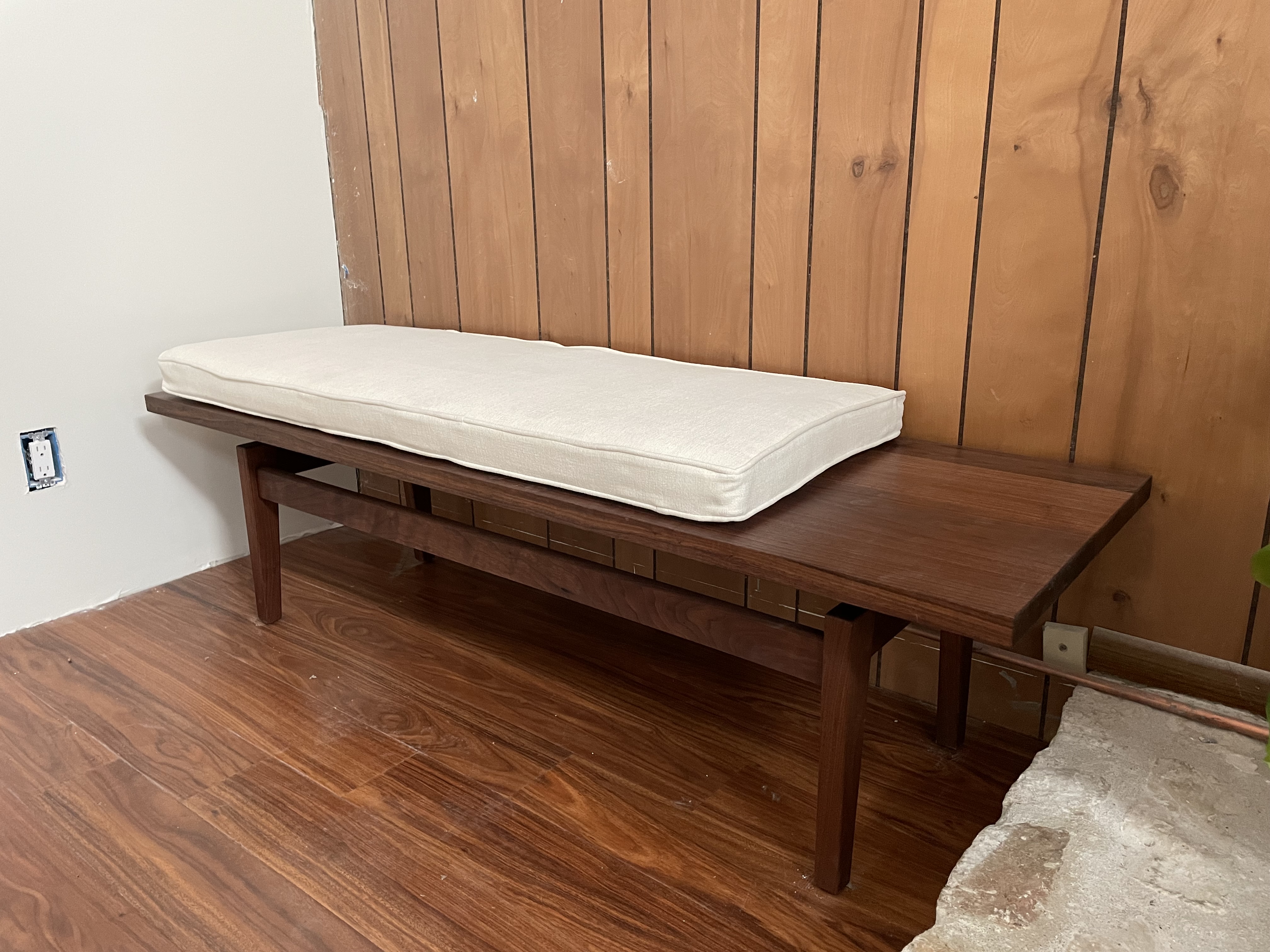

I ordered a cushion for my bench off the internet. I’m going to give this cushion a C-, but I think having a cushion is the way to go. I’ll see if this cushion fills out its case anymore. Might need to buy one from a better source.

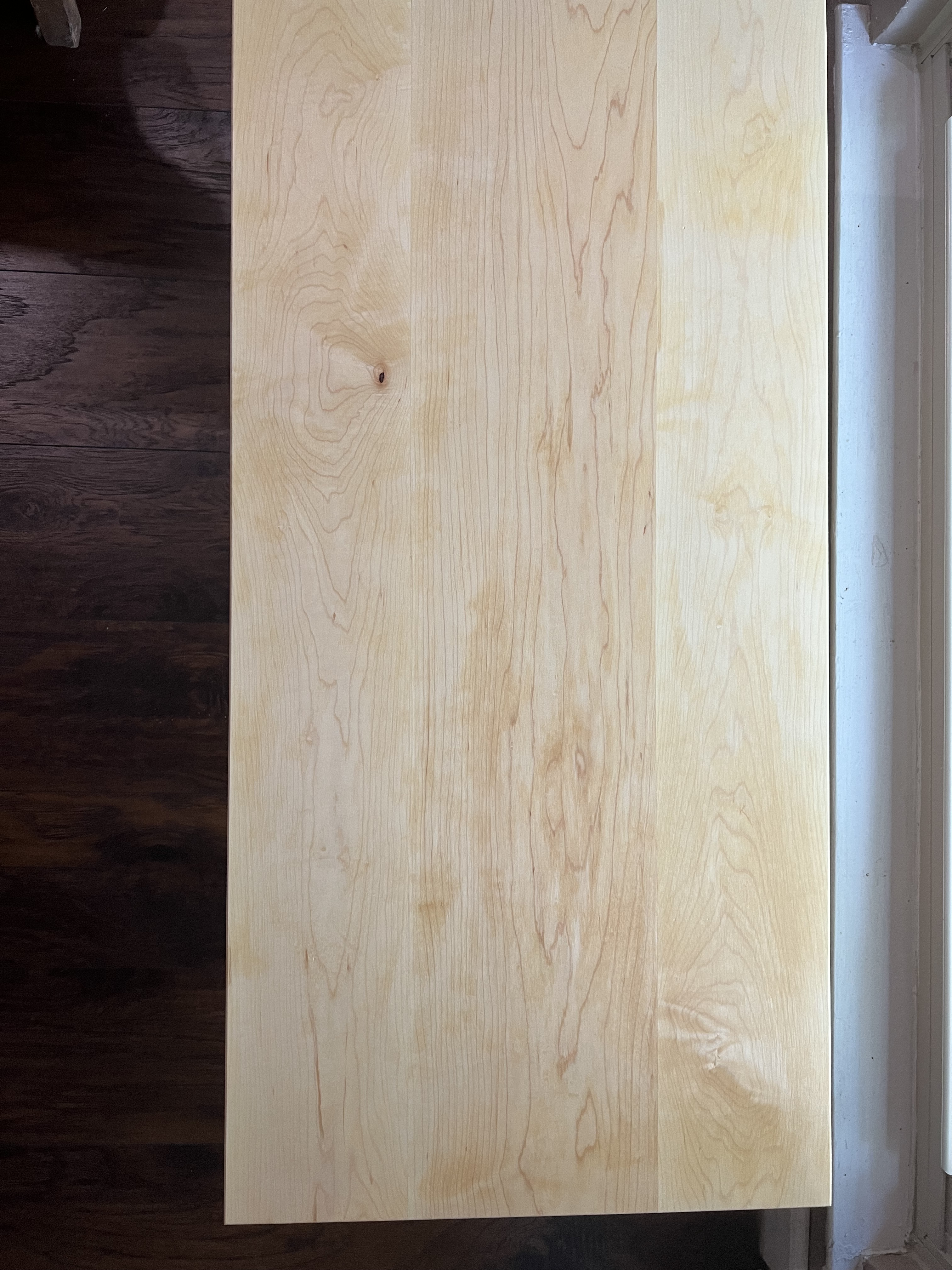

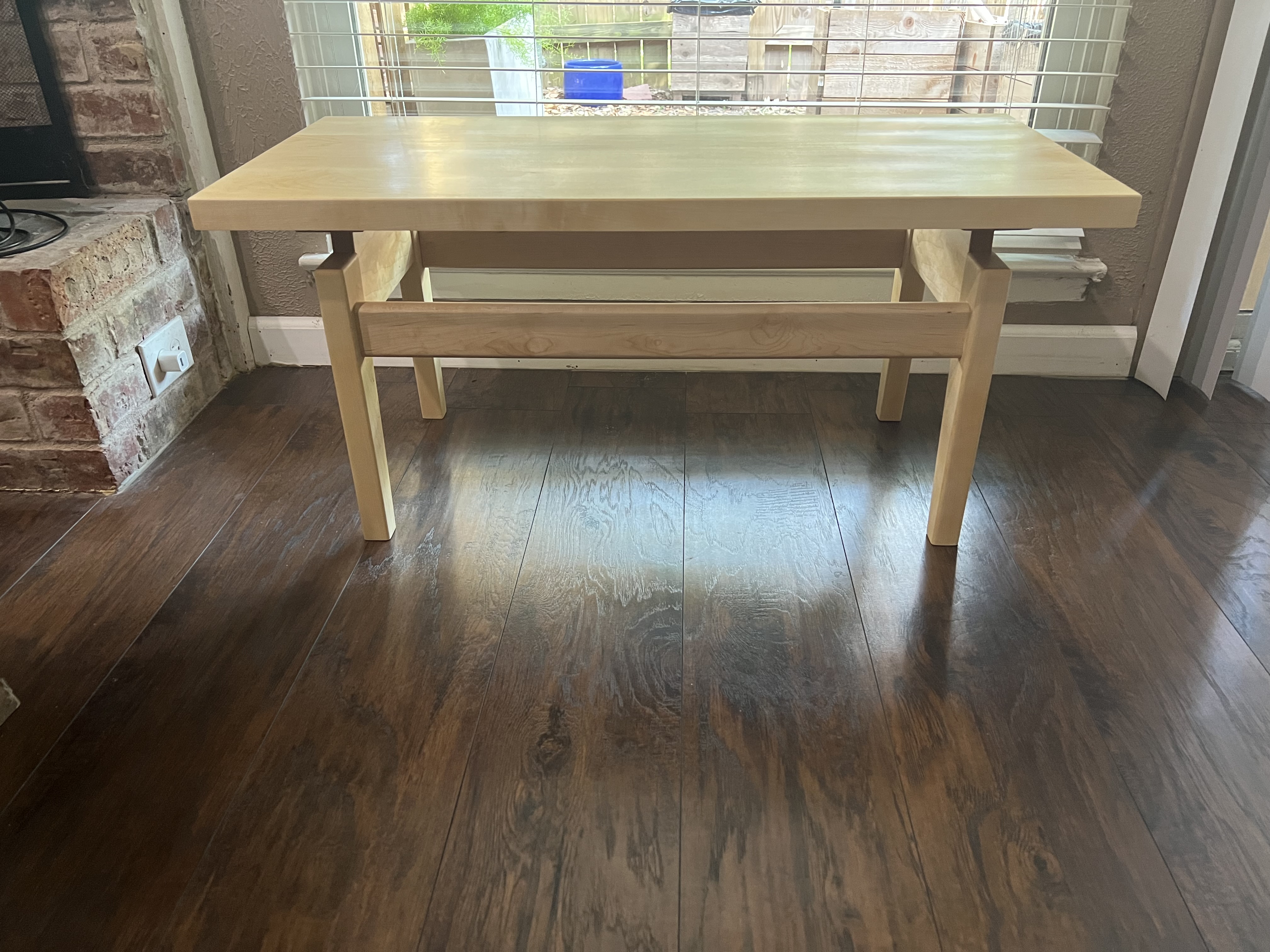

I stink at finishing and I’m blaming the maple, in part.
My base has a coat of Rubio, it’s pretty blotchy and yellow. The top is ready for Rubio but I haven’t applied it yet. I used Starbond CA glue to fill the knot that ran through the top over the weekend, it should be ready for finish tonight.
This is the first time I’ve used Rubio on a project (on the bench). But after looking up how to apply Rubio to Maple, it looks like they may not be all that compatible.
https://www.reddit.com/r/finishing/comments/vacb68/rubio_monocoat_on_maple/
@Iammikecohen
I saw that and took away that Rubio tints and any attempt to stain maple was bad. I used Rubio Pure which a poster said worked well. Also Woodcraft has a sample of maple treated with Rubio Pure and it looks amazing.
It’s functional and I’m happy with the construction. Maybe in ten years I’ll sand it down and refinish it when I’m better at woodworking.

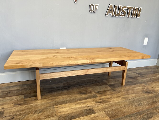

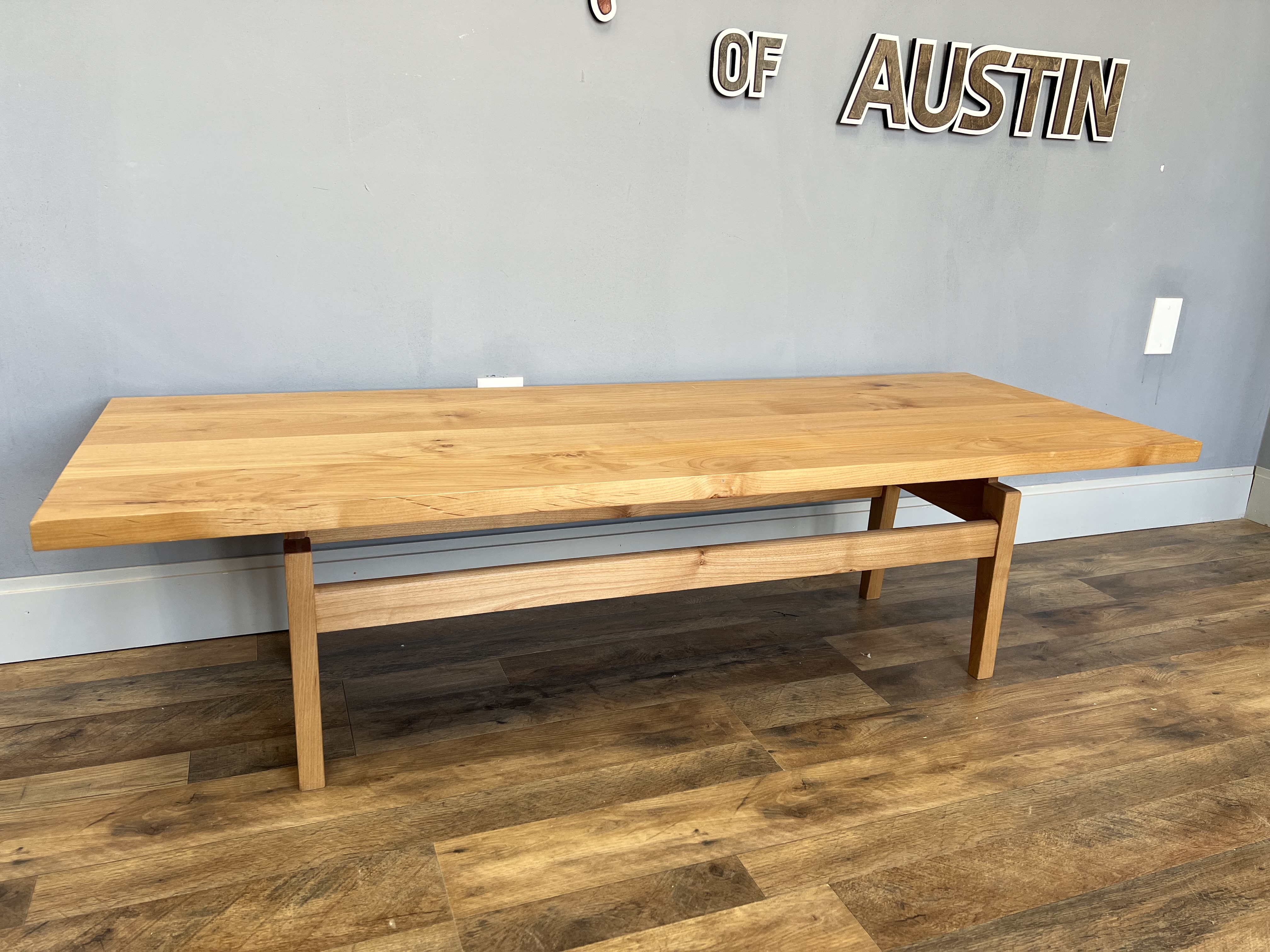

This is yours at the space? It looks great.
Just don’t look underneath :slight_smile: it was a learning experience applying the finish. The first pass was real splotchy, so I sanded the whole thing back to bare wood. The second finish, I tried a one-coat product, but it still looked uneven. Third try, I was running out of time for TWF, so I only sanded the top. Alder sure is an interesting wood.
It has been fun to see people sit on it.
My bench is very splotchy, unfortunately. I’m telling myself that once I’m more experienced with finishing I will do what you did, sand it down and try again.
