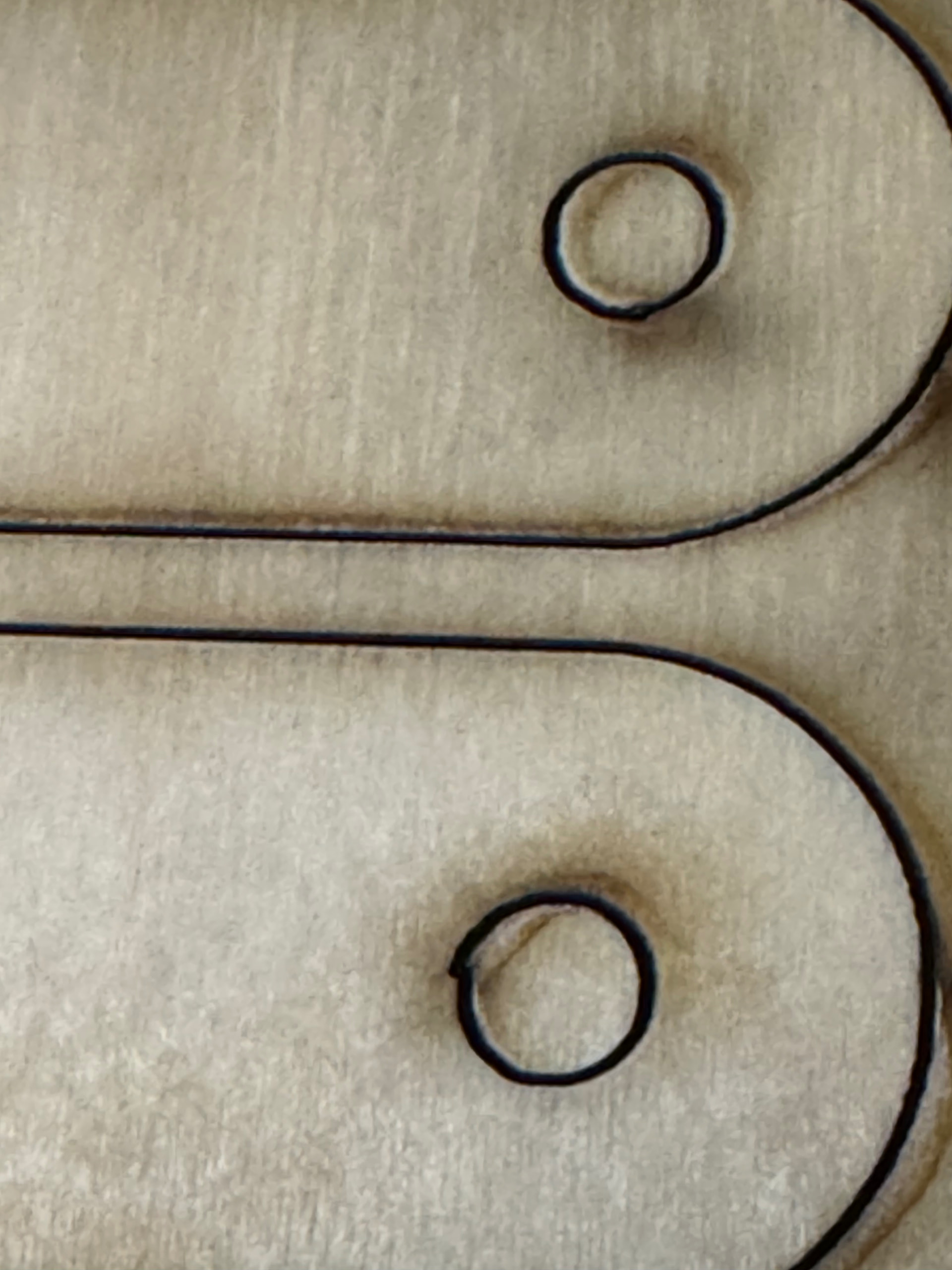

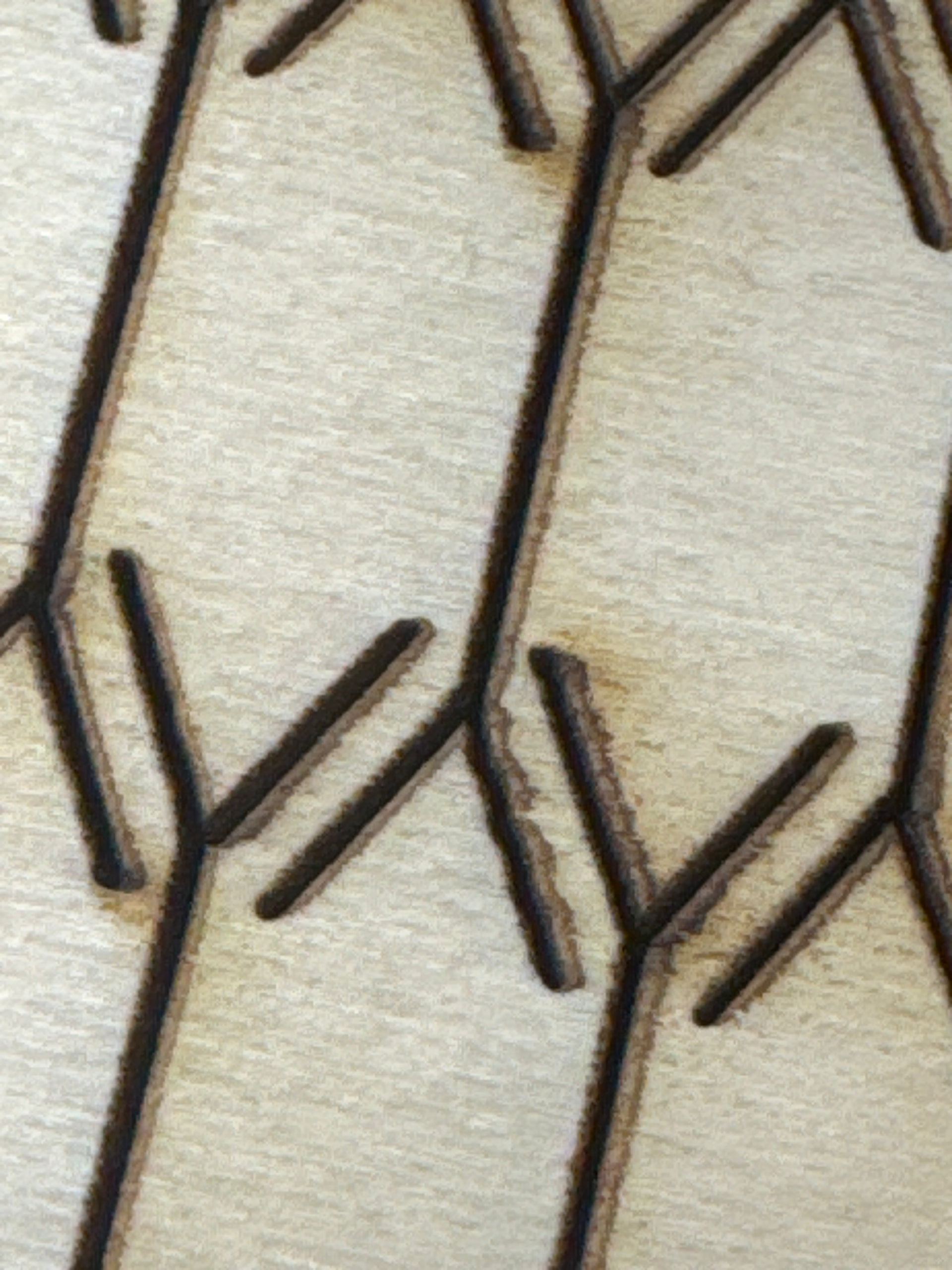

Here’s photos from Friday, note the wiggles on 45 degrees, and the extreme ghosting showing on the prefinished plywood.

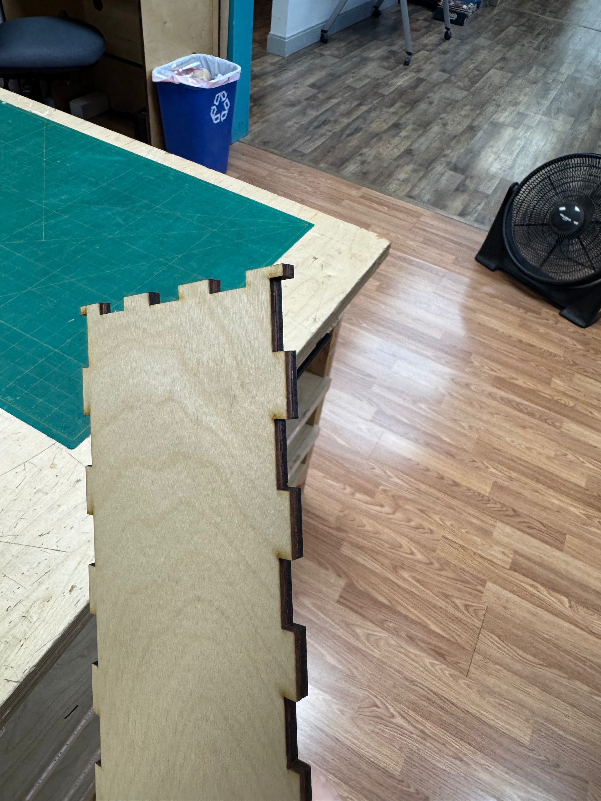

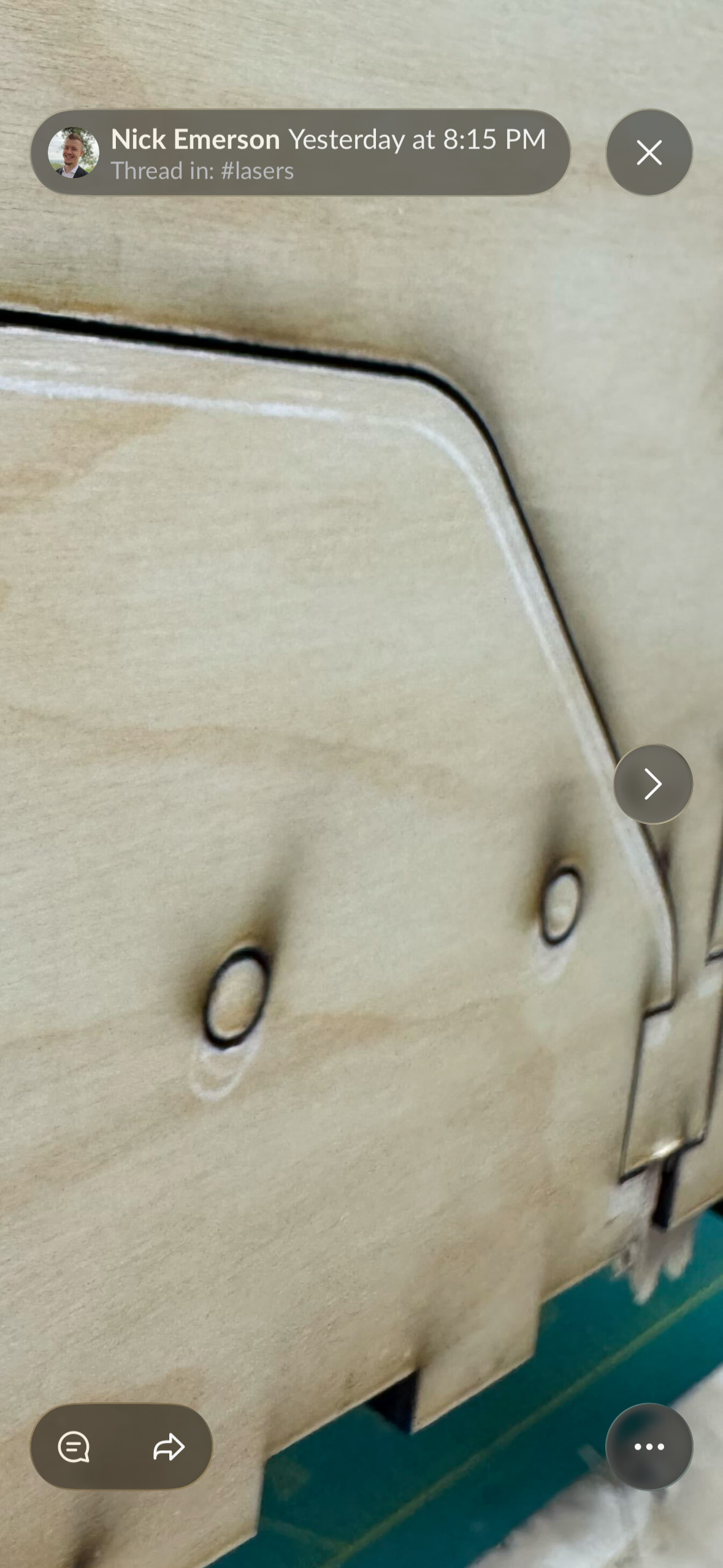

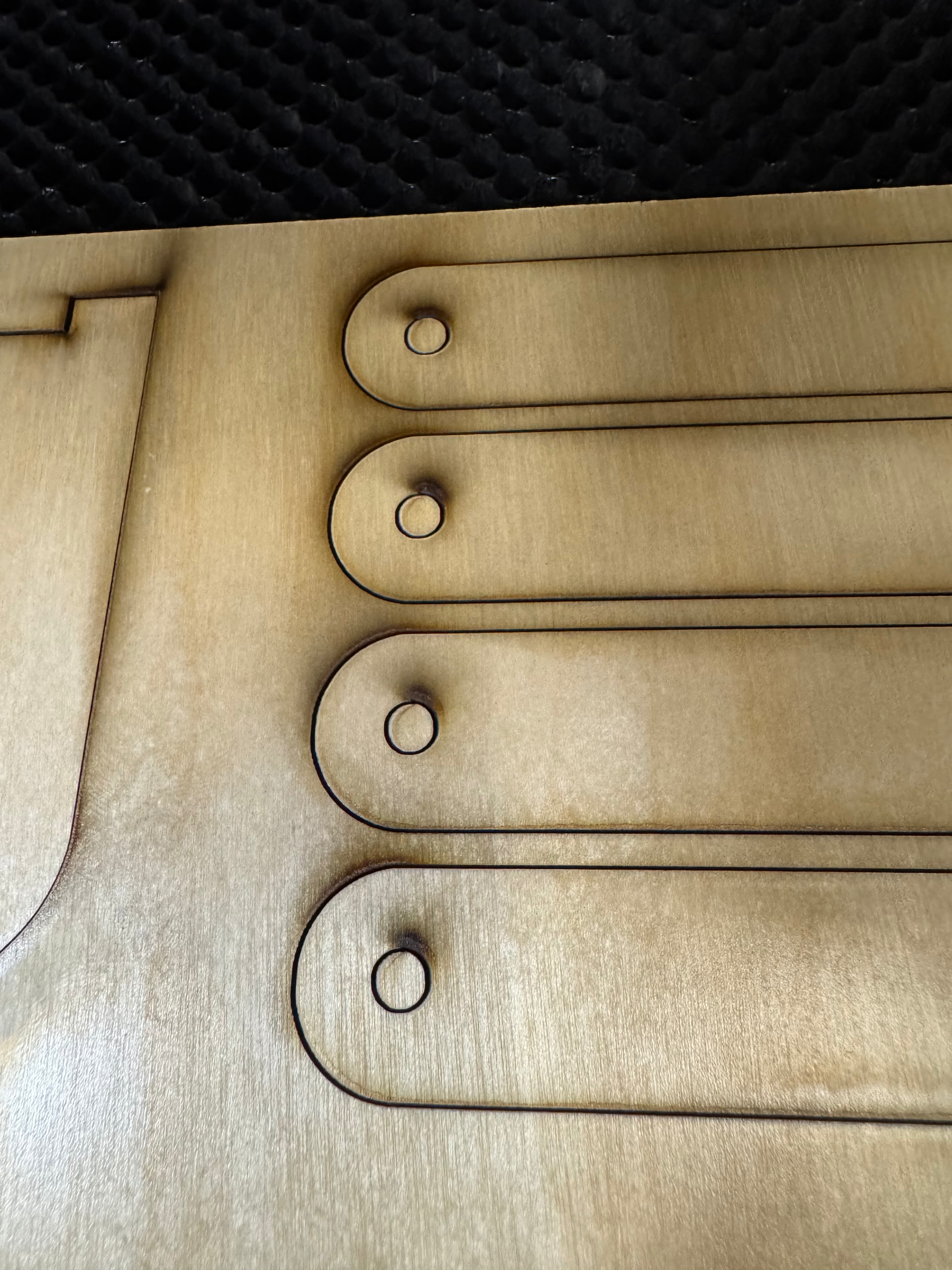

Here’s photos from Saturday showing 30mm/s cutting cleanly on Dorian, but not cutting at all on Tarkin (had to do 15mm/sec), additionally you can see the x axis shift easily in these photos too-
