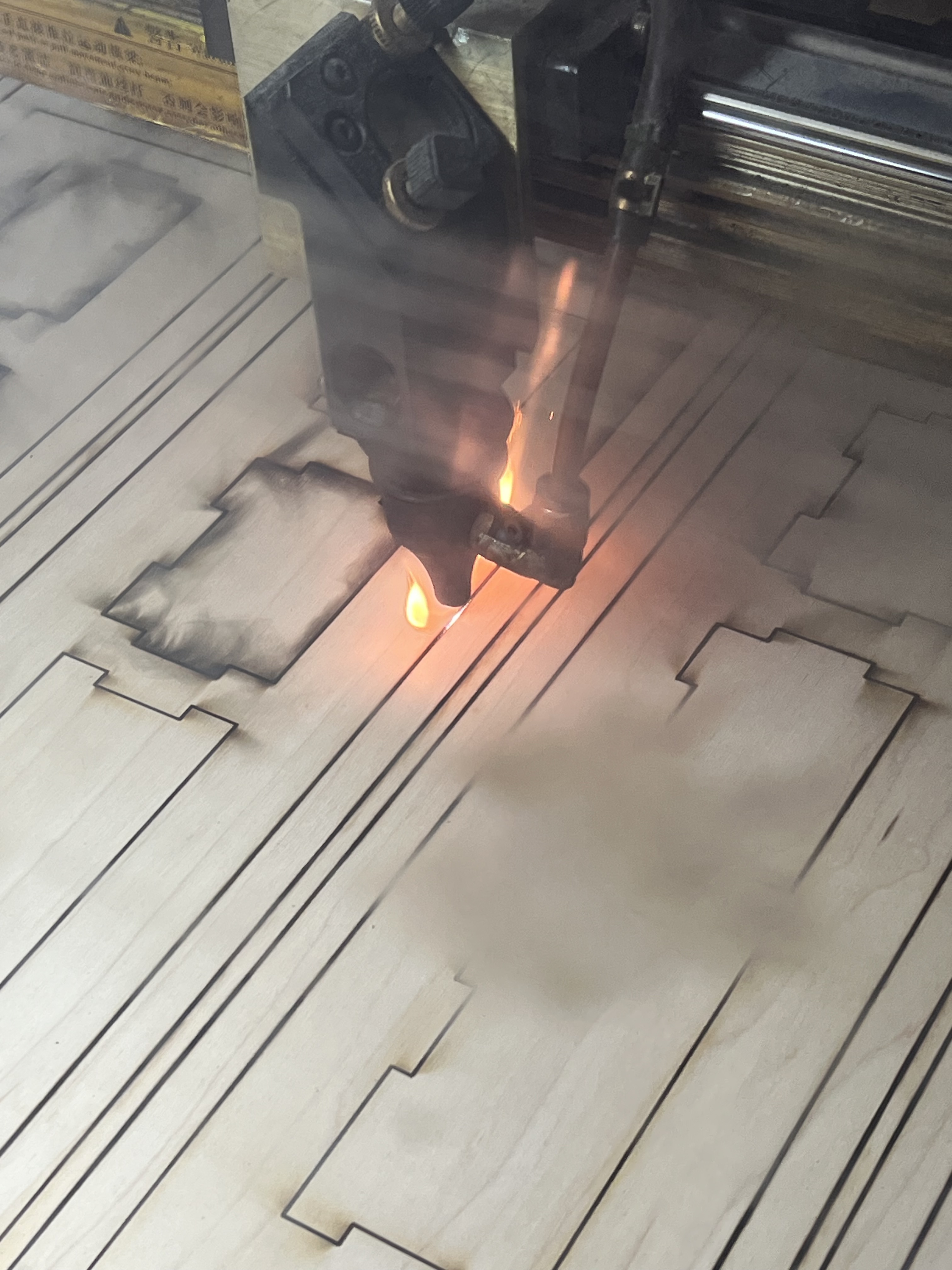

I just put in a problem report for Tarkin. It doesn’t seem to be at full power and I’m getting significant flaring at times. I’m focused correctly and using the same plywood as I normally use. The first panel cut fine. Then I started having problems with the second one. I was getting a flame tail 3-4” long. I ceased work. The attached photo doesn’t do it justice.
Turns out the air hose came off the back side. James helped and got it reconnected. We also changed out the lens. Should be good to go!
Same thing happened earlier this week.
The air hose needs a clamp or something. Very easy to miss the issue if you aren’t paying close attention.
Clamp was added ~20 min after hose was reconnected this time!
