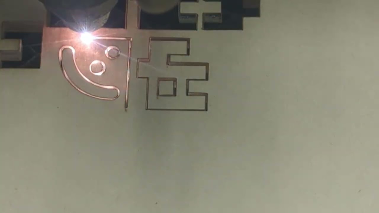

Tarkin looking good on camera
While making some cuts on Tarkin last night, I did some tests with recording video. This one turned out particularly well:
I think this one turned out so well largely because it was so zoomed-in. With larger shots, I had a lot of issues with the camera auto-focusing on the dirt and scratches on the window rather than the cutting surface. This is fixable by disabling auto-focus but I would also love to learn how to clean the window.
