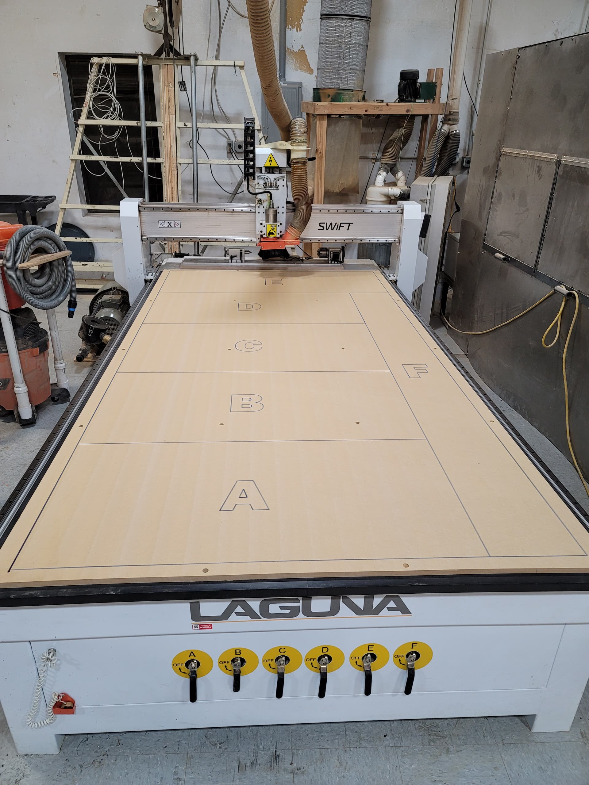

The spoilboard has been replaced on the Swift. The vacuum has returned to full power. Please mind your cuts. The spoilboard was damaged fairly quickly after the last surfacing.
On that note, you might notice some damage in the front left corner of the spoilboard. When I went to drill the holes for the hold down bolts, I forgot to re zero my endmill. I repaired the gouge by gluing in a piece of mdf before the final surfacing.

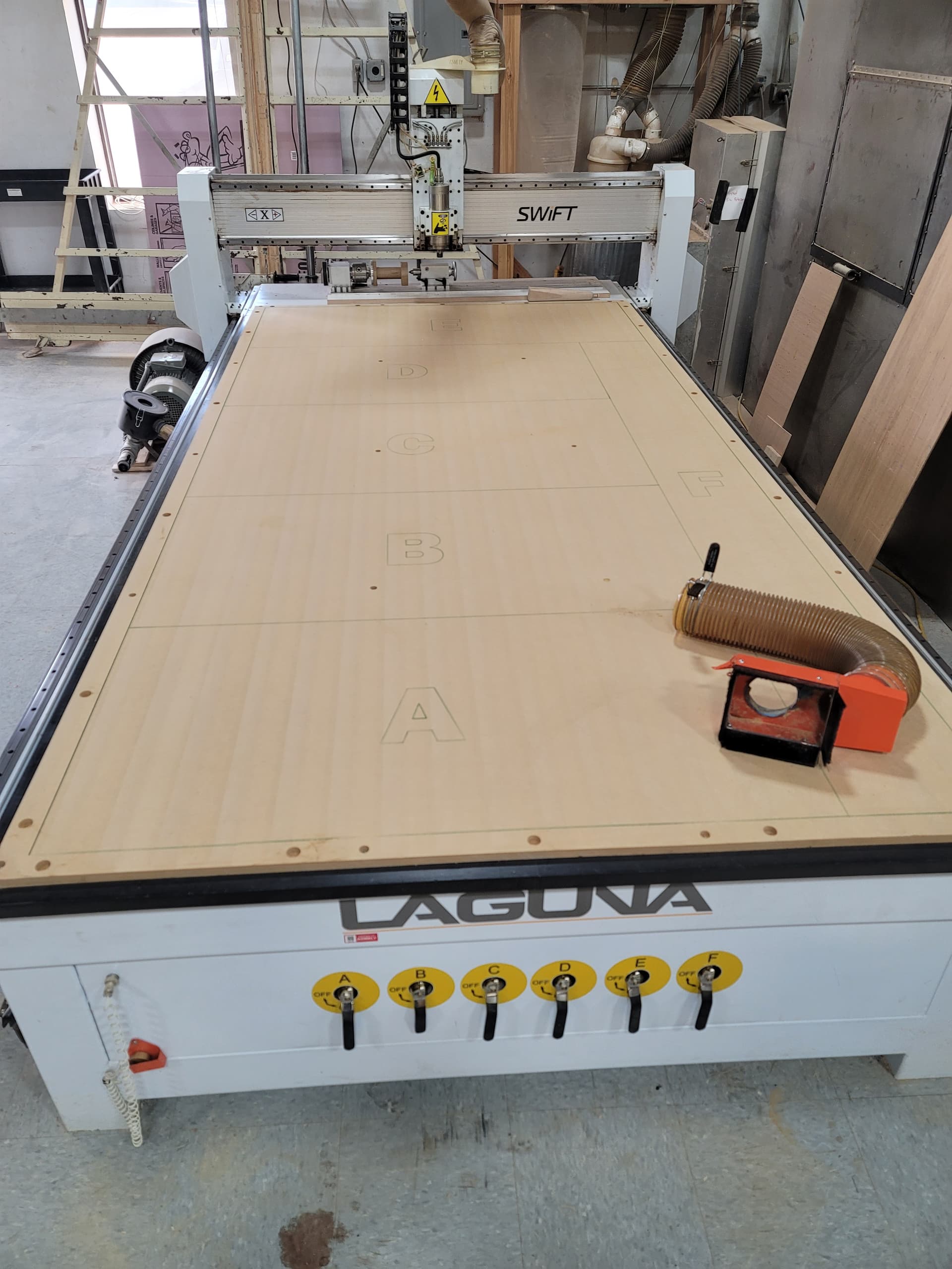

The spoilboard has been replaced again. I also replaced the bristles on the vacuum boot.
The Iq has been flattened as well. Just a heads up to keep a look out. If your cuts seem tonvary in depth on the spoilboard, and in a repeating pattern, the spoilboard probably isnt flat.
