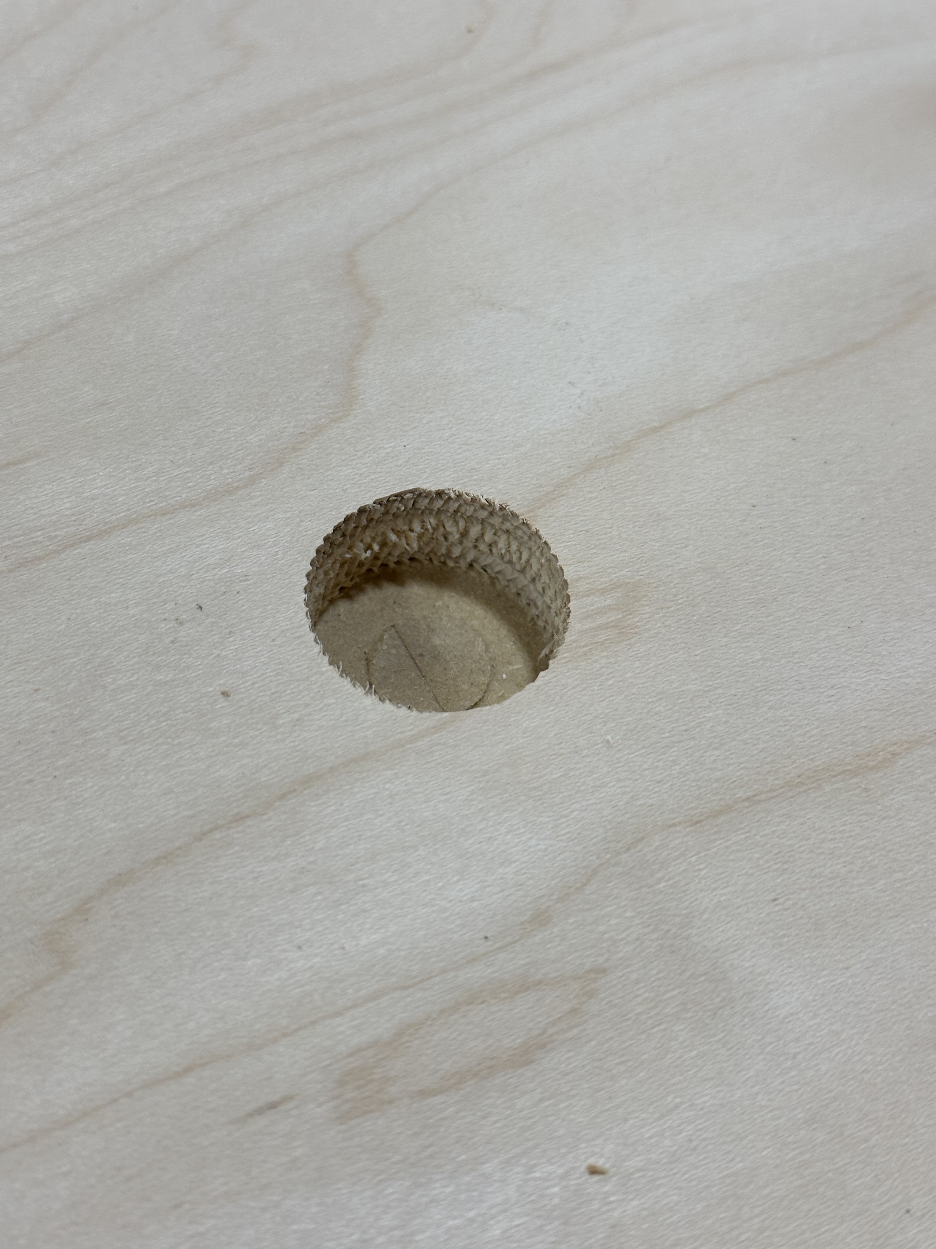

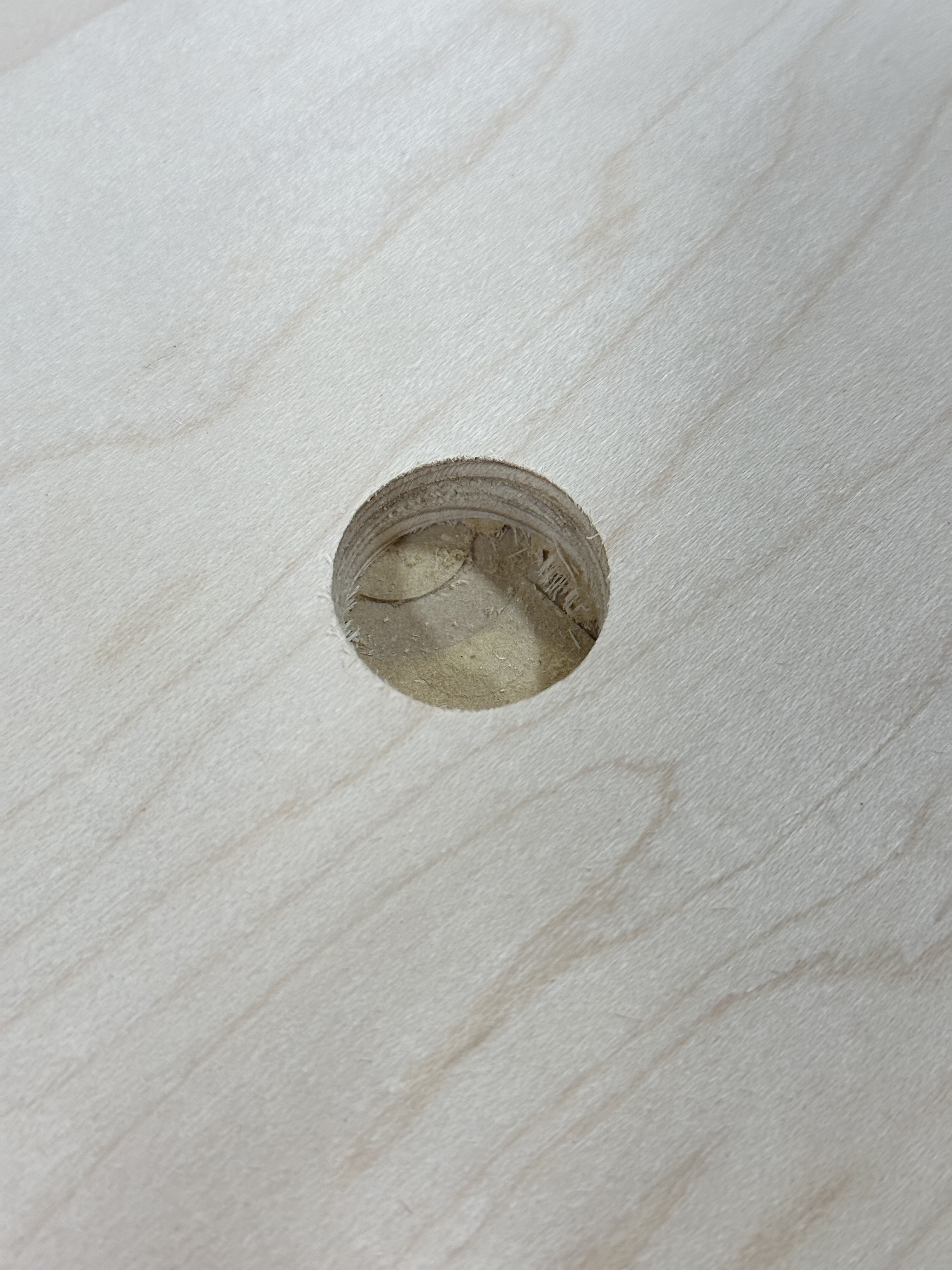

Here’s a photo of the resulting cuts
I was able to get through the cut fine with more conservative settings. I’m doing flat pockets now and it seems completely fine. Odd - well…. I guess - consider it “logged”…
