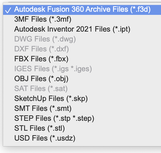

Could you provide a DXF of the sketch? I don’t know how to use the model effectively.
Could you talk more about how you plan to cut the bolt holes and dog holes? If I were doing this I would cut the bolt holes and bolt the slats down before cutting the dog holes.
Hm - it looks like I can’t export DXF from my hobby license of fusion.
Do you use fusion? It will let me export a fusion archive .f3d:
https://drive.google.com/file/d/1uNw1TqI3N35Ajoo9o44ivfPwopv8oc60/view?usp=sharing
Here are the options:
I was still still internally debating how I’d cut the 2 different sets of holes… your method would certainly leave less room for error. I know the 20mm dog holes on there now were cut on the IQ, so theoretically - cutting them on the same machine using guides that were also cut on the same machine should be pretty true… but there isn’t much reason to leave any room for any error, I suppose. I will take this model and use it for the bolt holes, then create a 2nd one that is the whole surface of 4 slats and cut the dog holes with that. probably best. Hopefully I can wiki the whole thing when i’m done, provide the model and it’ll be less gymnastics for someone next time.
