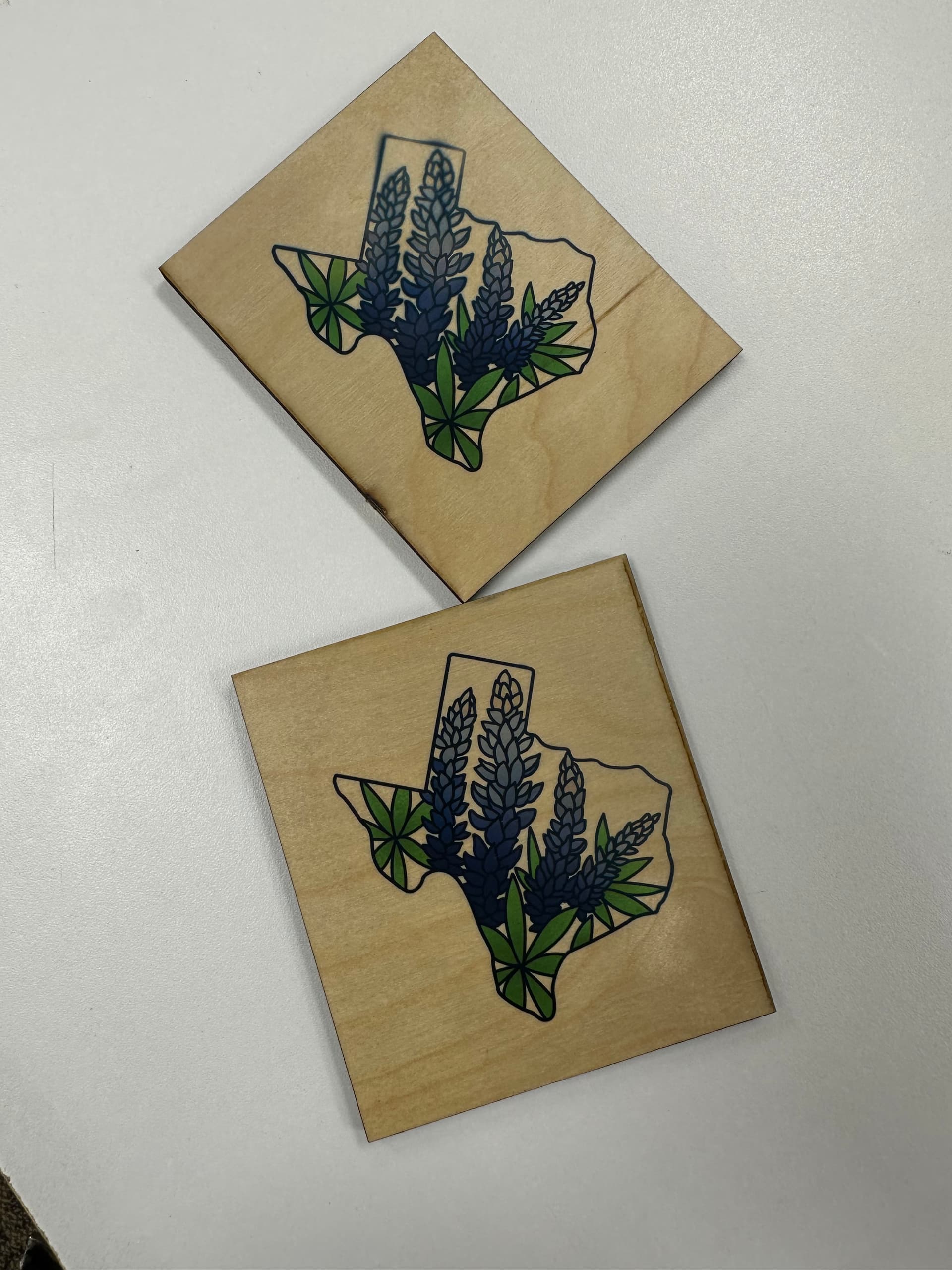

Today in materials testing - pre-finished plywood found in the laser bin.
@Sarah found a magnificent bit of scrap in the laser cart, and so we tried it out with one of her designs. And the results were great.
With no additional coating, these came out really well. The better result was the bottom of these two, which used a higher pressure, and seemed to better counteract the warp that the board had. The very top of the upper image is where the lines become less sharp, and the color doesn’t saturate as well.
This is 90 seconds at 375F, recommended high pressure. 1/4” pre finished ply
Also, using @jamesfreeman’s trick, flipping the board over and sending it through the press a second time for the same duration helped flatten the board.

What I don’t know - if an additional layer of protective finish would be needed for this.
Not necessary. What you practically did is transfered the dye or ink into the laquer of the plywood. But if youre ging to use them as coasters and not decorations, it would not hurt.
Thanks for the extra info @JOSEGAYTAN - that what I might have assumed, but appreciate your knowledge on this one.
