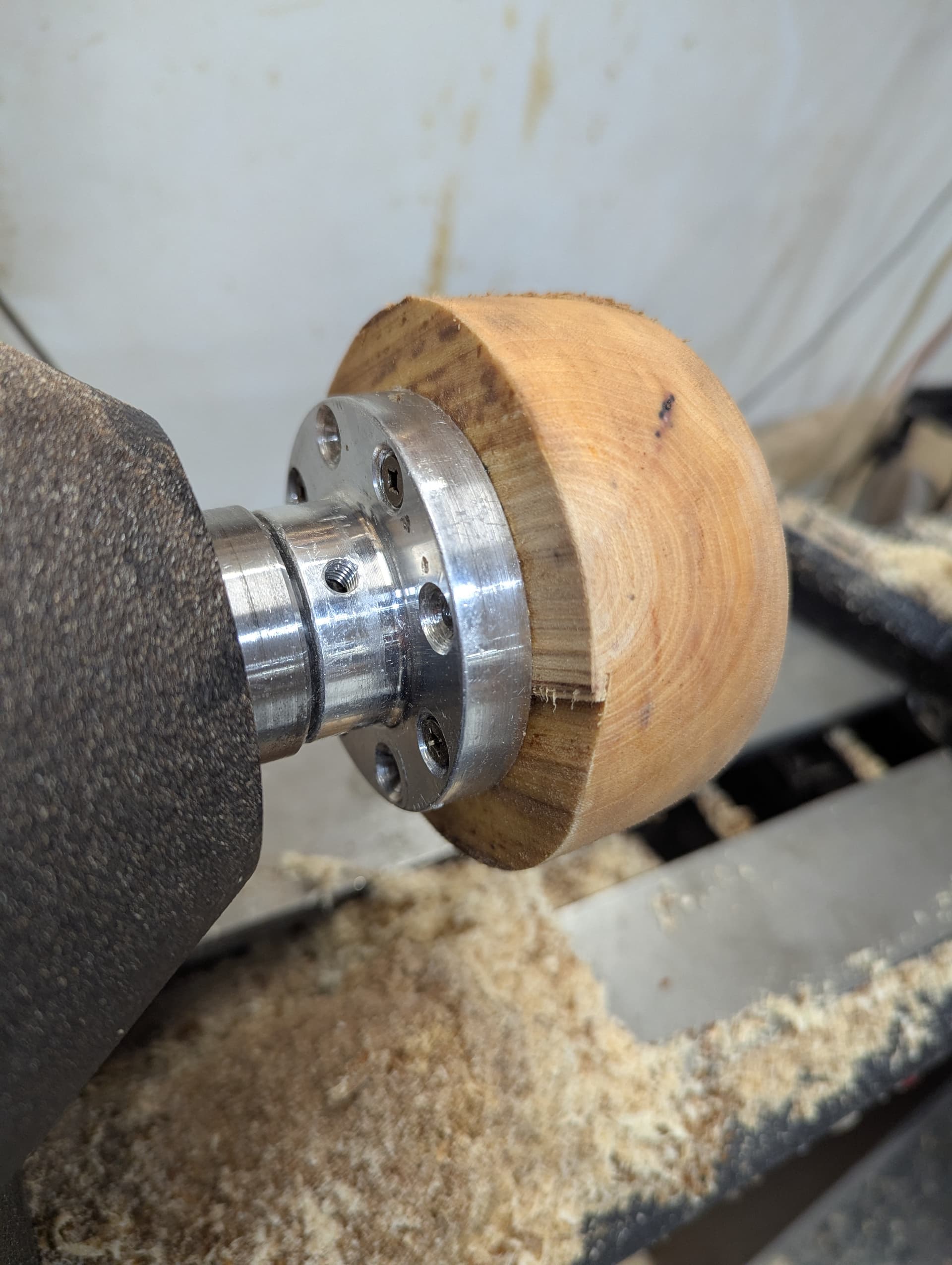

I was trying to turn my first bowl tonight on the lathe, and ended up getting the faceplate stuck. I’ve tried just muscling it off, and tapping it with a mallet, but haven’t been able to get it loose. Any tips for loosening it? Or is there any grease or something available in the shop?
Resolved! I was able to get my bowl off and get a scrap piece of wood screwed into the faceplate, then gave it a couple whacks with the mallet until it came loose.
I’m glad you were able to get it off. Were you making use of the red button below the control panel? If you hold that down and spin the Chuck maybe a quarter turn or so, it locks the spindle so you can actually apply force.
And if it doesn’t come off by hand, it usually doesn’t after a long or heated turning session, I put a few dedicated wrenches in the tool drawers that can help.
Ah, I knew there must be a way to lock the spindle, but I didn’t know how - I didn’t even realize there was a button there. Mikey held on to one end while I tried to spin the bowl.
I’ll keep that in mind for next time, and I’ll take a look in the tool drawer for the wrenches. But the faceplate I was using was completely round, so I’ll pick one with a wrench slot next time.
Another good option, and my preferred option is using the worm screw.
We have one faceplate with a worm screw set into it, and the other screws have to be locked in chuck jaws. One hole to drill, one thing to unscrew.
