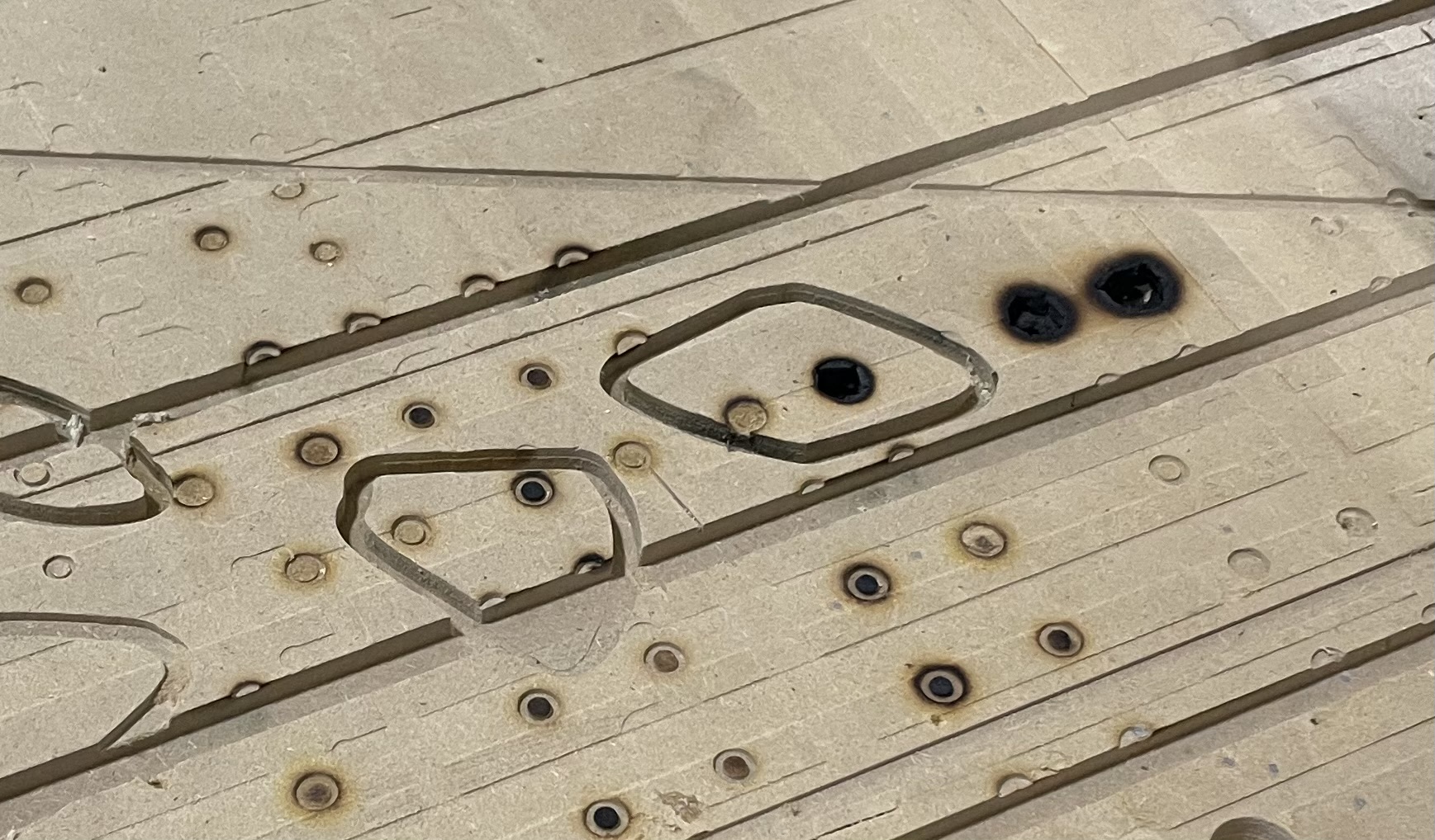

So we appear to have had yet another fire on the spoilboard of the large CNC:
From what I can see, these fires keep happening when people use drilling toolpaths. These toolpaths move the tool (end mill or drill bit) purely vertically to create a hole with the same diameter as the tool. These toolpaths are very different from laterally moving cutting toolpaths. The key point to understand about drilling is that, as the tool goes deeper into the hole, the sides of the tool are continuously rubbing against the entire side of the hole. This generates much more heat than a cutting path, and it’s all in one place with no air flow to dissipate this heat.

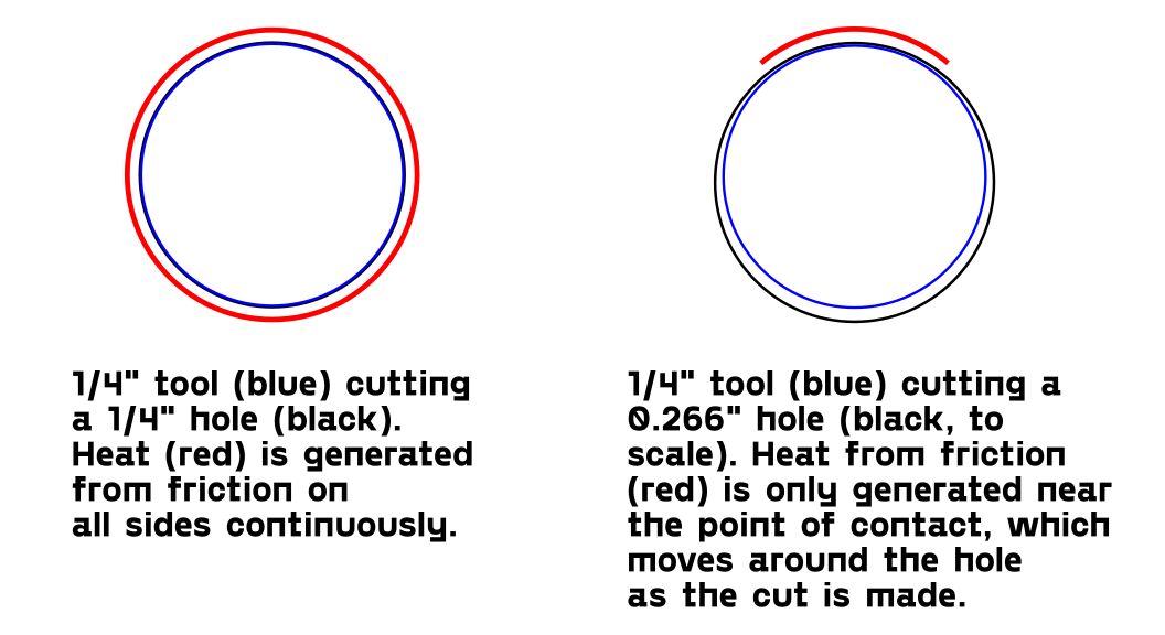

The first issue is that most of you are drilling the wrong size hole. Many of your through holes are intended for bolts. If you have a 1/4” bolt, most woodworkers use a 1/4” drill bit to make a 1/4” hole. You can get away with that in wood, because the threads on the bolt are hard enough to tear the sides of the hole and bore it out more fully. But by contrast in metal, if you drill a 0.250” hole, a 1/4” bolt will not fit through it. Forcing it through will damage the threads. The correct hole diameter for a 1/4” bolt is 0.266”. That’s for “free clearance”; “tight clearance” is 0.257”. We make these holes with size H and F drill bits. And now you see why the metal shop has so many more drill bit sizes than the wood shop.
In the manual wood shop, you can make the right size holes by borrowing our metal shop bits (provided you return them to their exactly correct location!), but these bits won’t fit the CNC collets. But you have a better option: the pocket toolpath.
If you need a through hole for a 1/4” bolt, do not use a drilling toolpath with a 1/4” end mill. Instead, make a 0.266” hole using a pocket toolpath. 16 thousandths of an inch may seem tiny, but it’s enough that your tool will be contacting the side of the hole only near the cutting point, greatly reducing the heat generation. It also allows some airflow into and out of the hole. (That small amount of tolerance will also make lining up holes in different pieces a lot easier.)
