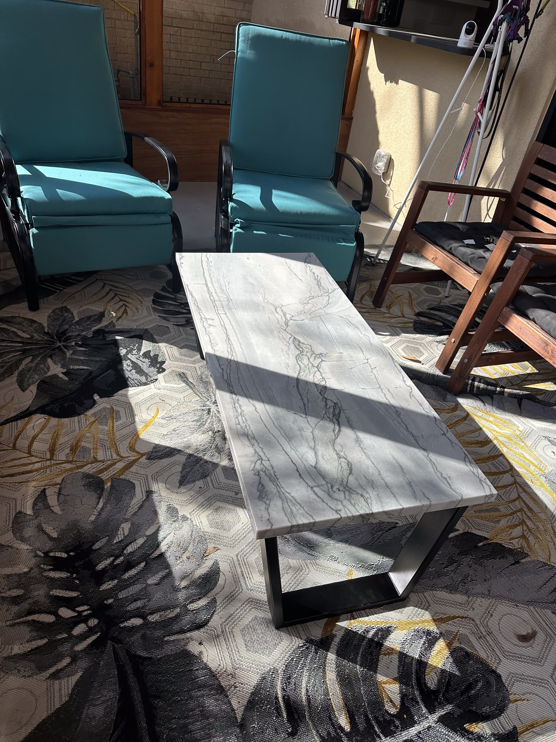

I joined Asmbly to use the welding fixture table to work on a project. 294 days later, I actually finished* it!

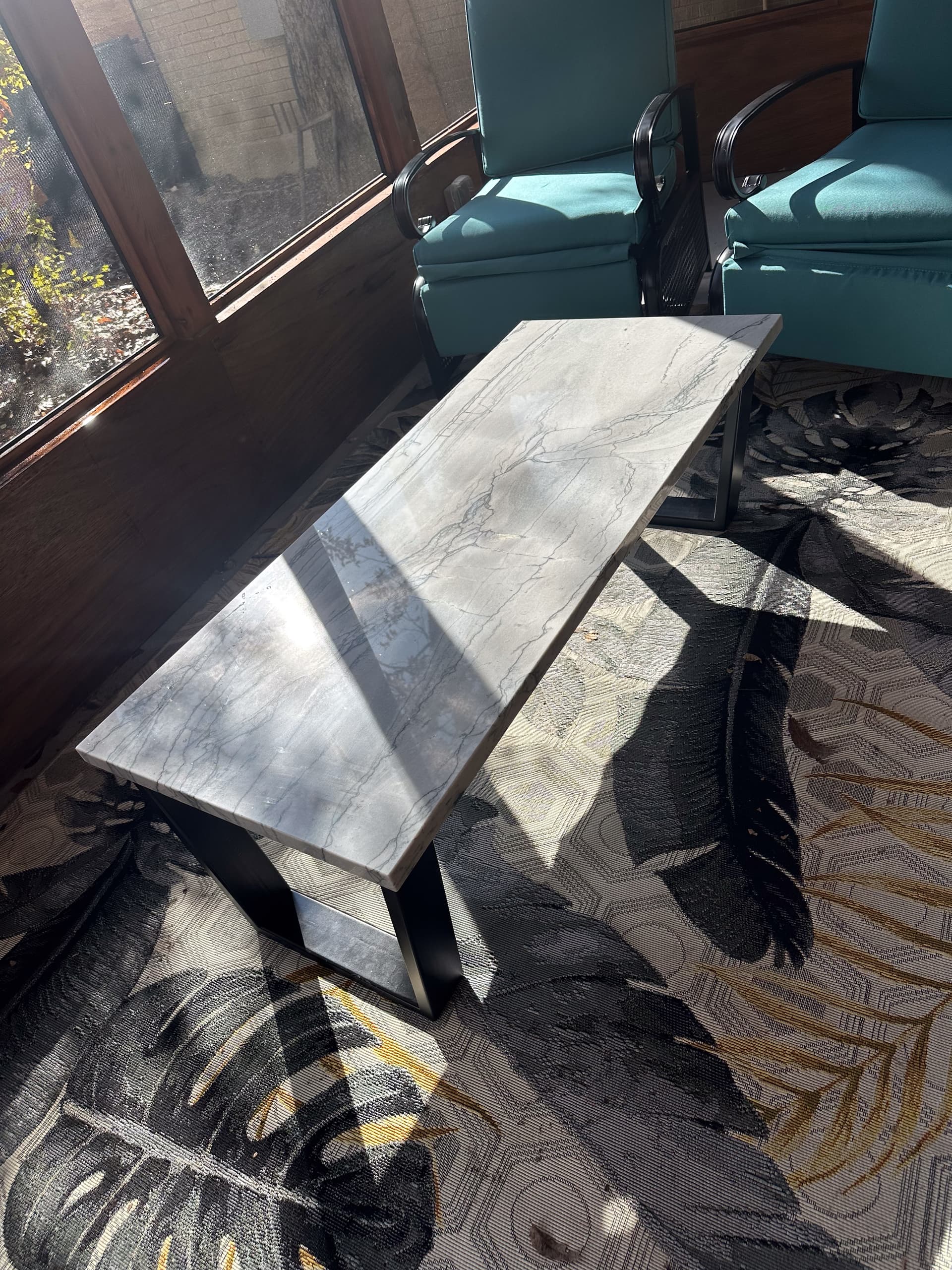

When we remodeled our bathroom, we bought a big slab of quartzite for our countertop. The countertop only used about half of it, so we saved the offcuts. I designed a base and fabricated it mostly at Asmbly.

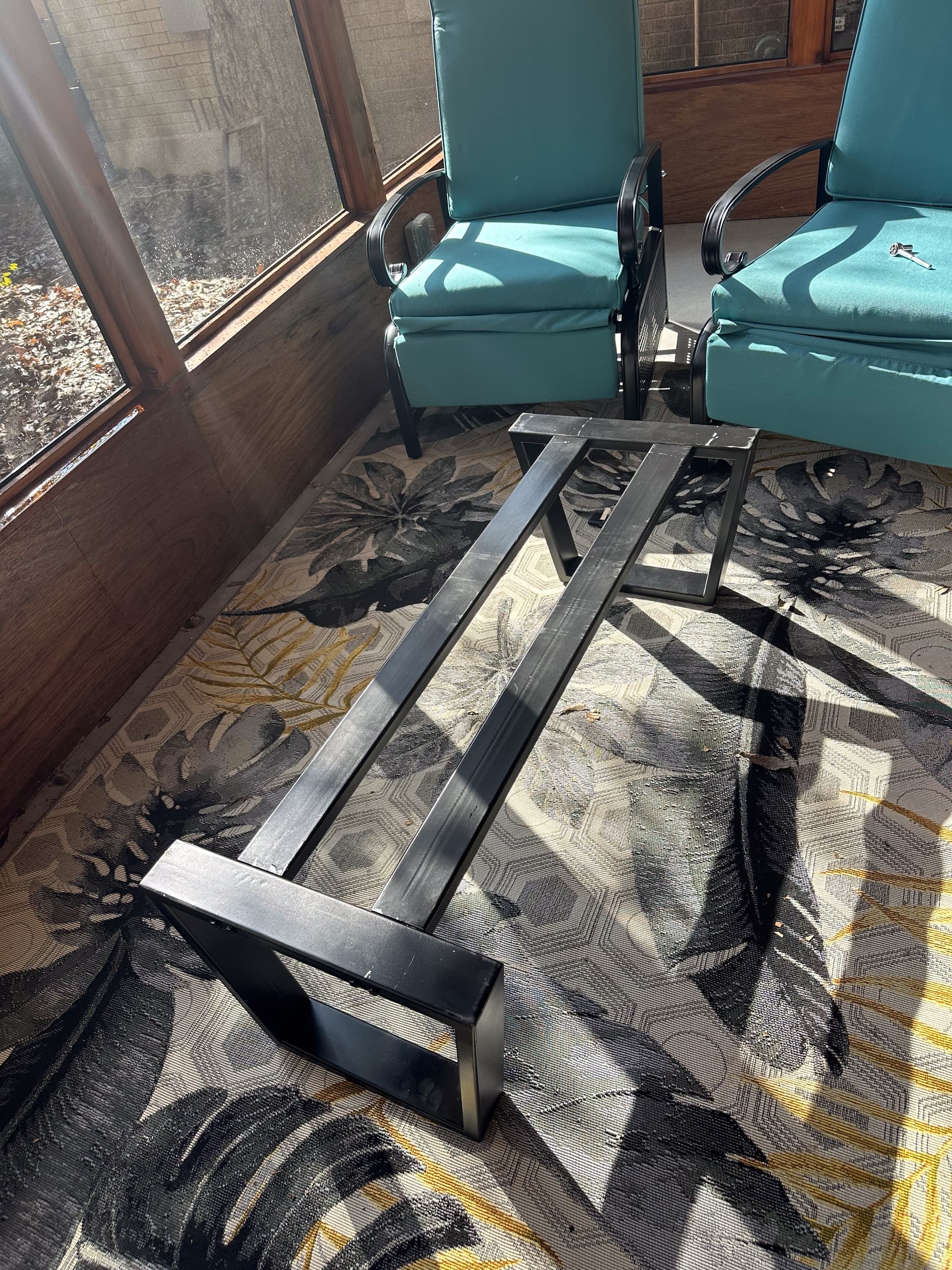

Why did it take so long? It would have been straightforward to make, except that I opted for things to not meet at right angles. I didn’t have the skills necessary to make everything meet up properly, and the first sides I made were warped enough to wobble. I ended up pausing the project for a while to take Intro to Layout and Fabrication at Austin Community College, and got much better results once I knew what I was doing.
Somehow I managed to make a simple welding project involve both the Laguna Swift CNC (to make an MDF jig to hold everything in place) and the Tormach (to make holes that actually lined up).
There are a bunch more pictures of the process here: Welding - Balcony Table | Flickr
The most frustrating part of the project was actually spray painting it at the end. I’m still not happy with how it turned out because the paint is chipping in places. Maybe it’s not actually finished, and I need to get it sandblasted and powder-coated…
If only Asmbly had facilities for finish work :slight_smile:

Curious, I am not seeing how the slab is secured; is the slab attached to the base or is it free floating by design?
The slab is resting on stick-on rubber bumpers on the base. It’s heavy enough that it doesn’t move when you bump it, so it didn’t seem important to secure it further.
