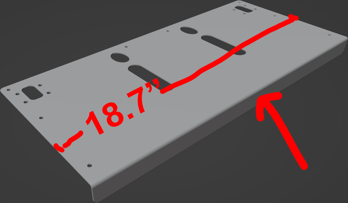

Hi, I’d like to make a flange in this part:
The material is 0.063” aluminum. I have the flat part already. The width of the flange is not critical, and I want a consistent bend radius for aesthetic reasons. The flange is intended to add stiffness.

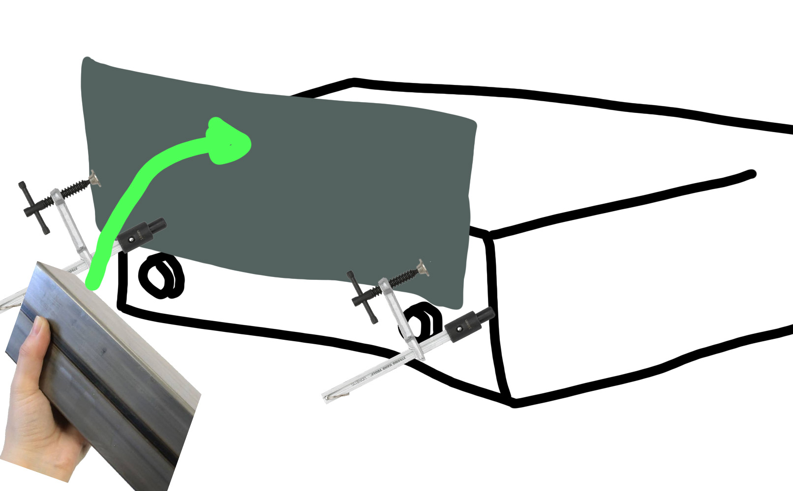

Does the sheet metal brake work? I could also bend the part on the fixture table, by replicating a metal brake with steel tubing. (But the actual metal brake would be easier.)

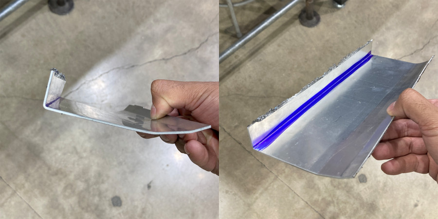

Using the 3-in-1 press brake I was able to get a 90-degree-ish bend in a test piece in 0.063” aluminum. I straightened the piece out on a table because the upper dies are not perfectly aligned. (The middle die is slightly lower and it was stuck in the jamb.)
On the full-width piece I couldn’t get the full 90 degree bend. The upper dies assembly kept slipping upwards. It’s held in place by four screws. I loosened the screws, allowed it to slide into place and then tightened them again.
The manual says that the max. gauge is 20 gauge, and does not provide any consideration for part width or material. The tool is not well suited for bending thicker material, as evinced by the fact that the upper jamb gets pushed out of alignment. It has been in red-tagged state for the entire time I’ve been a member here at Asmbly.
