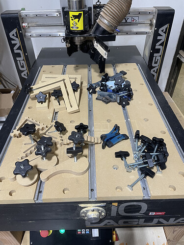

Small CNC hold-downs improved
I have removed all 1/4”-20 T-Slot bolts and handles from the small CNC hold-down bucket. These didn’t work because their T-Slots were too narrow and would spin and not catch on the sides of the slot.
I have replaced all of them with 5/16”-18 T-Slots bolts and handles throughout. Yippee - these work in our slots and hold stuff down down down! This include a pile of metal clamps, the cams, the circles, and other misc. hold downs. I also created a new set of four MDF right-angle hold downs - fresh and purdy and ready to get dinged and marred (the old ones had 1/4” slots and were tossed out). Finally I purchased and donated a set of smaller clamps.
In other words, everything has new handles (both 5 and 2 lobes ones) and bolts. There are extra handles and bolts in the hold-down bucket too.
