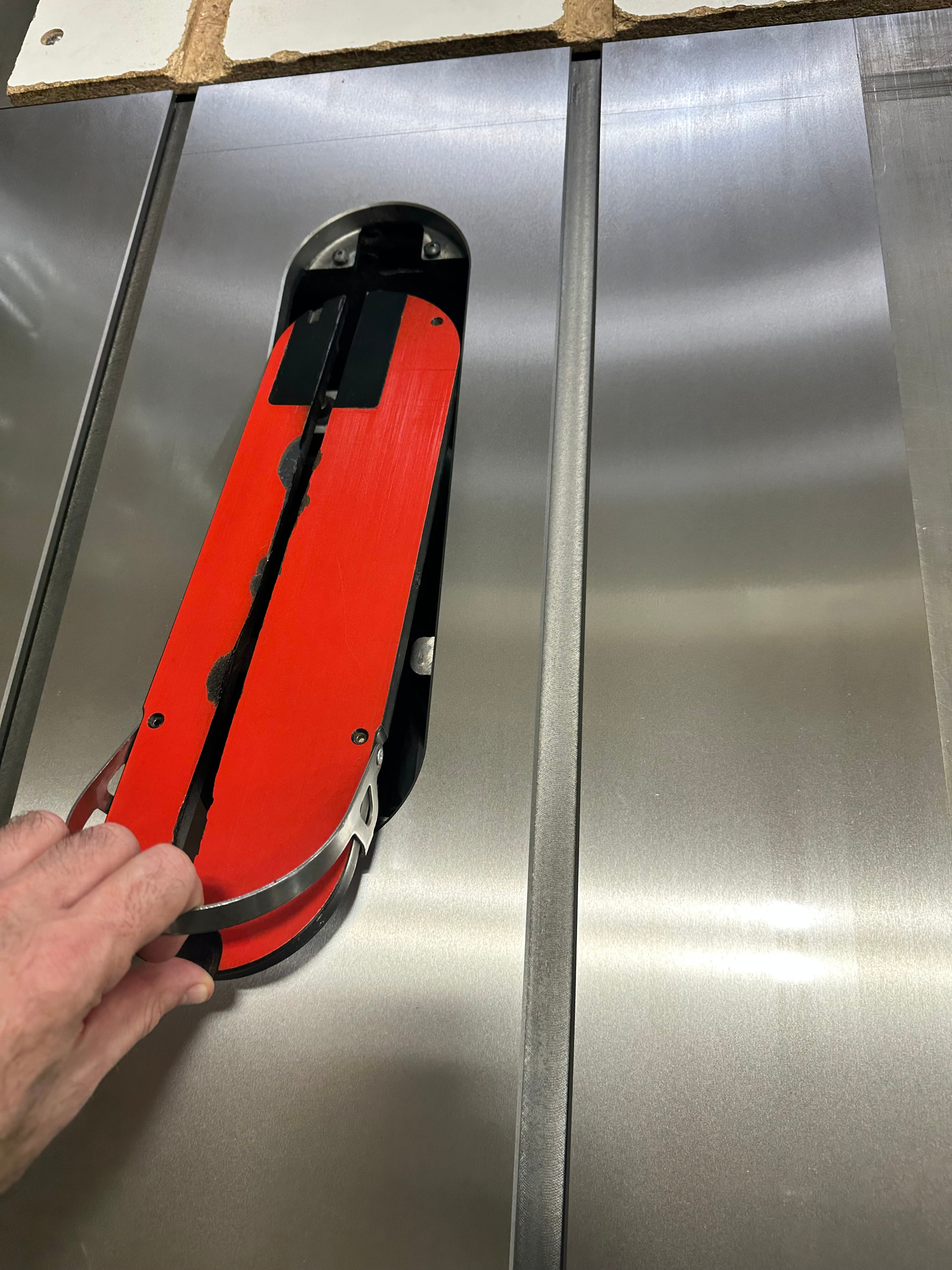

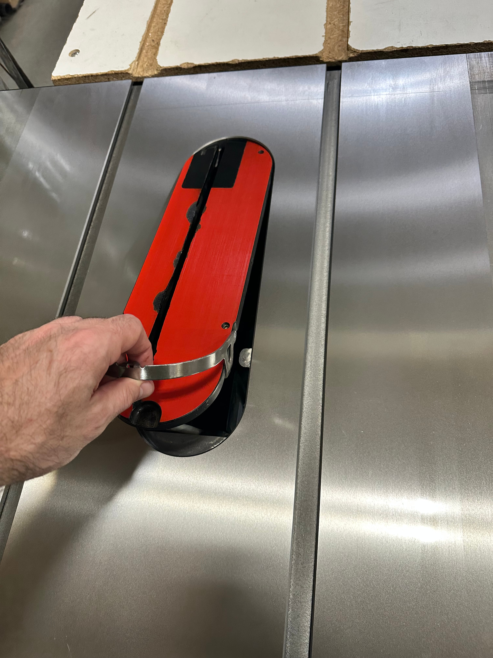

When removing the throat plate, pull it up slightly, and then pull it towards you (see photos). It clips down in the rear. Do the the reverse when installing.
