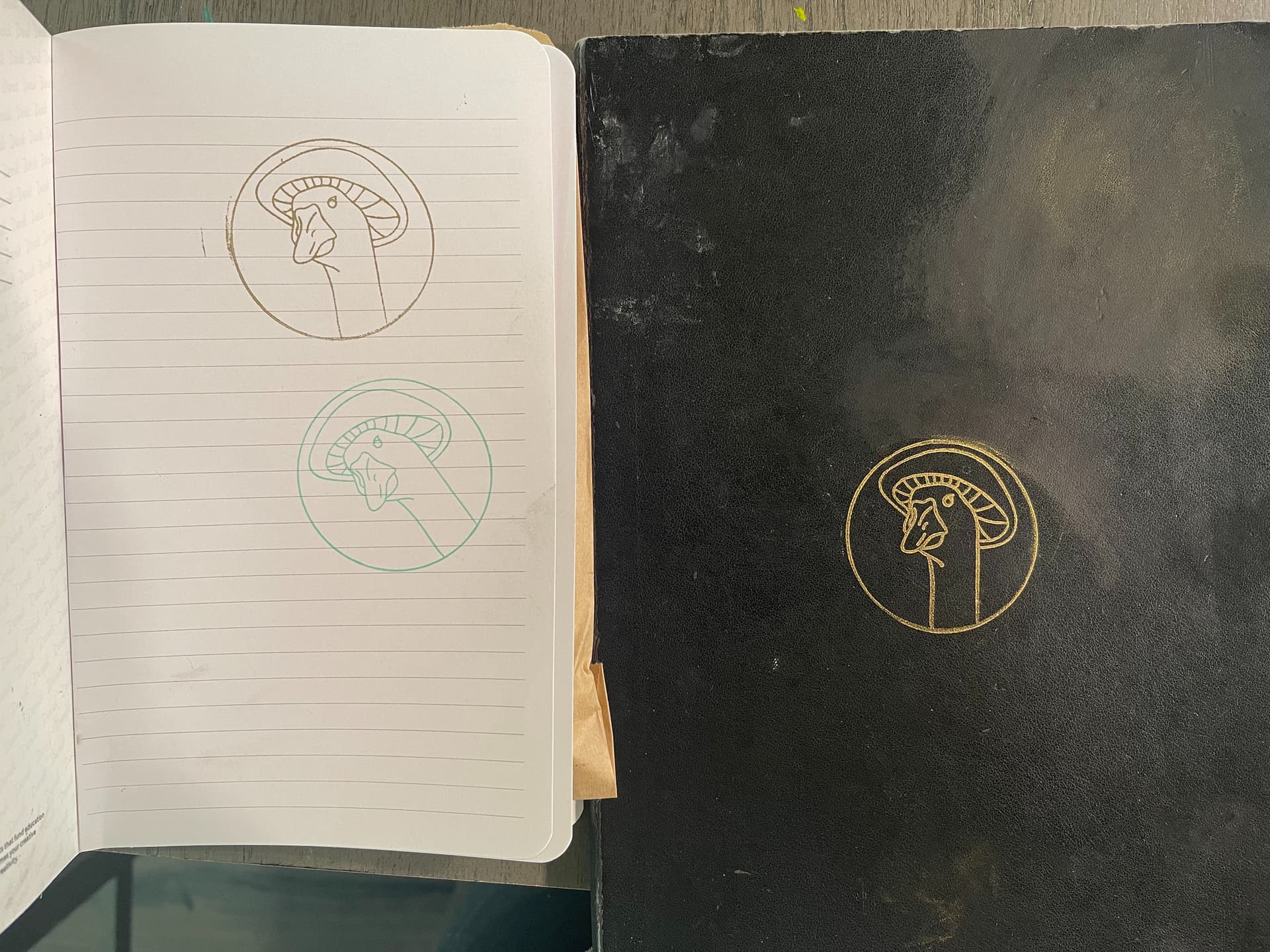

finally had the time slot to test this out and yall were right, laser is definitely easier than the cnc. and i have to say it was even easier than i had expected
for anyone curious, this is the material i used
i made these on dorian with these settings:

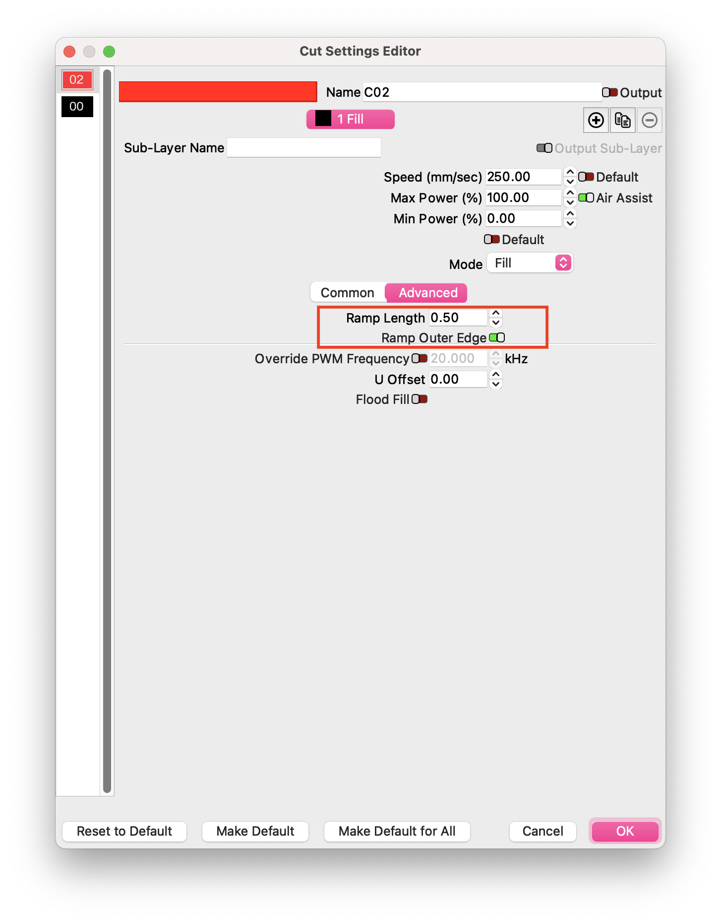

fill
250mm/s
100% power
cut
30mm/s
100% power
additionally, you have to ramp the edges to keep them more stable so your design doesn’t get all smudgy. double click your fill layer and go to the advanced tab and you’ll find “ramp outer edge” tickbox, which is tickable after you enter a value in “ramp”

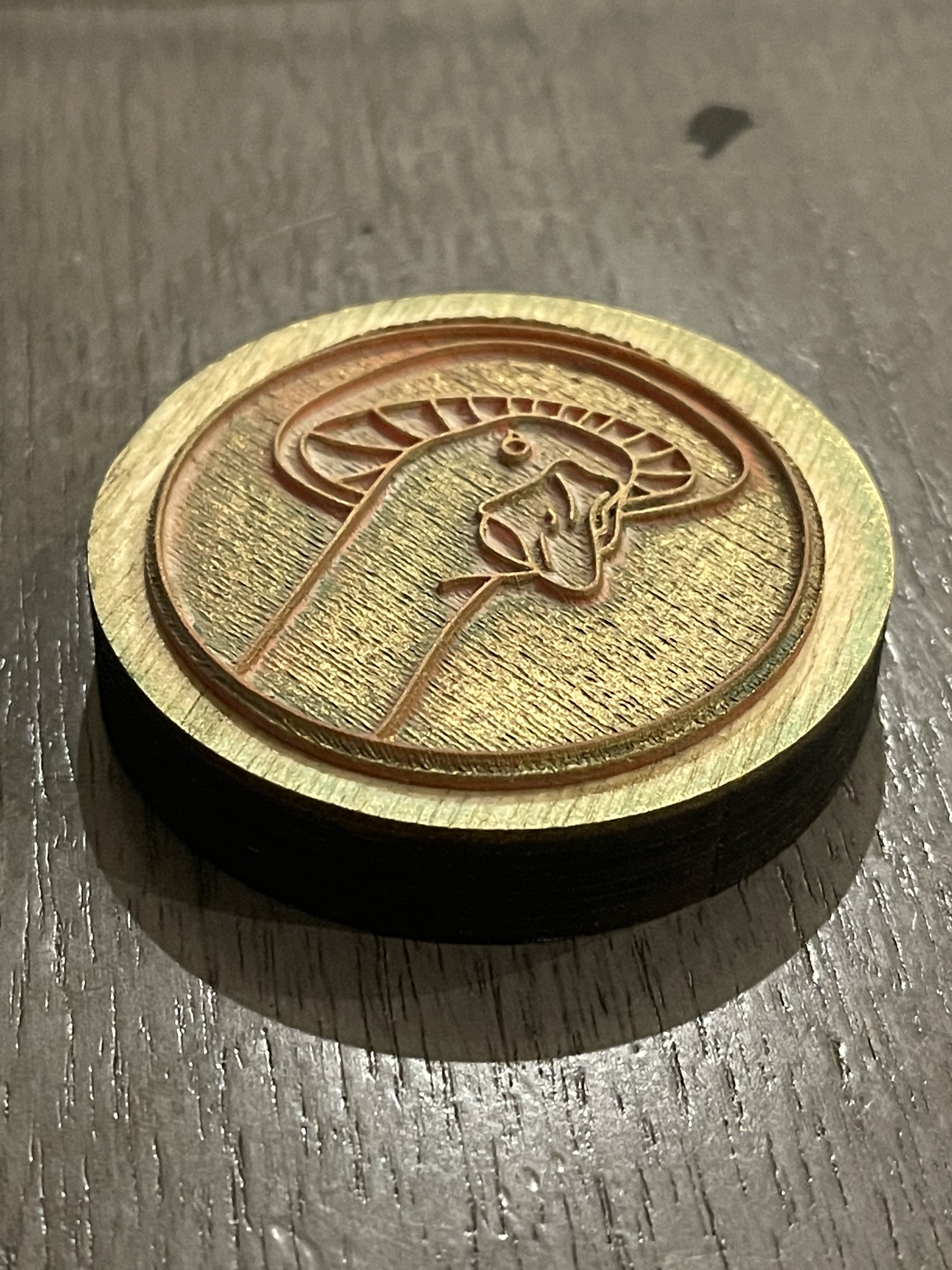

For these test samples, I made a handle by cutting out 2 plywood circles a bit bigger than the stamp, glued the stamp to one, then screwed the other to a dowel, and finally glued those two circles together. This way the screw head is buried between those layers and won’t interfere with the stamp itself
Down the line I’ll prob make some more interesting handles

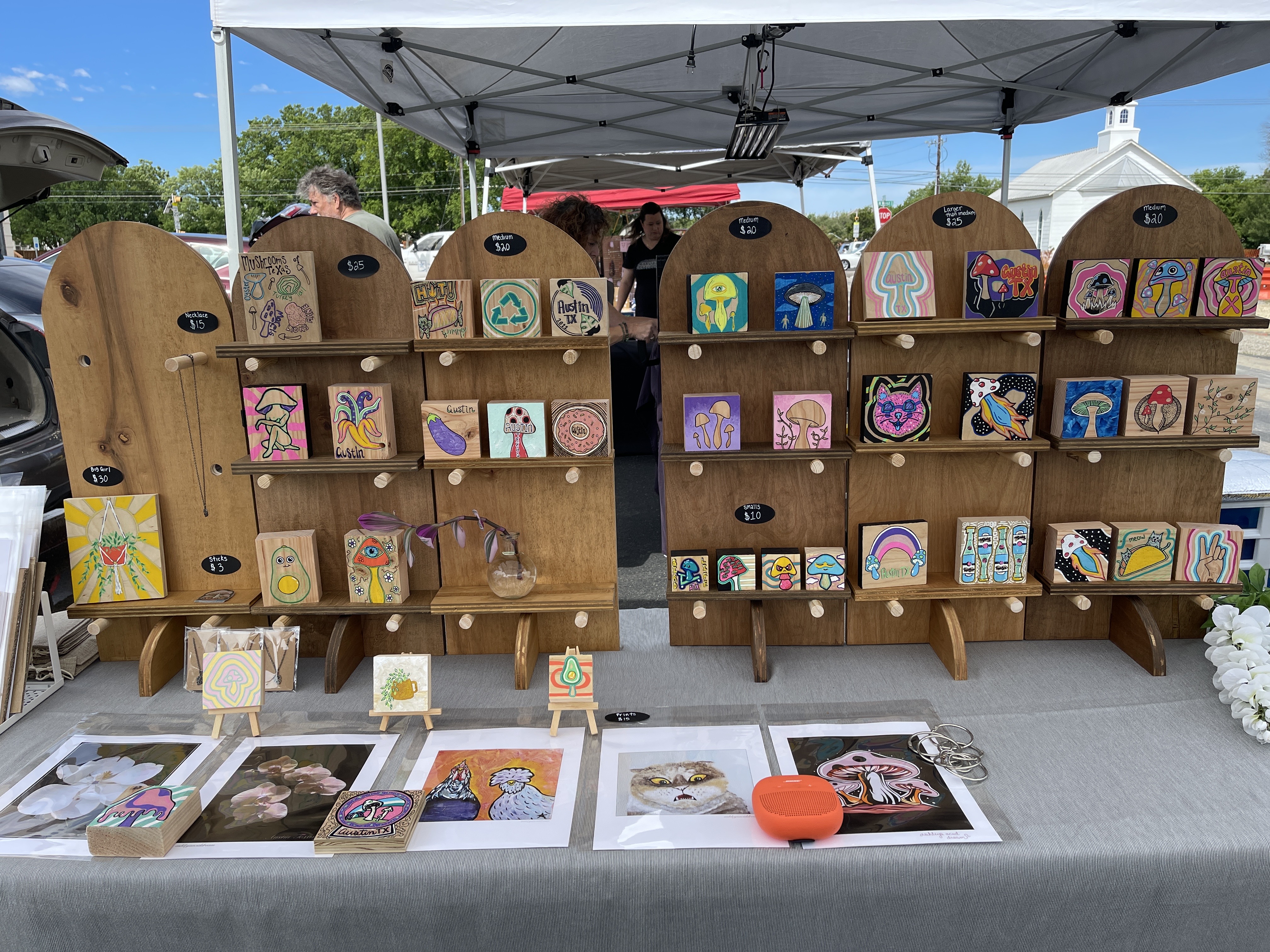

I have been milling down off cuts that my wife uses as canvases for her painting. The one time we sold at a market, a lot of people thought they were stamps, so now we might actually just make them into stamps
