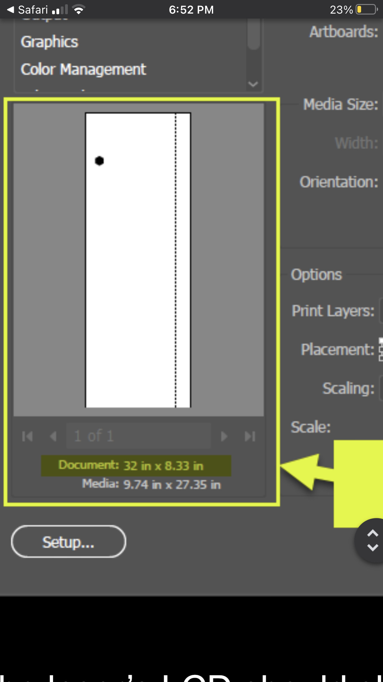

Hey all! I got the chance to spend a couple of hours with the rotary laser tonight! The manual was super helpful and I was able to get it to etch some glass with really beautiful results.
That being said, I was consistently having issues with x-axis offsets. I followed the procedure in the manual and used the red dot to identify where my art was supposed to go, but it ended up being consistently off by a few inches. The magnitude and direction of the offset seemed to vary randomly from job to job. Has anybody had any luck resolving this?

The art board in the print dialogue gets weird you have to print once then print again and switch user defined and default and the orientation a few times until you get your media size and document size to match on the bottom left corner of the print dialogue.

These should match and your artwork should show up properly (maybe rotated 90 ) in the preview.

Hey man, thanks for the advice! Sorry if I’m being obtuse, but do you mean get the media and document dimensions to match each other? If so, I cannot get either of them to change at all by messing with artboards orientations etc. Could you be a little more specific about how to make this happen?
Yes they need to match, I just got it from trial and error, screenshot what your trying next time and I’ll see if I can help more.

All, thanks so much for the help. I figured out a flow that stopped the random x offsets! My secret sauce is picking the lowest center square in the “placement” option of the print dialog when printing. It seems pretty robust, although I cannot for the life of me explain it. I hope this is helpful, and lmk if you guys have any extra insight!
