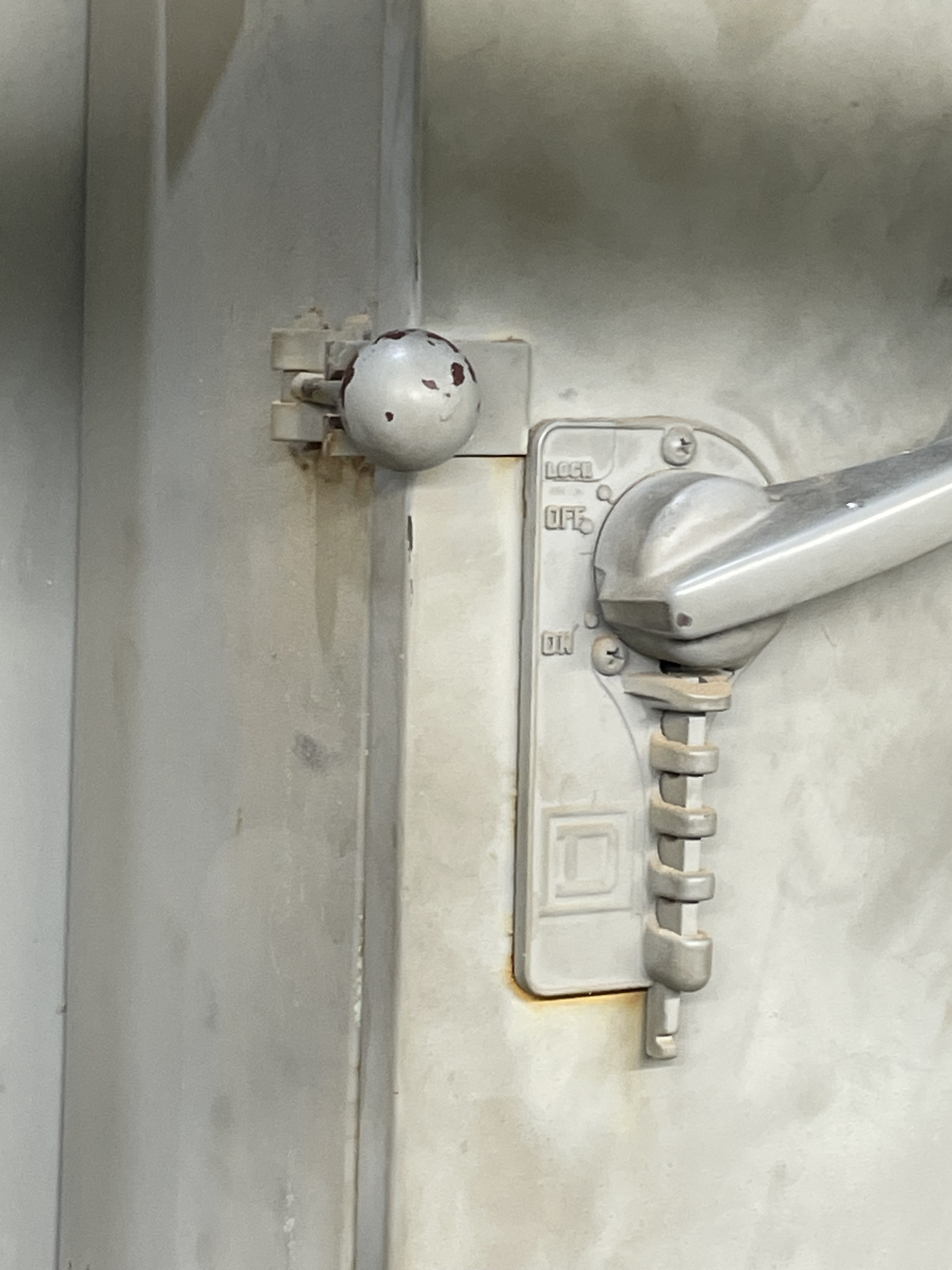

Tried to use it today, powered it up, work light came on. Pressed start, got the relay thunk, lost all power including work light. Blade never moved. Tried again, same. Tried again, couldn’t even get the work light to come on. Checked the breakers, looked fine.
How odd. It was definitely working fine yesterday. I will come look at it when I can.
It’s working fine now. It looks like someone undid the top fastener for the back electric box cover. Without it, the blades of the master switch (which we don’t touch anymore) will not stay fully engaged.
