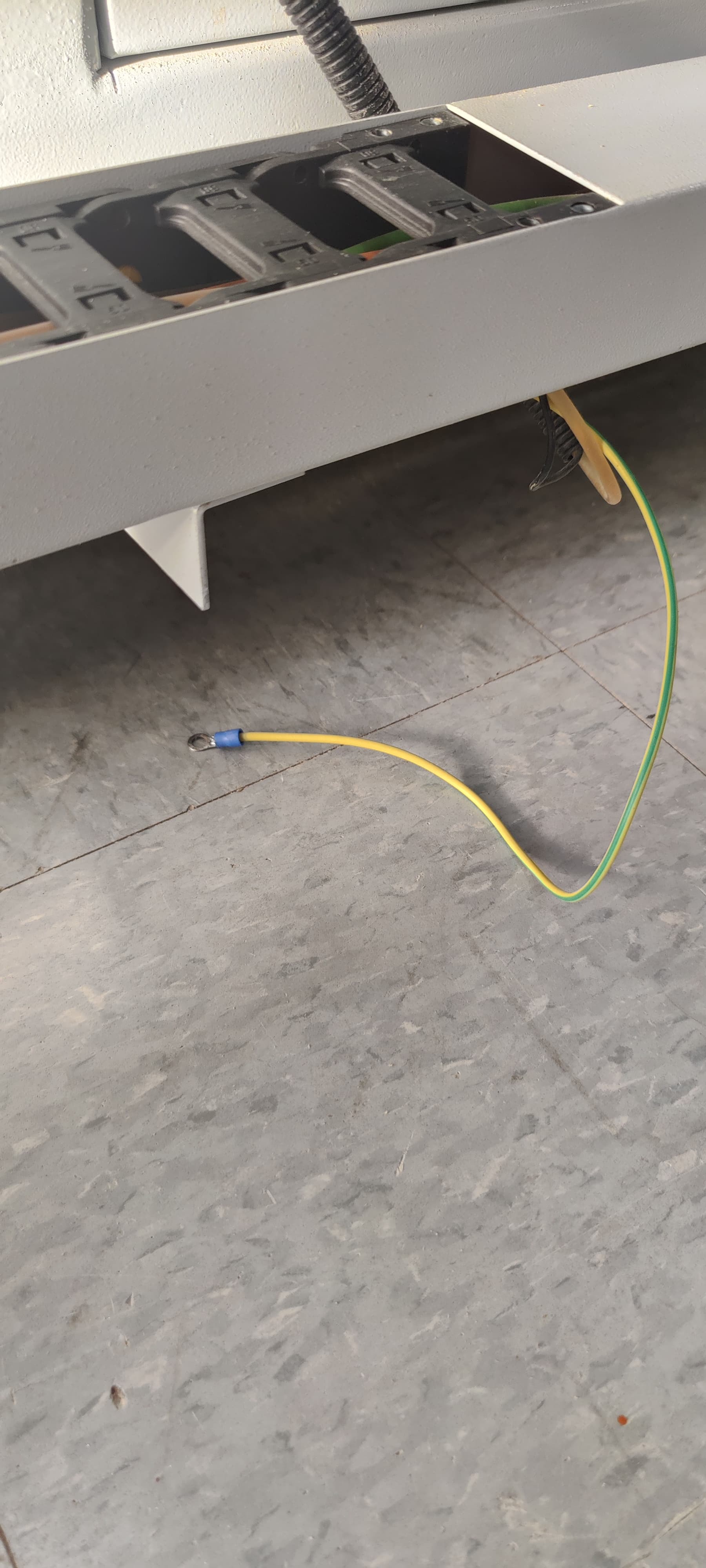

By the way when I was cleaning up, I noticed there’s a ground wire hanging down under the cable tray on the south side of the table that’s disconnected. Not sure if it’s supposed to be like that.
Wow, please be very very careful. A few other thoughts. Slow the bit/mill down to 1200 RPM by setting the Frequency to 20. Use an up-cut end bit/mill to clear the hole of chips. If you use an end mill choose a smaller one than the hole you need and run it around in a circular pattern. Finally plunge in multiple increments to clear the hole instead of one big plunge. Others, please correct me if I have misspoken.
