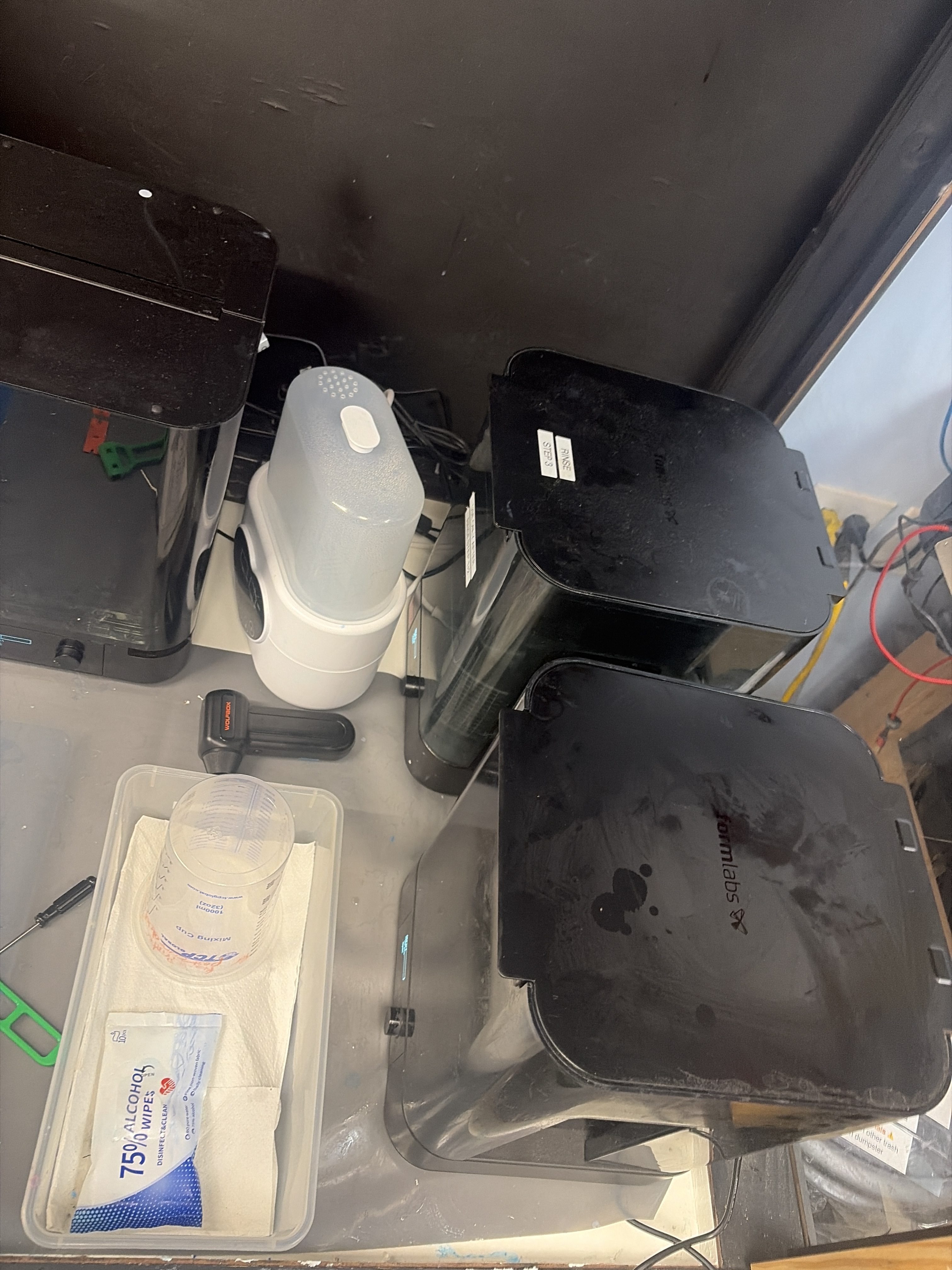

We have some new gadgets for resin printing!
Thanks to a donation, we have a second wash station. A few minutes in that should get your prints cleaner than a soak in the IPA buckets. Feel free to use the Step 3 wash station after that if you want your part extra clean, but please don’t jump straight to Step 3. We’re trying to keep that resin cleaner.
We also have a resin warmer. If you are printing with a particularly finicky resin, bringing it up to temperature in the hot water bath (the white device in the picture) may make your prints more consistent.
Finally, we have an electric air blower. Use this to dry off your rinsed prints before you put them in the cure station. IPA on the print’s surface when it is exposed to UV may cause some artifacts. If the blower is not in the enclosure, it is probably charging on the table with the 3D Scanner.
