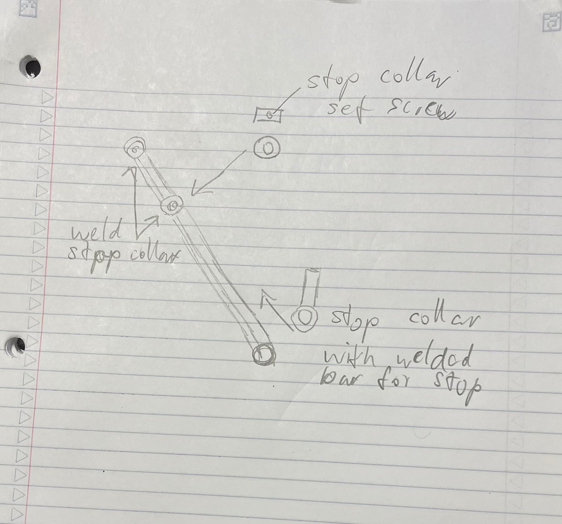

I can’t remember the shape of the stop rod. This crude sketch should work. My assumption is the original stop bar is round. The stop would definitely work on a round bar, but it can work on a square bar as well with a longer set screw.

Here is what I was thinking. It is basically the same part as the original square rod. There is a sleeve for sliding over the original rod. There are (2) 1/4-20 tapped holes for securing the new square rod. The square rod is relatively easy to machine out of 1/2" square bar. The sleeve can be machined out of 1" square stock. I don’t have a broach that size. I am thinking of drilling a hole in the sleeve and then using a file to cut the square shape. Also some welding.
