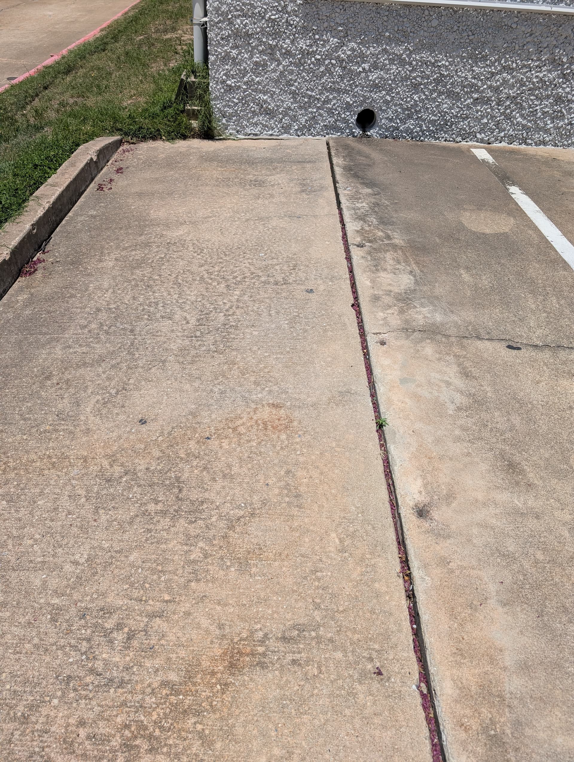

i can say this is NOT normal for Tarkin. it does not need regular realignment. there was a problem awhile back that traced to tracked down to a 3d printed #2 mirror mount that expanded too much as it was used and the mirror got hotter than expected too that’s been changed to aluminum, no issue there now.
there was only one other time in recent memory where it misaligned out of nowhere. it did occur when the weather changed and within a few days it rebounded and misaligned in the other direction, pretty much seemed to have returned back to where it was before and i was undoing the prior adjustment
i thought back to earlier times when the laser room’s temp was far from the 27C goal. hotter or colder… mostly hotter. wasn’t accompanied by alignment issues. and that includes cases where I’d expect the average temp through the entire thickness of the slab would have major temp changes too.
so, i don’t think slab temp matters. it’s the flooding saturating the ground under the slab, and then drying out again
Dorian has shown some weird alignment issues too, but it’s a smaller frame so it takes more to put the beam off the edge of a mirror
