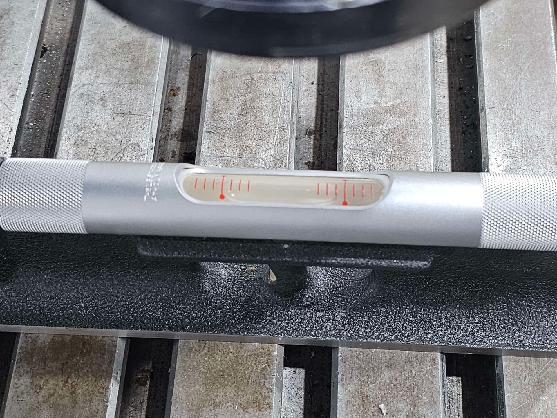

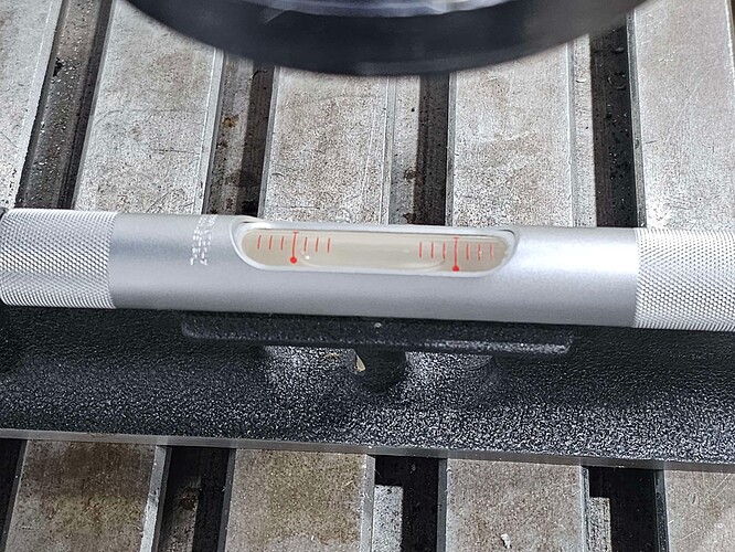

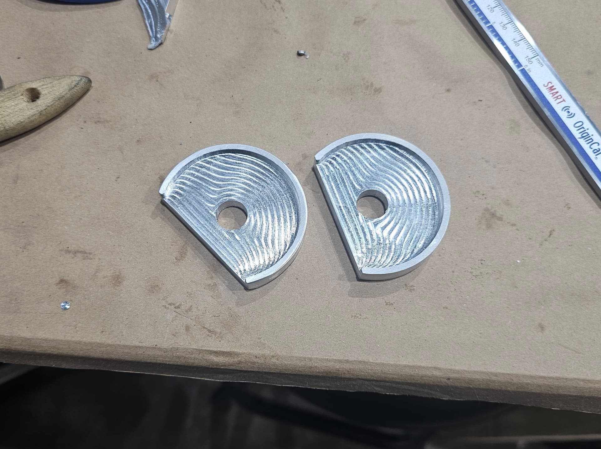

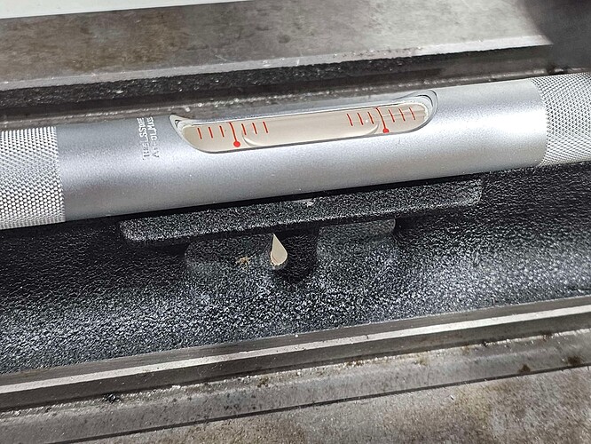

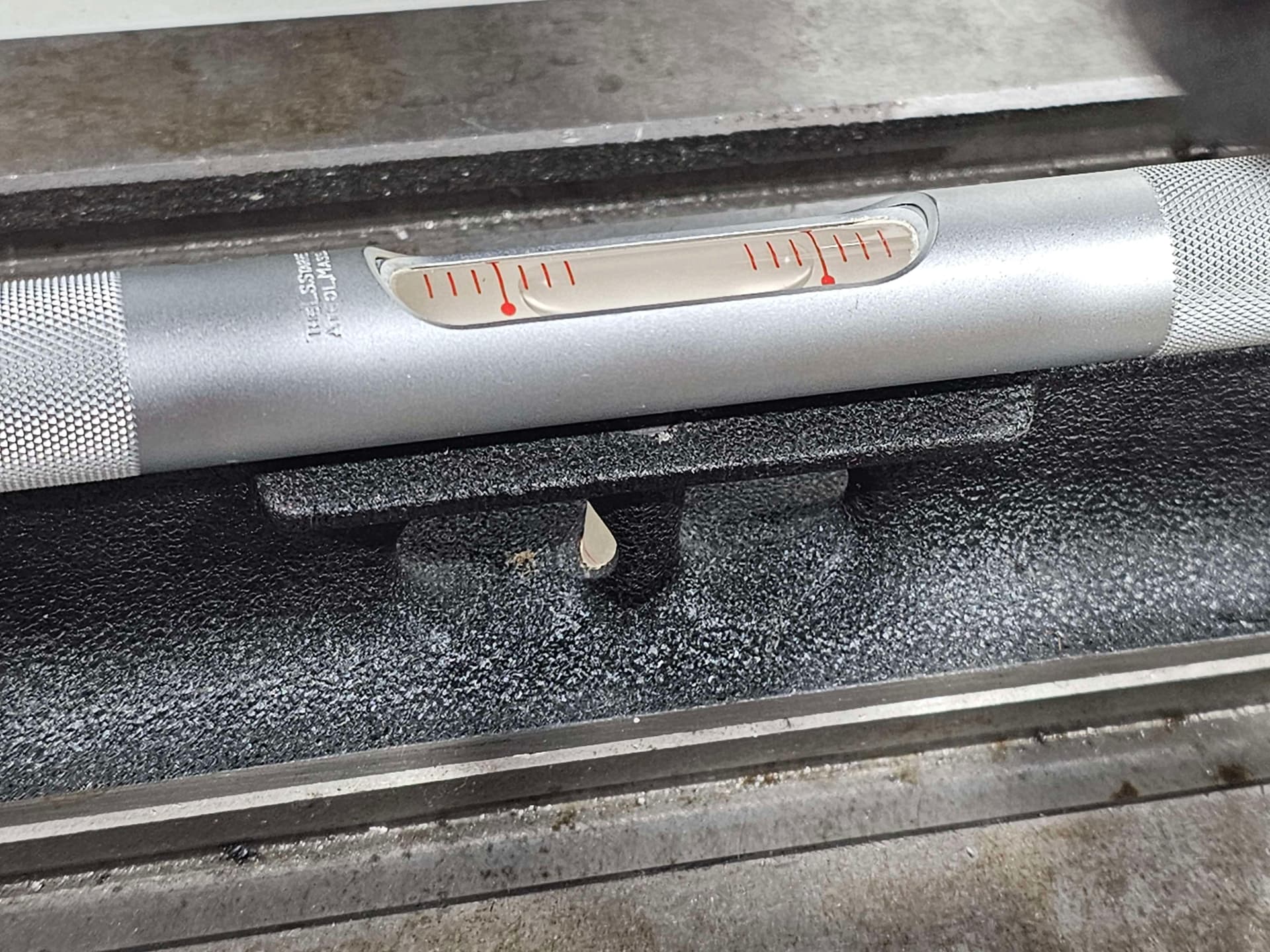

Thanks to @atwatsoniii rewiring it, the Rong Fu mill is functional again. I gave the machine a cleaning and oiling a couple days ago and finished leveling it today. Either the floor is really out of level in that spot or there’s some extremely localized space time effect making it all wobbly. In either case, the solution was some aluminum boosters for the leveling feet.
